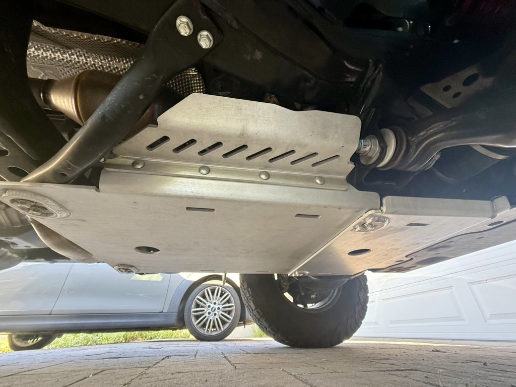

    My Rival skids have quite a few vent holes. I don’t know if they make a difference. I guess I should check the trans temp sometime.

    There are definitely some makers that do a good job with the front, rival being one. It is the rear I would question since it basically puts a solid metal shield around the transmission. Atleast yours has some vents though!

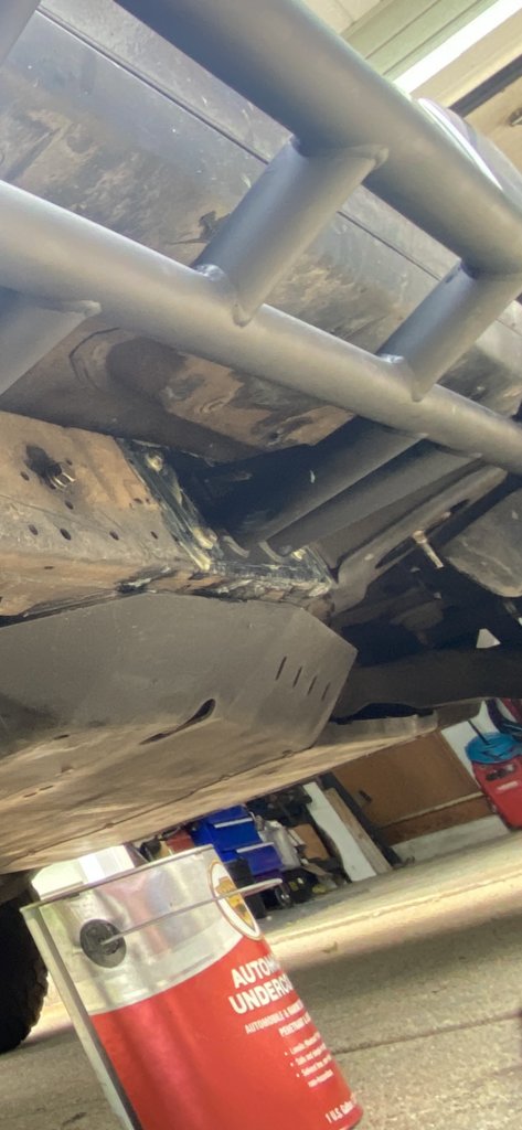

  12. Nov 12, 2022 at 11:48 AM
    5,566
    My Non KDSS RCI for comparison

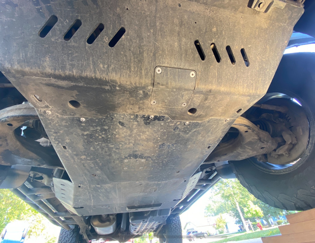

    2020 TRD OR
    Dobs IMS, lots of small stuff

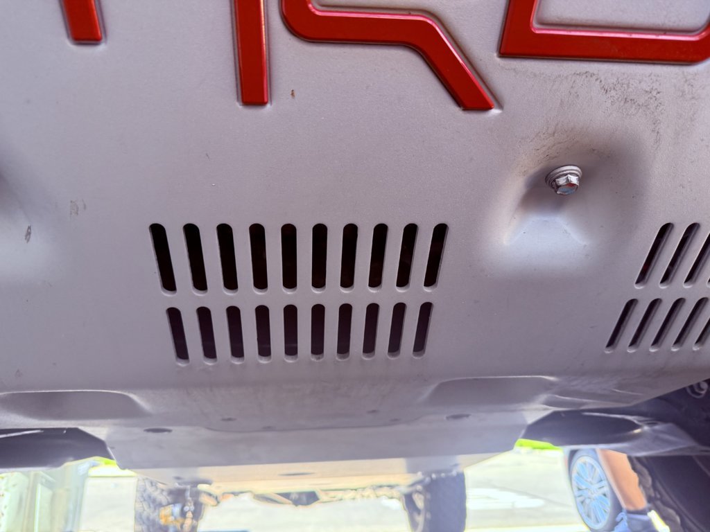

    I've wondered about ventilation on the skids. Both the TRD skid plate and the regular skid plate have vent holes in very specific places. If you look at them from the front you can see they are the in same location on both. They could have put holes anywhere, but there seems to be a reason why the engineers chose those locations. Then @kmeeg posted a pic of the limited with it's duct leading to one of those holes, which reinforced the idea that the designers wanted airflow there. Maybe not a big deal, but it makes me want to stick with one of the Toyota versions...

    I remember trying to trace out where the air goes from the stock vents. Seem to remember the air is directed to the bottom of the front diff., not sure where else.
