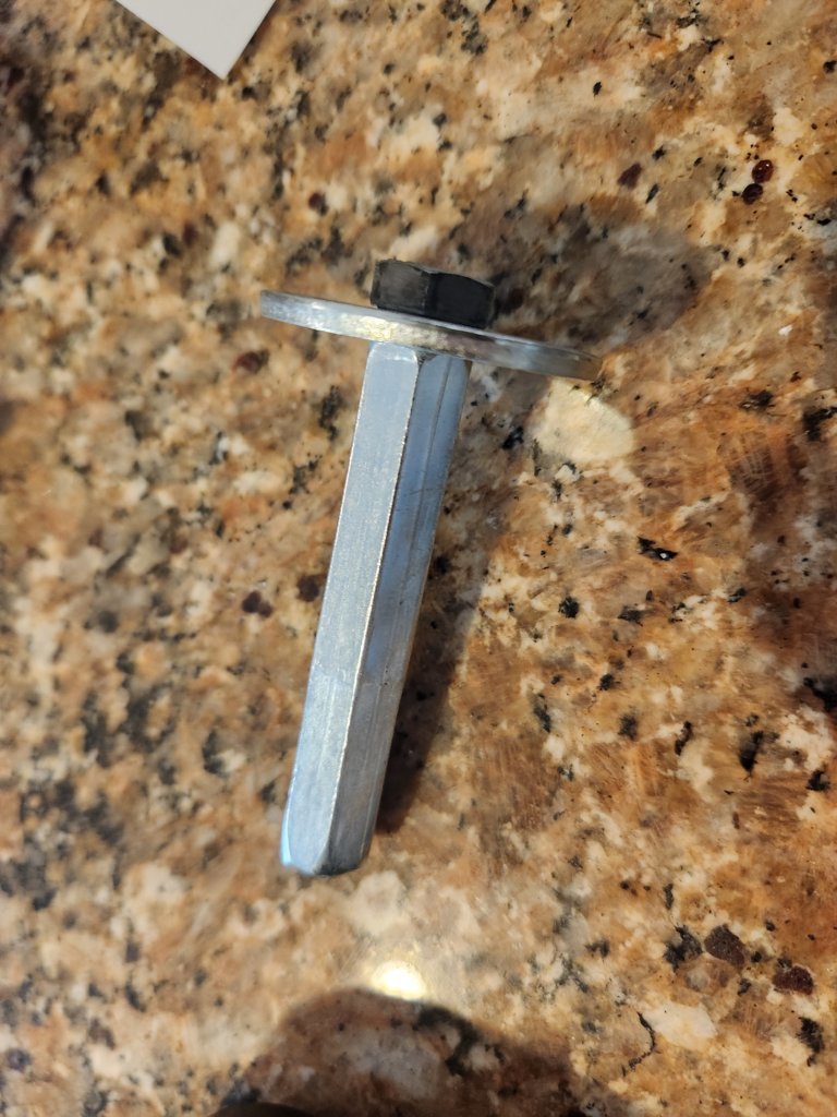

    Regarding the stick nuts...
    I too scratched my head at the design and even considered making something else, like a plate with nuts welded to it that sits on top of the frame member. However, I figured I would try them out. They worked fine.
    Agree the real test will come when it's time to remove them, which I will do in 5k miles to change the transmission fluid. My thoughts on removal are:

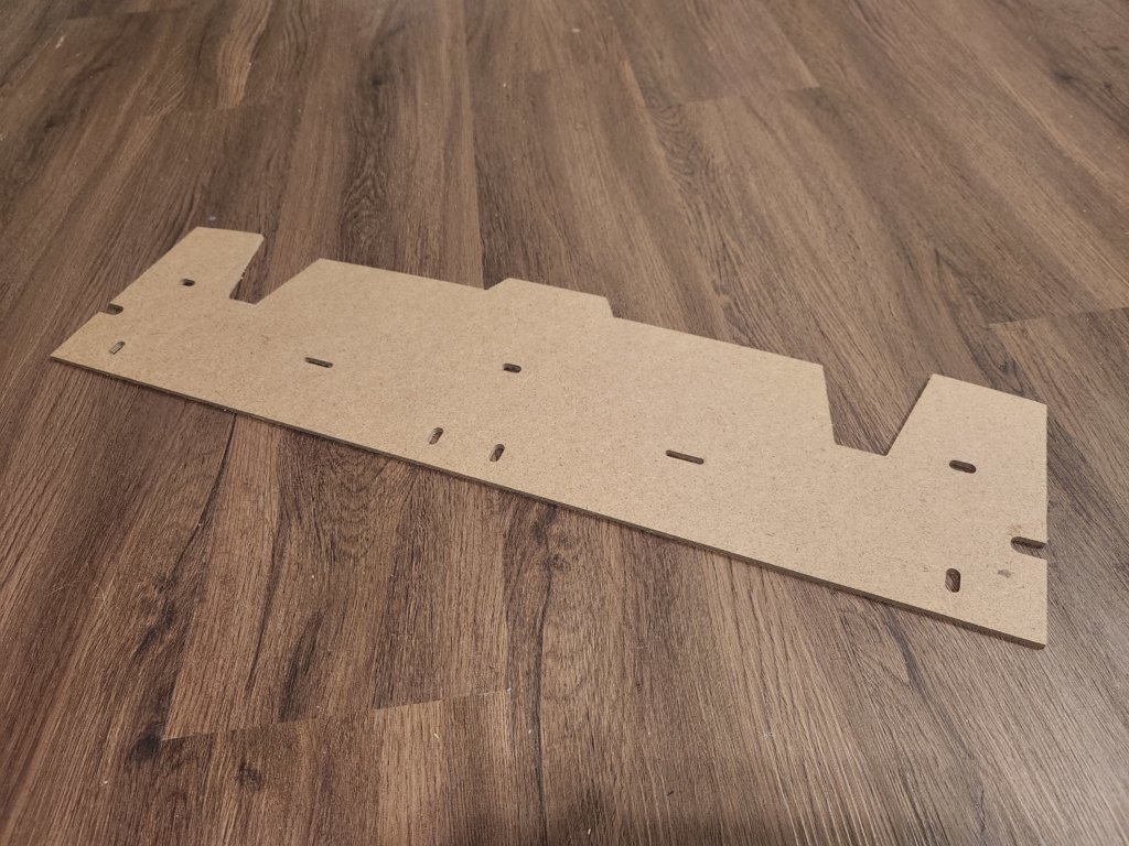

    1. Looks like it would be easier to jack up the front end from the next crossmember back from the one that the stock skid has the center lift point. This is still in front of the jack stand locations ( its the one the rear LCA mount is) and looks pretty robust so I'm thinking it's okay the jack from the center of it. Only challenge is that there is a little gap between the center of the transmission skid and the crossmember. Going to remove it this week and take some measurements to fab up a filler plate. Need to make sure the holes are still exposed in the crossmember as I believe these are for water / Mud to drain from.
    2. Regarding a filler plate, I cut this on my cnc. Made one of out acrylic but it wouldn't bend like I wanted it to so I'll be making one from Aluminum when I get a chance. Uses the stock bolts locations.

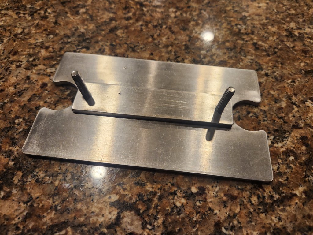

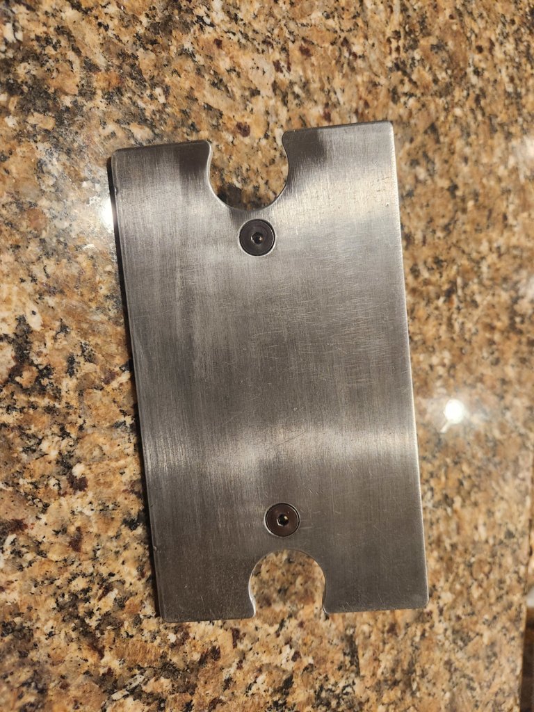

    Following up regarding jacking the vehicle from the center of the crossmember that the rear lca mounts are.
    Here is the filler piece that I made that will take up the gap between the skid and the crossmember. The large piece goes on the bottom of the crossmember and the small piece will go inside the crossmember. Will test fit in the morning and if all is well, I will paint and install once that dries. Parts made from 5052 aluminum and stainless bolts.

    The jack plate is painted and installed. Will try it out tomorrow and let everyone know how it works. Should be fine as I have almost 1/2" of 5052 Aluminum (skid + plate) stacked directly below the crossmember.
    I will note that the sticknuts for the front 2 bolts of the transmission skid did not survive the removal. Looks like they are single use only. Thought through multiple options to replace and came up with this. It's an M8 bolt and washer that goes thru the skid and frame, then 1-1/4 thick washer sits inside the crossmember. The m8 coupling nut is essentially a long 66mm nut that i can grab with a wrench from above the crossmember. Worked out great.

    Tested out lifting the vehicle from the center on the plate that I made that installed between the skid and frame crossmember that the rear lca mounts are attached to (see post #50 above) Worked really well.
    Now I think the Rival skids are perfect!!!

    If you want, I can post dimensions. It's relatively easy to make. I used 3/16" thick 5052 Aluminum for the plate and bracket. On the bracket, I tapped the threads for the flat head bolts. On the plate, the countersink is either 90 degrees if using metric bolts or 82 degrees if using SAE bolts. I used SAE as I already had the taps and counterbore bit.
    I have not had any issues with the screws on the cover plate but I am using a fresh 4mm hex socket and only torquing them to ~4-5 ft lbs. Star is definitely a better choice but just keep the torque low. They don't need much.
