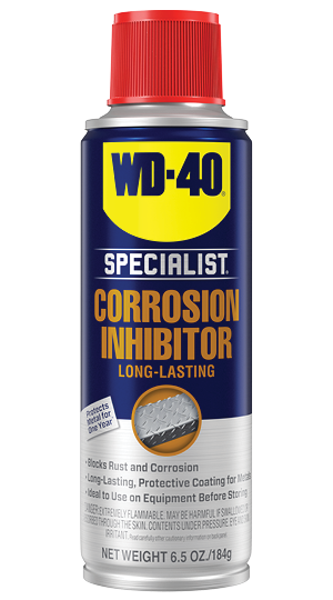

    WD-40 has a product that I used on my 1979 VW bus in an area below the engine that was a tubular framing. I sprayed
    the WD-40 product specific to prevent rust liberally into the channel and often. For the life of me, can't remember the name right now. Shouldn't be too hard to find. Not everyday run of the mill WD-40
    ChuckS[QUOTED][OP] likes this.
  14. Apr 14, 2025 at 3:05 PM
    AuSeeker
    AuSeeker Old As Dirt
    Aug 4, 2018
    #6604
    13,911
    Skip
    South Carolina
    2004 Limited
    Would this be it?
    "WD-40 Specialist® Corrosion Inhibitor"
    https://www.wd40.com/products/corrosion-inhibitor/
  15. Apr 14, 2025 at 9:16 PM
    NeverTooLate71
    NeverTooLate71 New Member
    #41063
    600
    Bob
    2024 4Runner SR5
    That's the stuff!
    ChuckS[OP] and AuSeeker like this.
