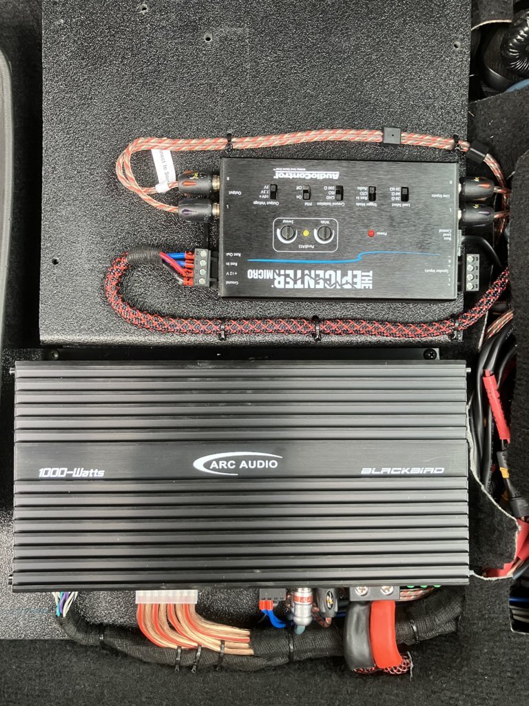

    I am running an Arc Audio Nighthawk PS8-50 amp. So ~50 watts to the dash plus a tweeter resting above it (for now, i have pods i need to install) and I have the doors bridged, which I think is around ~125 watts.
    https://www.arcaudio.com/dsp-amplifiers/nighthawk-amplifier
    I'm going to upgrade to a Blackbird amp sometime down the road. I think it's about 50% more power, but the same size amp.
