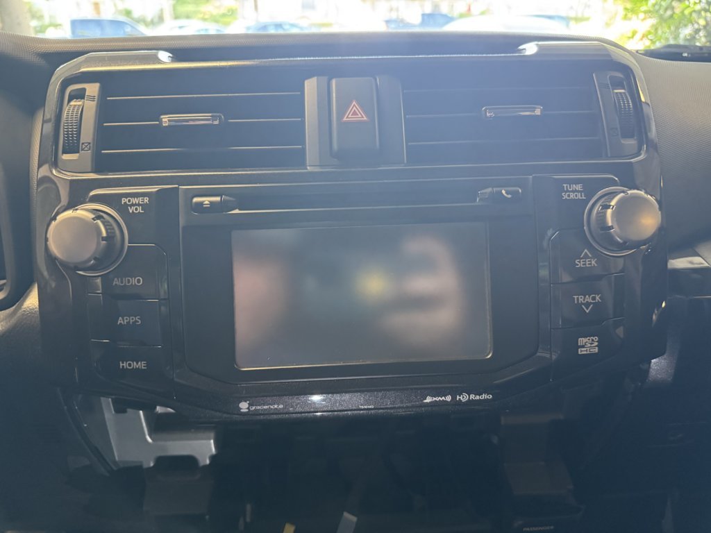

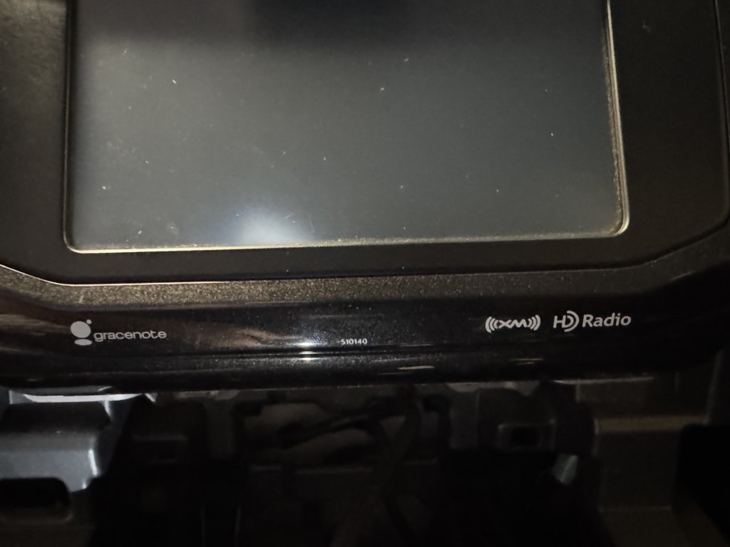

    I have a 2017 TRD PRO and wanted to upgrade to the OEM that has CarPlay but also would love to have gps on its own. is the retrofitting from a new model and purchasing the harness the solution here?
    attached are the pictures of what I have as the radio has a number of 510140 in the middle. What is the best HU for me to purchase and if it would require a wire harness to upgrade?
    thank you in advance for your help

    That's a non JBL unit. So you in luck.
    Get a 2020+ head unit with built in navigation. A $20 GPS receiver , a harness and you are all set if you want the OEM look.
    Pick the speakers of your choice also. Infinity, JBl, Kenwood etc.

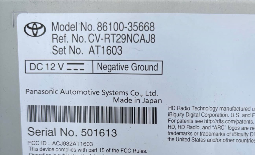

    When I search it looks like it is a JBL unit but I did find a HU from a 2024 TRD Pro that I can pick up for the upgrade of suitable with model number 86100-35668
    is this a good one to swap with and will it require a harness and if so which one? Thank you again for your quick feedback

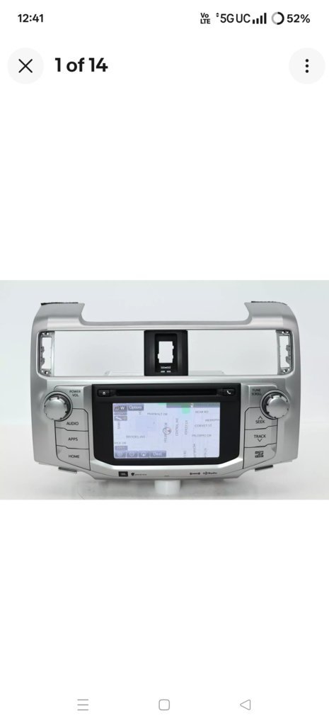

    If it was a JBL unit, it would have JBL branding on the faceplate. Look pic for reference.
    If you already have navigation, so you already have the antenna. The head unit you get needs to have the navigation module with it. The harness will make the navigation work on your new head unit provided the new unit comes with the navigation module at the bottom.
