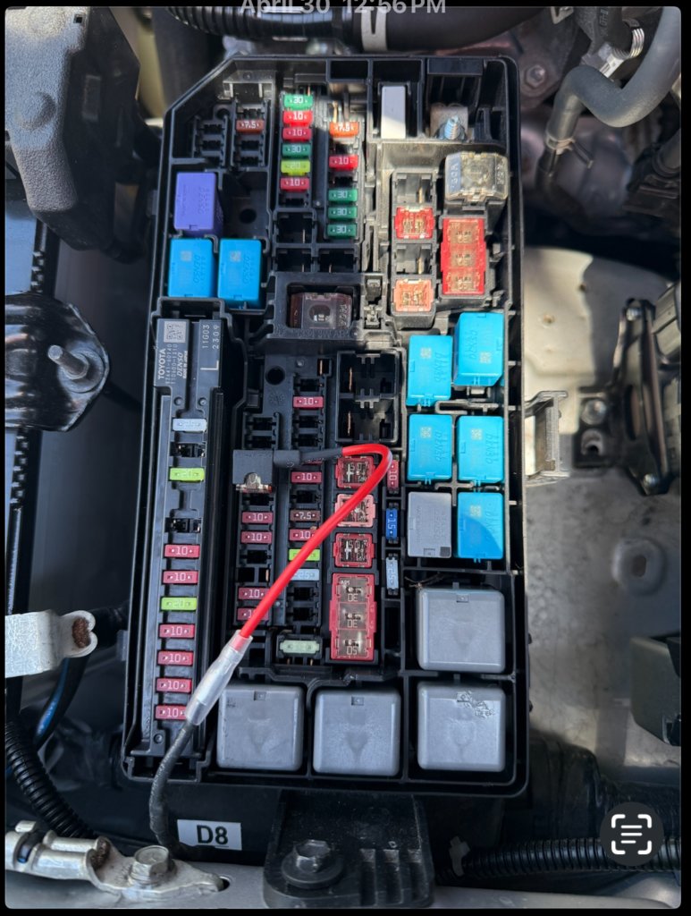

    Will try but where do you connect the ground on the under hood fuse box? I want the raptors to be on with auto headlights at night. I assume with dRL off they will be off with your setting???

    Are you sure your ORP has auto headlights? Mine does not so I cant answer that.

    Where does the ground wire connected in this set-up?

    Take a look at the fuse box, there’s a lug connected to the fender and battery right outside of it.

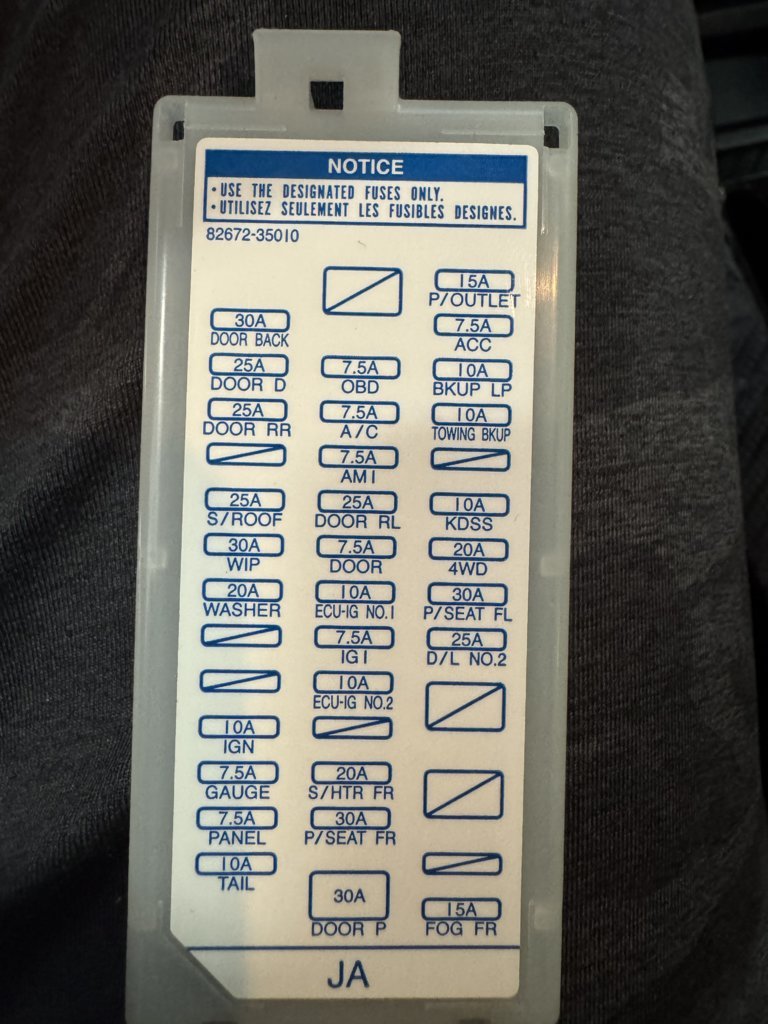

  7. Jun 12, 2025 at 7:00 AM
    sympley76
    sympley76 New Member
    Sep 22, 2022
    #28774
    338
    2021 4Runner Limited
    I will be installing mine when I find some time. Looking at that cover there is FOG FR, is that fuse for the front fog lights? Would connecting the Raptor lights to FOG lights work?
