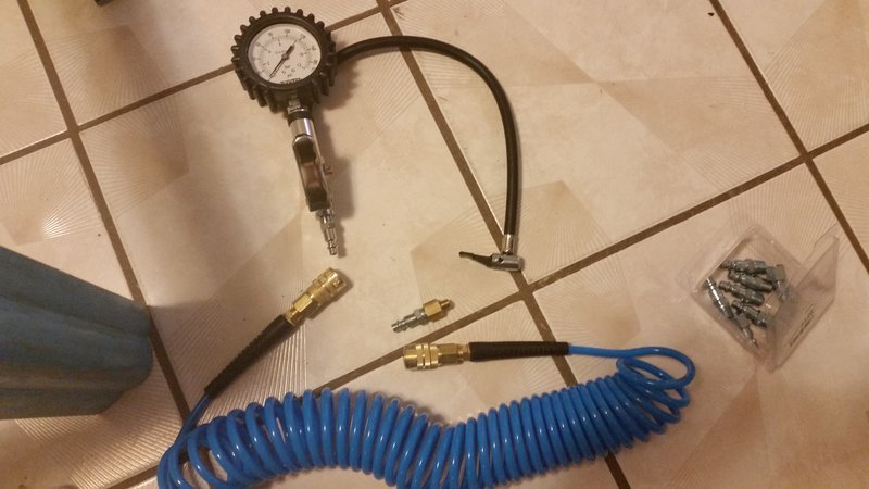

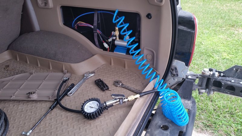

    Ramon
    picked up some accessories for finishing a simple OBA
