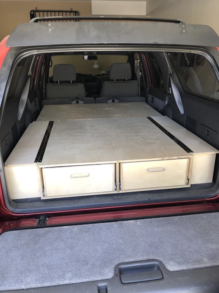

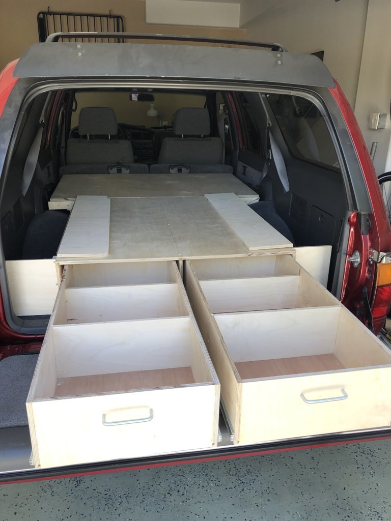

    You gain a good amount of potential storage underneath the platform. In my experience, it's well worth the effort.
    There are (2) 14mm bolts on the hinge that holds each seat-back in the middle. Then, there's a bolt in the rear of the seat back that attaches to the hinges on the sides toward the wheel well. And, another bolt will free the hinges from the body. I usually reattach the hinges to the seat backs to keep everything together.
    I forget which ones are 12 and which are 14, but they can be removed in a few minutes with just a ratchet and a 12 & 14 mm socket. The passenger/center seat back is fairly heavy, but not too bad.
    It usually takes me about 20-30 minutes to remove the seats completely and slide the platform into place. I do not remove the seat belts.
    Some pictures to show how I used the added space for storage. Keep in mind, though, that my platform is about 8-9" tall in the cargo area, so I have a little more storage than some setups.

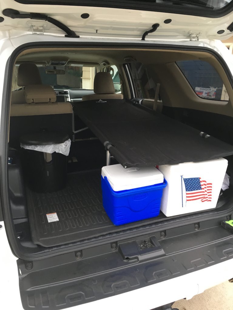

    This is my setup (although I carpeted the platform and used 1/2" instead of 3/4" plywood. I have also slept in back on a Luno inflatable without using the platform, which worked well enough. One nice thing about the Luno mattress is that you can use it full width or half width. The latter is nice when you don't want to move everything outside or up top.
    MeefZah[QUOTED] likes this.
