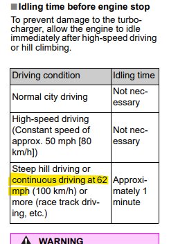

    It's a good rule of thumb to let turbos in general heat up and cool down. Newer ones , it isn't needed as much, but the older turbo engines didn't have the immediate oil and cooling sending that the newer oil pumps do these days. Since a turbo generates astronomical amounts of heat, it's good to let the oil and coolant run through it after running it hard, instead of just shutting it off immediately after and risk the heat seizing up the bearing, etc. But again, this is after really hard use and mainly on older vehicles, just doesn't hurt to do it on newer ones.

    Per owners manual;
    My wife would kill the turbo since the most convenient road between her work and my little one's day care is 75mph. :p:D

    funny the manual would include "race track driving". LOL

    Boy, those crazy track condition driving at over 62mph.
    It's interesting, one would think constant cruising at freeway speeds is usually associated with light load on the vehicle, after all we are all told how the turbo motors make effortless and abundant torque at low rpms. yet city driving doesn't require a cool down per the manual. Somewhat counter intuitive, I would say.
