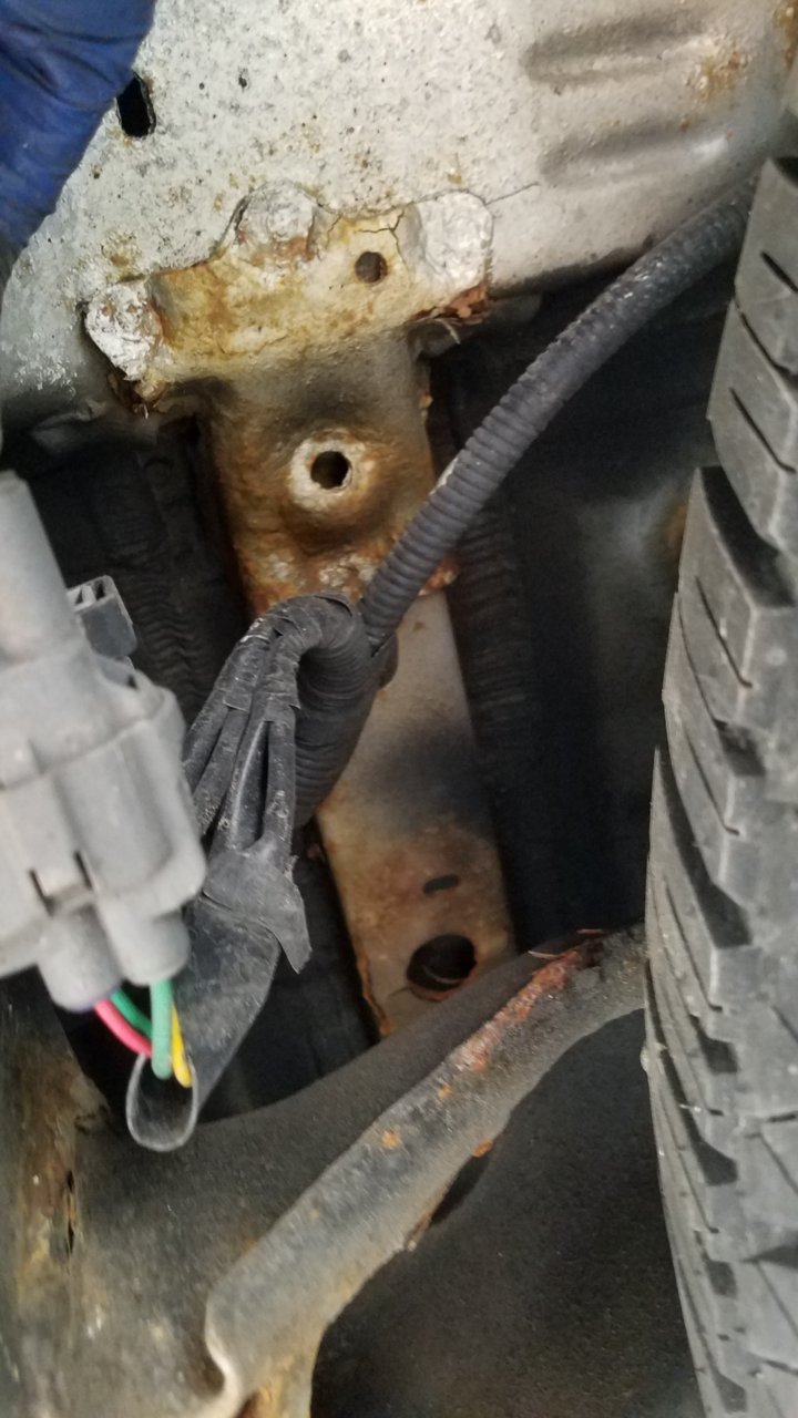

    Ya rly. If he fluid films starting now he's going to have a 4Runner that's going to last a long, long time. I think there's one crossmember that's a kind of questionable, but whatever.

    The one in the rear? Yeah, I really should pull the spare and address that.
    And this has seen an application of FF, btw, I had it sprayed at a shop in late 2019.

    This is the one I was talking about that looks questionable. It probably wouldn't be bad to get some additional opinions on it. I wouldn't be surprised if it wouldn't be a humongous deal. I think it's a crossmember? I'm not 100% sure from looking at the pic.

    Yeah, that's one of the ones that worries me. That's actually the underside of the body.

    Tap that with a ball peen hammer a few times and you'll see what's left. Not much by the time you reach solid metal. You need to deal with this area a.s.a.p. Yah it's a crossmember to frame joint but it's more rotten than you think as shown by this pic. The pic also shows major rot towards the center of the crossmember. Question is how much do you love or want to keep this 4runner. The damage has been done. Personally I wish my municipality would stop over salting our roadways to compensate for the few idiots that won't drive according to conditions in winter.

    Well, if it's as bad as you say, Carvana or Vroom it is. I'll have to get under there this weekend and check it out.

    I got under there the other day and tapped everything with a hammer, everything seems solid. Just a little crusty looking.
