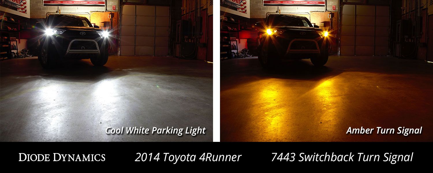

    I'll confirm, but yeah, they come on as running lights, I use the term 'parking lights' just because its embedded in my vocabulary, but I'm sure they are on when the engine is running. They are amber from the factory so not identified as DRLs but with the DD upgrade they look like they will be suitable. The video is super quick and shows them in a well lit garage.
    https://www.diodedynamics.com/front-turn-signal-leds-for-2014-2023-toyota-4runner-pair.html
    https://youtu.be/xokDBO_fMCk
    I totally understand your concern though, and you have explicitly said that you dont want to supply a product that defeats a safety feature. Thanks for looking out for us!
    I'm away from home right now but when I get back (few days) I will update with how the side markers operate in different scenarios. You've got me curious now.

    @Mr Marshall Parking lights (often called running lights) and DRL (aka daytime running lights) are independent signals. As far as I'm aware, you have no DRL signal feeding your turn bulbs, just parking light (dim) and turn (bright but flashy) and then ground via that triangle connector.
    Doing a switchback as per the above video just changes parking lights from amber to white, it won't change any behavior, it's not at all a "solution" for anything, it's pure aesthetics of the color of your parking lights (not daytime running lights).
    I assumed you were talking about their HDRL stuff, whereby you can feed 4 signals in to the one bulb, turn, parking lights (still amber but dim) and drl (white, full power). I have two sets of that setup, it's 4 wires, presumably you'd send a clean DRL signal, parking light, turn and ground through. They typically have bulb adapters too for mostly plug and play. Getting the clean DRL signal is the kinda tricky part.
    Anyway, lots of talk about details here, probably getting a bit too mind numbing so I'll pipe down.

    Ok, I follow ya. Those are cool, I'm gonna check them out. The other, basic ones that just replace the turn signal, not a daytime running light, just a running light, I know that they don't have the same control philosophy as the DRL, but they are functionally similar. I'm going to confirm when I get back to my vehicle but I'm pretty sure the difference is that they don't turn off when the other main beams come on. Anyways, I don't intend on doing something that defeats a safety feature. Maybe the Triton HDRL is a better option and I just need the right PWM driver to make it work.
    Not at all! Thanks for answering my questions Dave.
