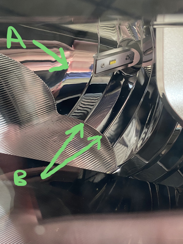

    @mynameistory,
    I installed the bi-LED headlights in my 2018 using a relay and switch to activate the LED high beams, similar to your setup.
    Did you notice that the halogen high beam optics are different than the original headlight? I notice they have a distinct X shaped pattern. Not sure if it’s better, only different.

    Possible they changed it because it's only used for DRL on the biLED version. I have the low beam only LED headlamps on mine. I could compare them to my all halogen headlamps to see if they're different or not.

    These are my high beam reflectors on my 2021 low beam only LED headlampsIMG_20220531_173930.jpg

    Interesting, I had not thought to compare the two reflectors and had assumed that they remained the same across all models. I still have my old housings, maybe I can try plugging one in for a side-by-side comparison. Only if the harness is long enough, I'm not interested in pulling the bumper off and swapping housings again :D

    Here’s some comparative photos I took of mine on a pizza box about one foot away. First is the new driver-side bi-LED headlight, high beam, with a 9011 halogen bulb. Second is the passenger-side old OEM halogen headlight, high beam with a 9011 bulb.

    Interesting! I do remember that my old reflector DRLs had a pattern like the one you show, where it's almost an upside down copy of the low-beam. The hotspots overlap and the pattern is above the cutoff. Now you have me wondering if the new reflectors are adequate or useful as high-beams, as it seems they have a different pattern now.

    The halogen high beams seem to light up the distance well but I noticed that they also illuminate and add to the lower foreground by overlapping the low beam pattern. I don’t remember this happening with the halogen-only headlights. It was as you described, where the hotspots overlapped and a lot more light above the cutoff into the distance. In fact there seemed to be too much high angle light to the right; highway road signs on the right would appear to be be lighted too much sometimes.
    However, the halogen plus LED high beams together are pretty impressive to me.

    @replica9000 any chance you could get a picture of your patterns against a wall or garage door etc. to confirm if your reflectors are "new" or "old"? DRL mode is probably adequate if it's dark enough and you're close to the wall.
    Strange that Toyota would go through the bother of changing the reflector optics slightly, while retaining the same basic look. Especially when it seems like people's biggest complaint is that they're still halogen.

    Good idea. Also note that in order to get those pics I blocked the low beam projector with my body so all that beam pattern was from the halogen high beam only.

    These are my high beams

    Hmmm… It seems the halogen High/LED Low versions use the same high beam reflector optics as the old Halogen High/Low models. The bi-LED halogen DRL seems to have been redesigned, maybe to optimize shining the dimmer light more downward for better visibility to oncoming drivers.
    Someone else should verify this.

    I assembled photos from you and replica and posted on TW in the headlight thread.
    I think you're correct. I do remember my old DRL patterns being as you said, and now mine look like yours. I don't know why I didn't notice the difference before.

    For what it’s worth, here are pictures of the halogen DRL/HI reflectors on my 2014 and DRL Only reflector on my 2021 PRO with Bi-LEDs. You can see the ‘14 reflector has a “bend” in the reflector at position A where the ‘21 does not. And the center surface of the reflector on the ‘14 has sharper, more defined edges than the ‘21 at position B. These are most obvious differences I noticed. It also appears perhaps the ‘14 reflector has a slightly deeper dish to it, if that makes sense, than the ‘21. Could be others.
    ‘14 reflector
    ‘21 reflector
