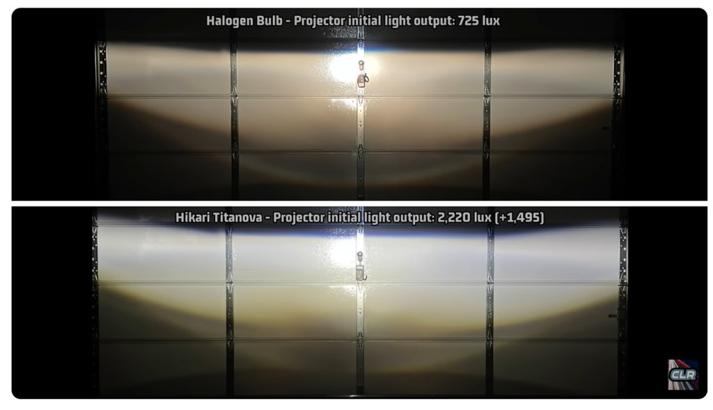

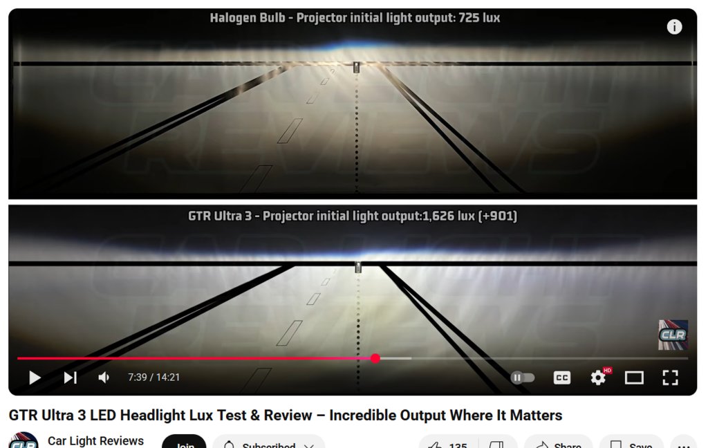

    I'm someone absolutly deny that as long as you buy a good LED bulb with good beam pattern. Here's a comparison from youtube halogen vs GTR ultra 3.
    Me personally have used older GTR ultra 2 and the beam pattern was very impressive. I can imagine GTR ultra 3 would have even more improved now. Ever since I have experience few good LEDs on my vehicles and my friends vehicles. (Since I'm the one who install them on their vehicles.). Sadly I haven't got a chance to test GTR ultra3 personally.
    I think in 2021 certain trims still used reflector as highbeam and projector as low beam LED only. My 2021 TRD Pro came with both highbeam and low beam on the projector. When I try to use the reflector as an additional highbeam I did not like the pattern much. May be, maaay be... The reflector on the bi-leds may not be ideal as a highbeam. They are only meant for DRL only. But visually they look same, So I can't 100% say if its a good idea.
    Edit -
    If you are wondering what I currently use? I'm using much cheaper Hikari Titanova on one of my 4runners that came with halogens. They where $93.49 in Feb 2023 from Amazon. In my books bulbs improve with time. From what I see the GTR Ultra3 came in 2025 have better beam pattern than what I have now.But Hikari Titanova still have crazy light power, 2220lux vs halogen only got 725lux.
    (These pics are not mine. From a Youtube channel that review headlight bulbs)
