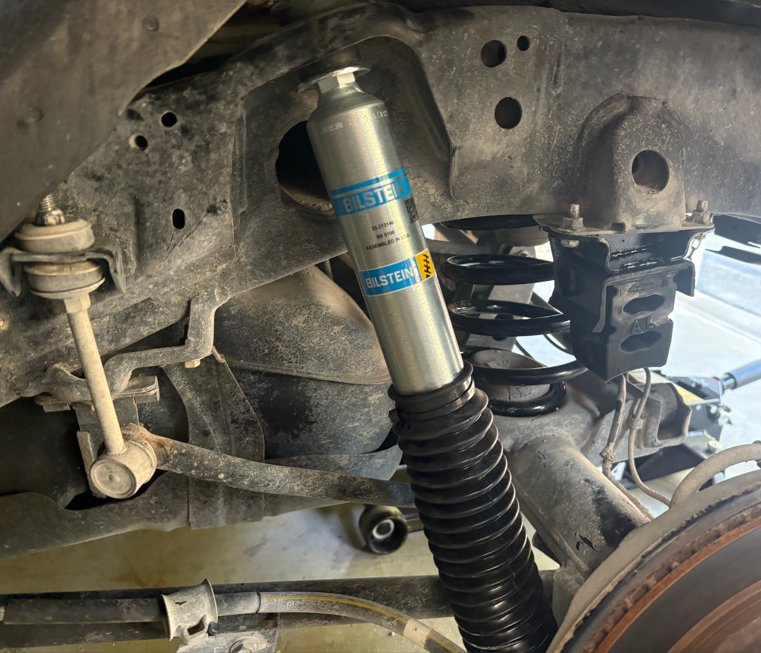

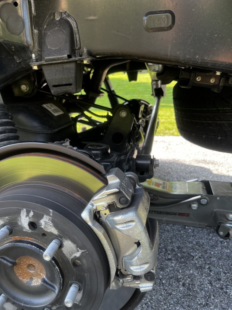

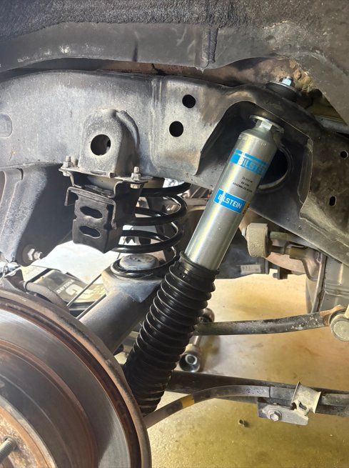

    I did my lift solo, and when doing the rear springs (T13), I got one side in just fine, but then the other side, I had to use a spring compressor. Watch a few YouTube videos. I wanna say most say to install drivers side 1st. Not totally sure, though.
  2. Sep 10, 2025 at 3:44 PM
    #62
    2,948
    I disconnected the end link and used jacks under and on top of axle to slide my rear springs in. Be carefull not to stretch the brake lines too much.
