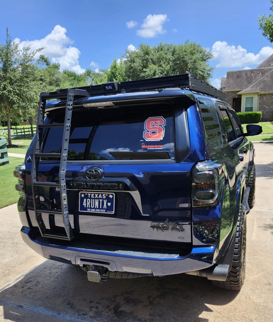

  3. Jun 6, 2025 at 3:04 PM
    ChessGuy [OP] New Member
    1,248

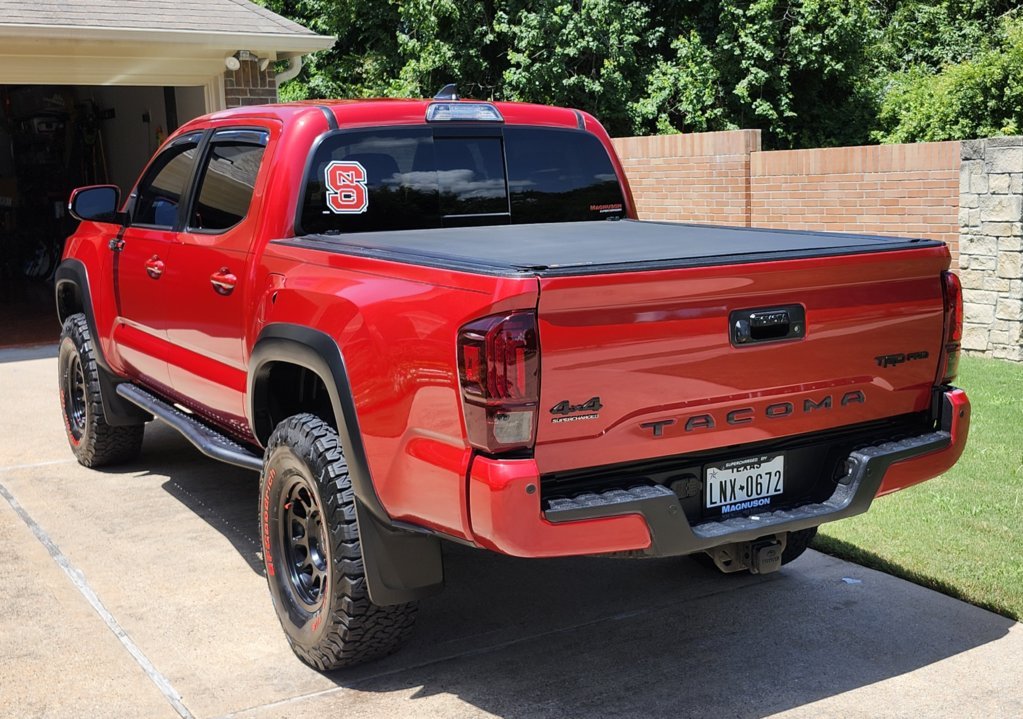

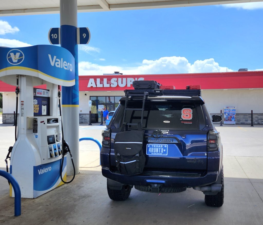

    You will like this sticker better...you'll see soon. This is the real Wolpack Red unit.

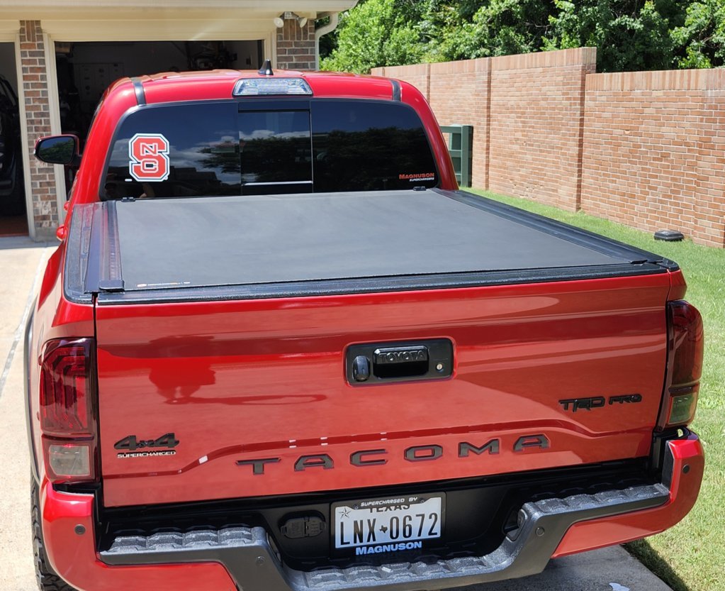

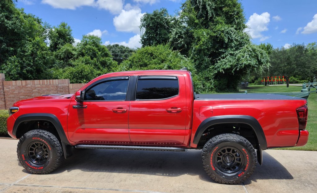

  5. Jun 6, 2025 at 3:12 PM
    1,248
    Red for you Loco....the wife's truck is Barcelona Red. This is a true mall crawler - ultimate pavement princess.
    mac1usa and TrailSpecial22 like this.
  6. Jun 6, 2025 at 3:15 PM
    1,248
    This is the real wolfpack true red unit. I just get to clean it and do the maintenance on it. It rips too as it is SC and regear as well. A hell of a unit.

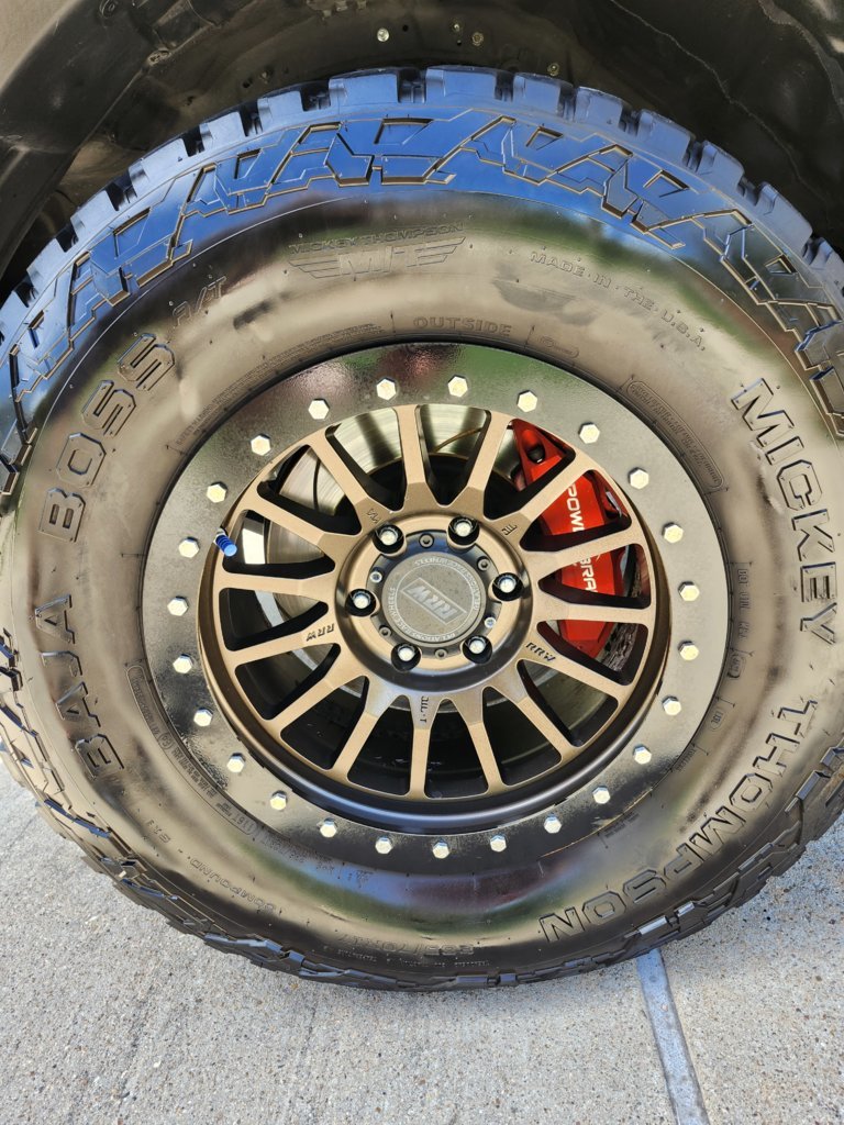

  10. Jun 6, 2025 at 3:54 PM
    1,248

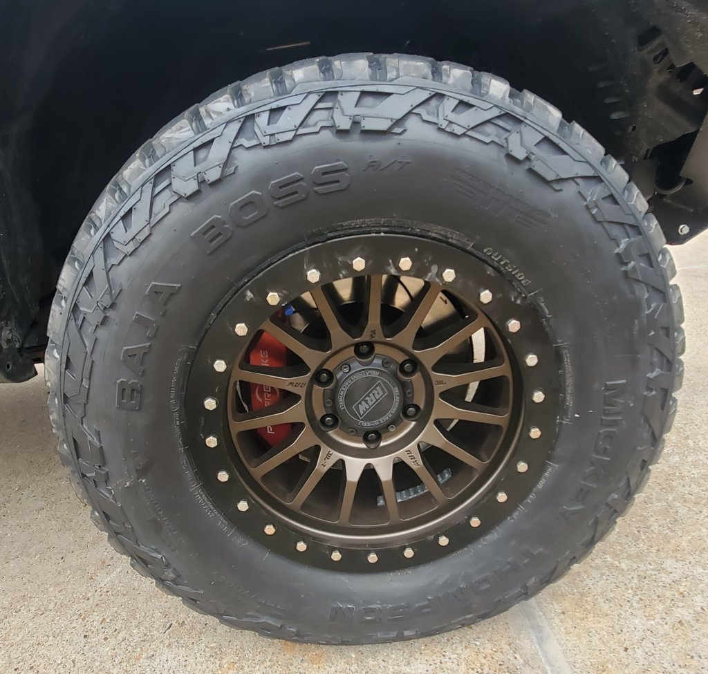

    So here is the story on those letters....I wanted to put on the general grabbers which are the only tire out there with red lettering out of the factory. general-grabber-x3.png.jpg
    The problem is that these are only available on MT (I think they are called the X3) and a $30 bucks was added per tire because of the letters which brought each to about $335 and I said $^@%! That. I ain't doing it because some red letters bull...so I bought a red marker for tires and just flipped the KO2's. I cleaned the hell out of the white letters on the K02's and went to work with the pen. I rolled into discount tire the other day and the kids were like.....dang Mr...we didn't know the K02s come in red. I said me neither!! My back hurts like hell...from flipping these tires and doing this by hand. The boss here at the house likes it though....I told her they will turn pink eventually and you will end up with a girly unit. :rofl:

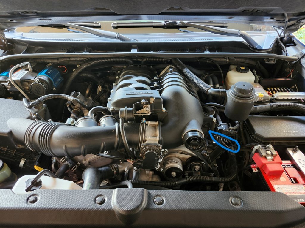

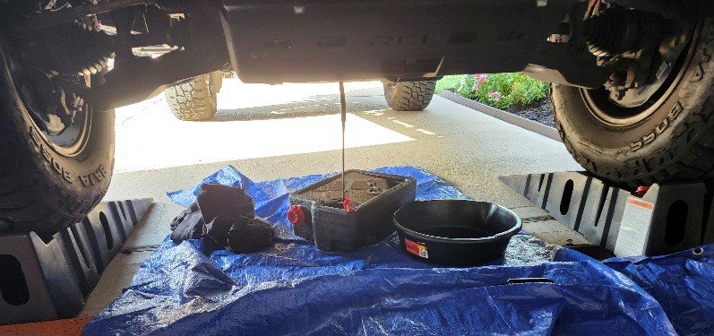

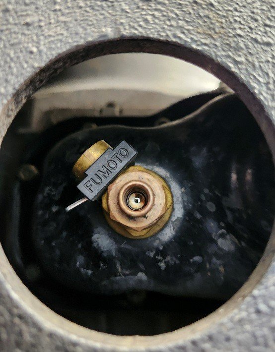

    Today was oil change day. I do it every 5K, and my goals are two: "Zero Harm & Zero Spills". I have to admit 5 yrs ago when I started doing it myself, I wasn't as neat and tidy as I'm today. It takes me now 30 mins max to do this job, first time it took me probably 2hrs :annoyed:.

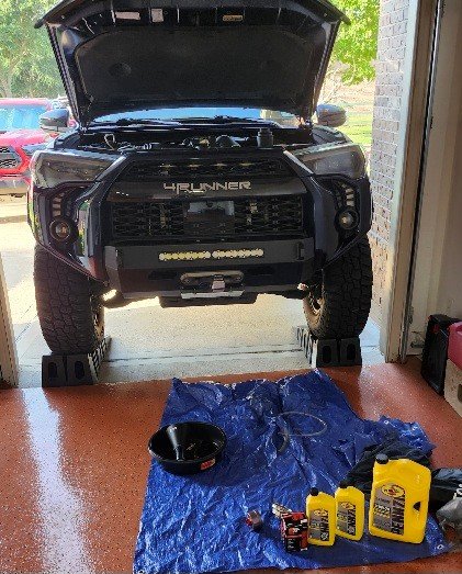

    The setup:
    I got all my stuff ready to go. No beer on the floor however as it was too early :(, got going at 730am to try and beat the Houston hot weather.

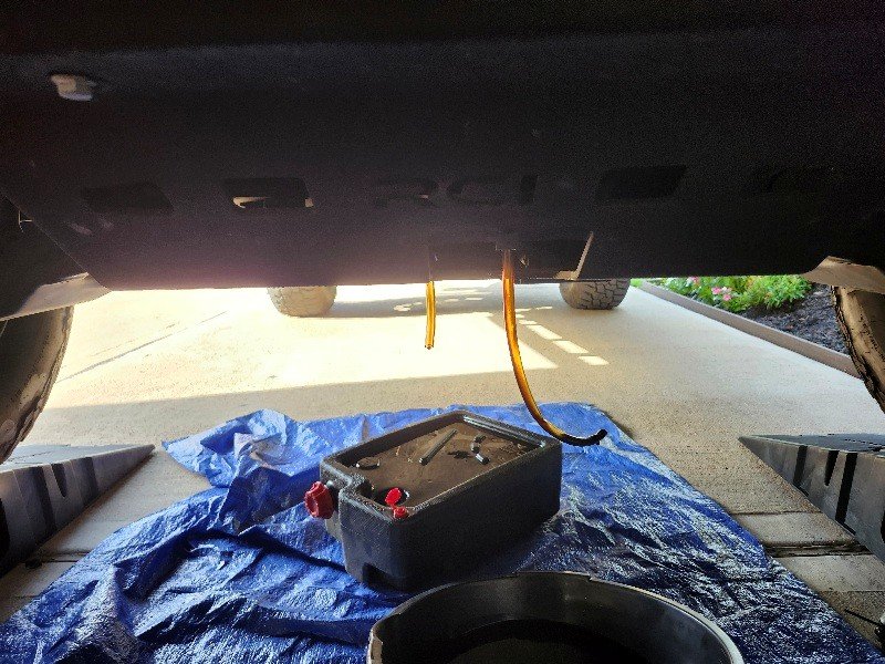

    I bought into the hose thing because I can't stand spilling stuff on the ground, so these little hoses work just right for me. I put the blue tarp on the floor just for insurance, my pulse sometimes is not the best and I'm also not a small guy so I need the insurance there.

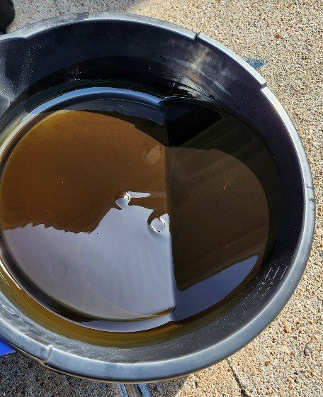

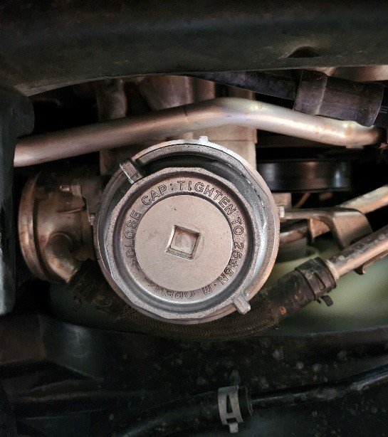

    I'm always surprise how much oil is retained in the filter housing and so I try to get everything out but you do get a decent amount on the pan. Again, the goal is zero spills on the driveway and on the 4R. Here is the quality or looks of the oil:
    Not too bad, it could probably do a few more but I'm a big believer on the 5K. I use the K&N filters, they soak pretty good...they get a little hard to pull sometimes but for the most part they do ok.
    Cleaning everything up and ready to fill in....30 mins was my time for this. I think I spent more time wiping down my hands to not mess up my cell so that I could snap these shots.
    The bay looks clean and good....

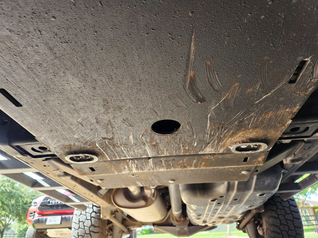

    A reminder...on the skid plates --- these continue to do their job, glad I have them in there. Crawling down to the Mall and Homedepot can be harsh at times :notsure:Little check on Skid Plate 60K.jpg

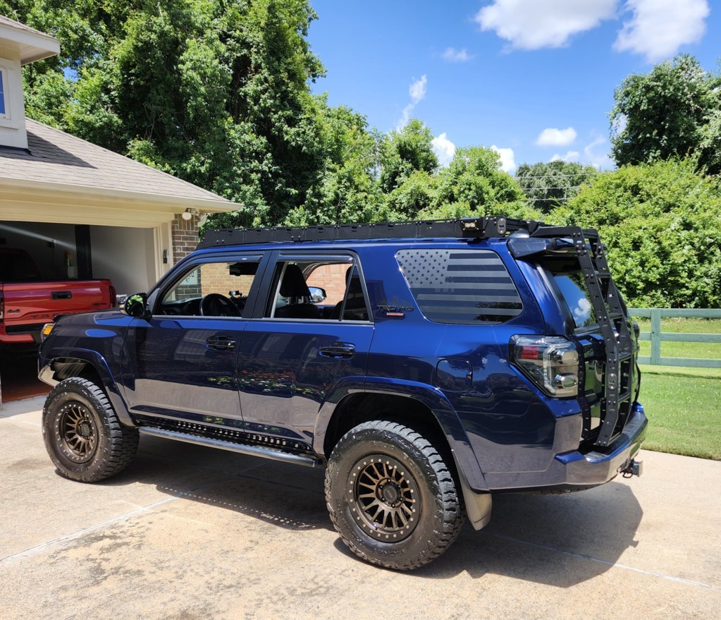

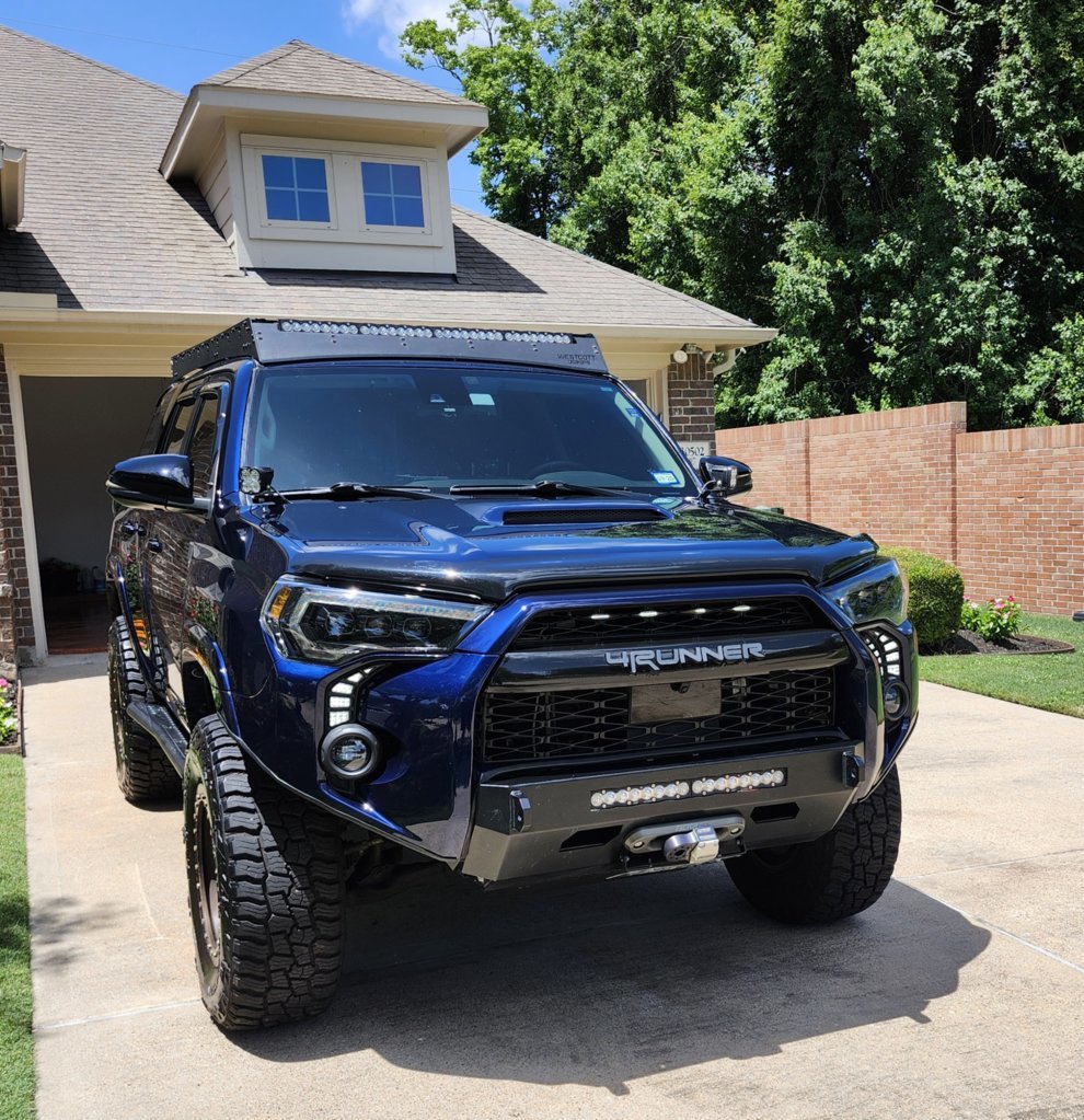

    The mods continue here on this rig:

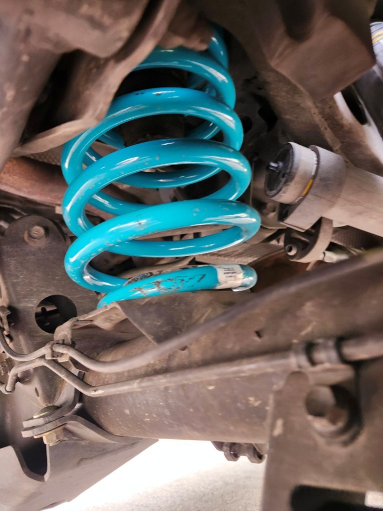

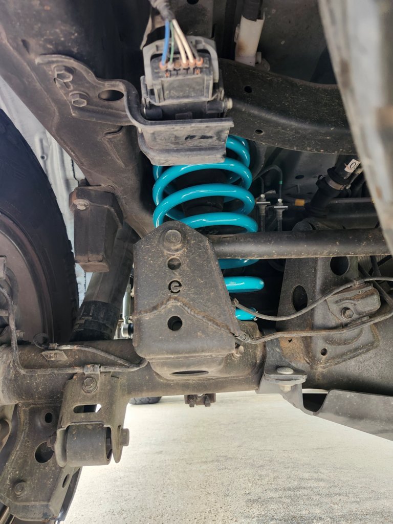

    Dobinsons C59-327 (2 to 2.5") - Heavy Load with 200-400 LBS. I got rid of the 2" Icon. I will post those shortly for comparison.
    These lift it the vehicle in the back and will see how everything settles after I load up all the crap I usually carry when I travel.

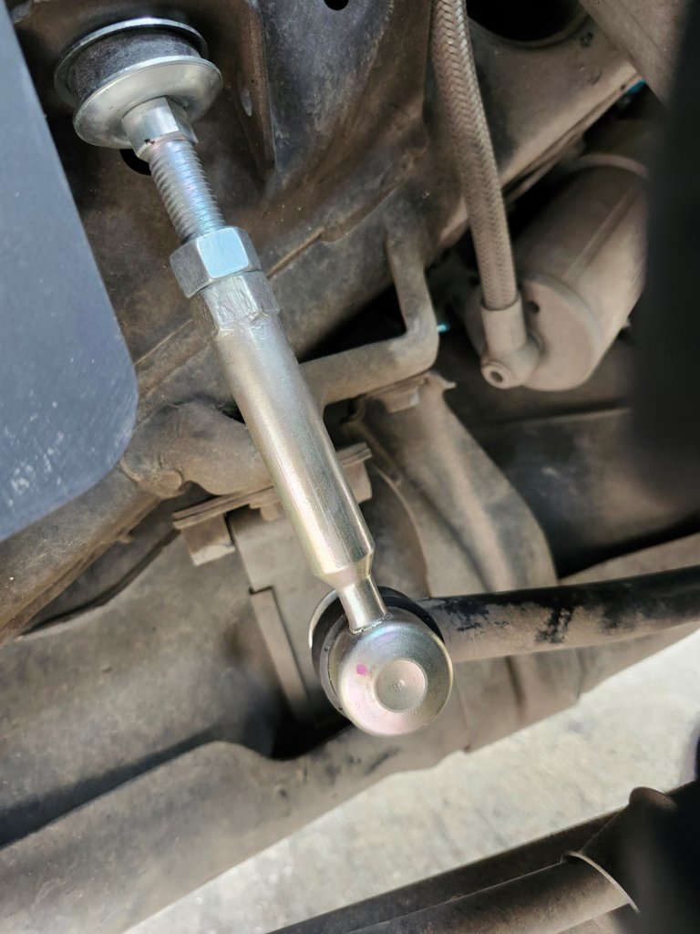

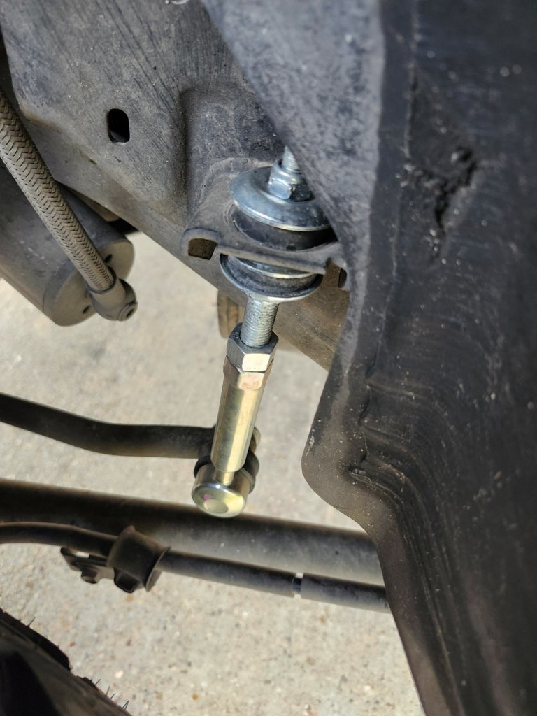

    And since I was in the neighborhood doing this job, I went and added the adjustable sway bar links for the back from dobinsons as well. These seem thicker and a bit longer than stock.

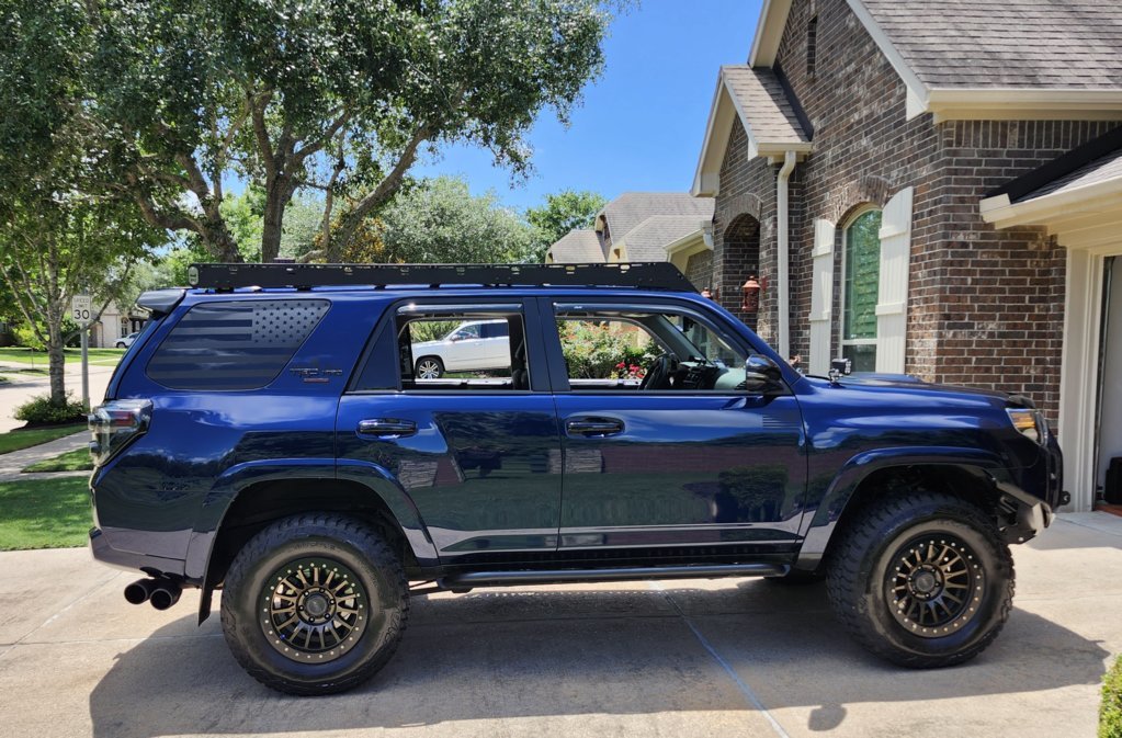

    Probably not the best "angle" pictures but here the before and after. The shiny clean picture shows the 2"Icon Rear Coil Springs
    The one below is the Dobinsons C59-327 Rear Coils, provides 2.5-2.75″ with stock weight. It goes to 2” with 200lbs to 400lbs constant load.
    djwantke and eurowner like this.

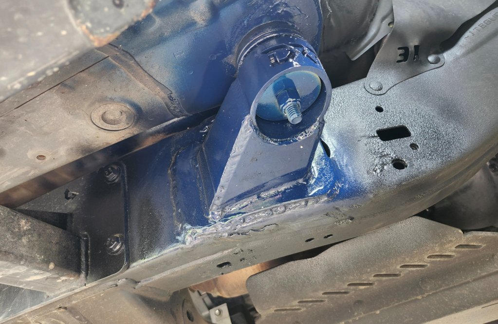

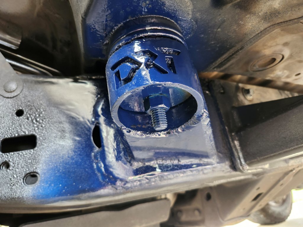

    1,248

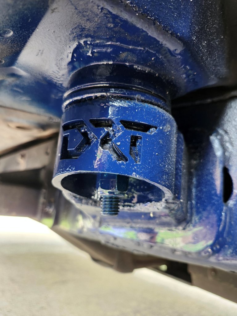

    Body Mount Relocation by DRT - https://www.drt-fabrication.com/product/5th-gen-4runner-cmr
    Ok, on this mod, I know I'm going to get some :crapstorm::crapstorm::crapstorm: from many for several reasons:
    1. Back when I was a freshman on this forum (2020), I said, there is no way I cut the frame on my 4R, no way I would do such a thing....well I finally caved on the urge to prep for 34s. The DRT product seems very good and solid.
    2. I painted the parts the same color as Big Blue but I should have gone with black and keep the frame uniform and low key. This will get fixed and corrected. Nobody can see it anyway.
    P.S. Still a freshman with a 0.0 GPA
