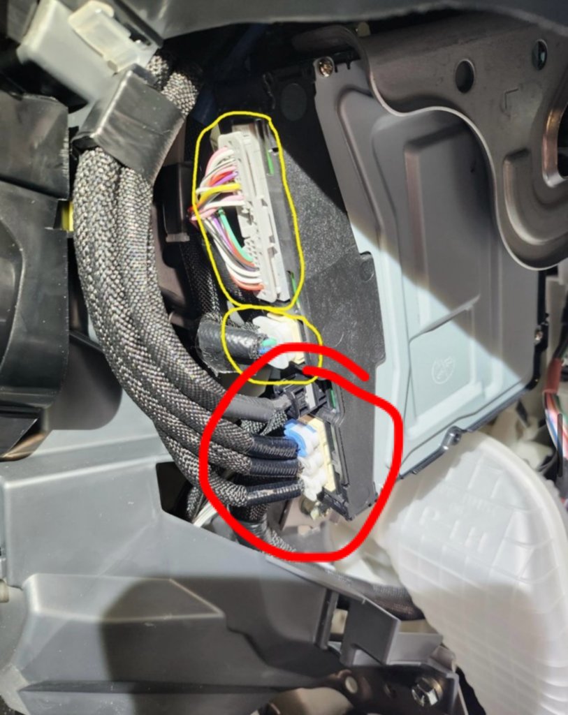

    So question. I know the DCM can be completely taken out with the two by-pass cables and maybe I missed it somewhere, but what do those hefty cables (circled in red) do?

  2. Jul 8, 2025 at 1:31 PM

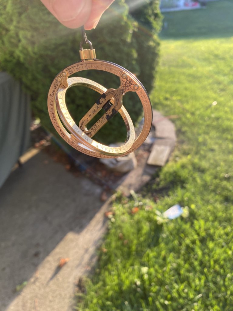

    I have a nice pocket sundial that not only tells the time, it will also align with north south whenever you get a time reading. Two fer one!!! Navigation might be a little slower if it’s cloudy out, (since you’ll have to wait till it’s not…), but it’s probably the surest way to opt out.
    roooo[QUOTED] likes this.

    Nice! Are the instructions in Latin?
  12. Aug 15, 2025 at 10:49 PM
    #342
    6,299
    Unfortunately no. The manual was in chinglish, and the pages were all out of order, but I figured it out lol. Tells time to the minute!!! But you have to account for daylight savings time on your own.
    What’s nice is that if you get amnesia for an undetermined amount of time on an uninhabited island , but you roughly guess the time, you can work backwards and get a pretty good approximation of the month/date as well. As long as you know your latitude.
    Isn’t modern tech great? Now I don’t need my phone for anything!!!:p

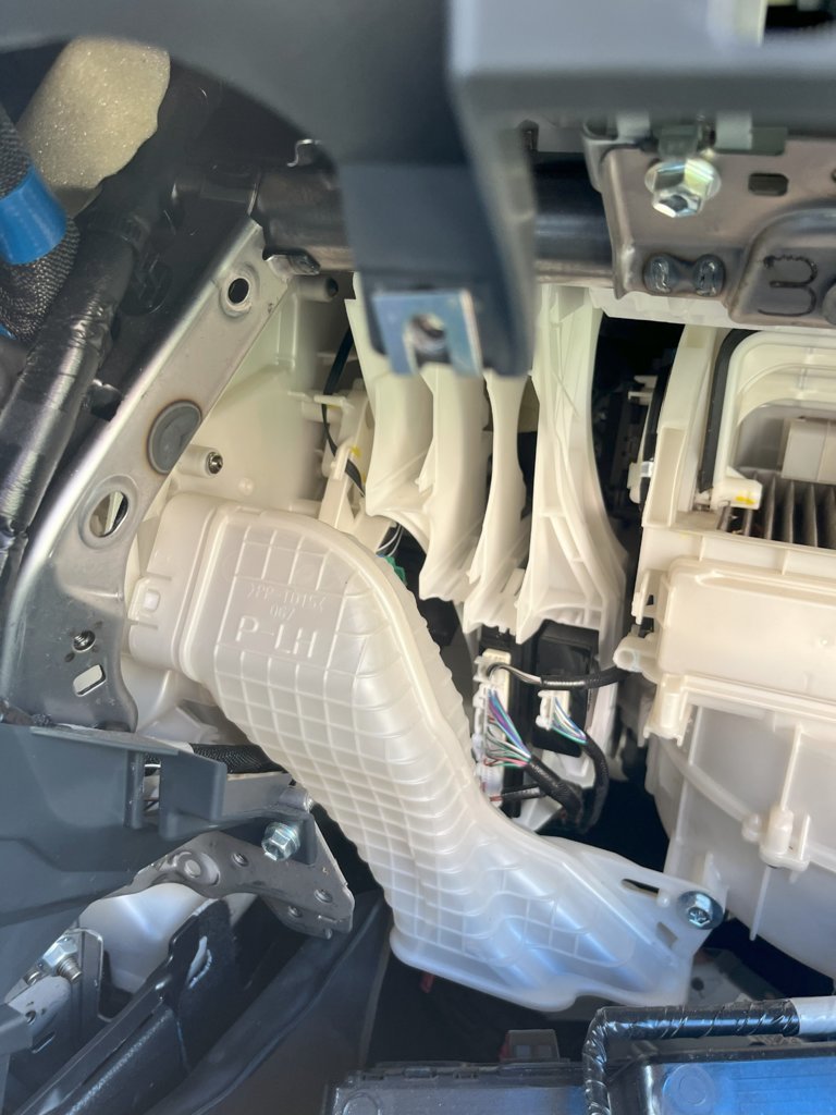

    First post here with a quick question, but first here is my own little odyssey..... I bought the bypass harness for my 2019 4R SR5 Premium, but when I reached the spot where it's supposed to be (very easily per description by madmax20, thank you very much, and also as shown in my 2019 factory manual) there was no DCM at all! So, now I'm feeling pretty dumb and emailed Auto Harness House and they replied that only 2019 models with a JBL system had it installed. Ok, so much for that, I suppose, I hope I can return the harness or maybe I'll sell it to someone else and wrap it up.
    Now the question now is: is there a DCM at all in my vehicle or is there a DCM function that's maybe incorporated with some other component in my year model? As I understand the DCM function is alive in many Toyotas as early as 2010 or so, but where and how? Thank you all for any input.
    Just for fun, following is a pic I took of the empty bracket

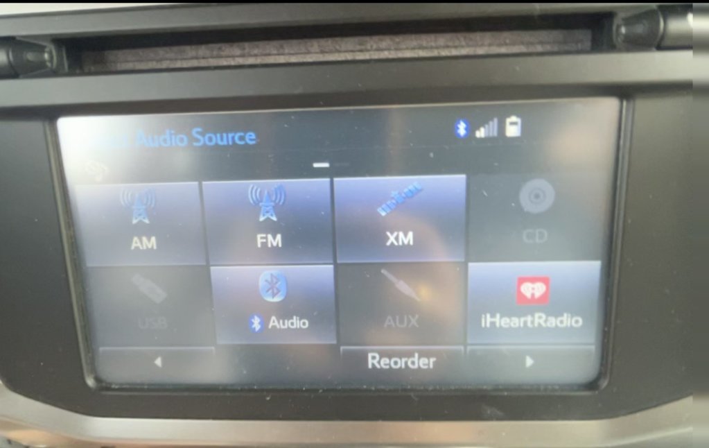

    2024 4Runner SR5
    I wonder if you'd be willing to show us a picture of your radio when it's on.
    If the car is equipped with A DCM it will usually say DCM on the top right corner of the radio. Along with the signal bars.

    Britus,
    There is a possibility you are looking in the wrong place.
    Earlier 4runners placed the DCM on the left side of the driver as opposed to where my instructions point to.
    Take a look at this youtube short.
    https://www.youtube.com/shorts/0ER9ZA0tIT8
    I'm just putting the possibility out there.

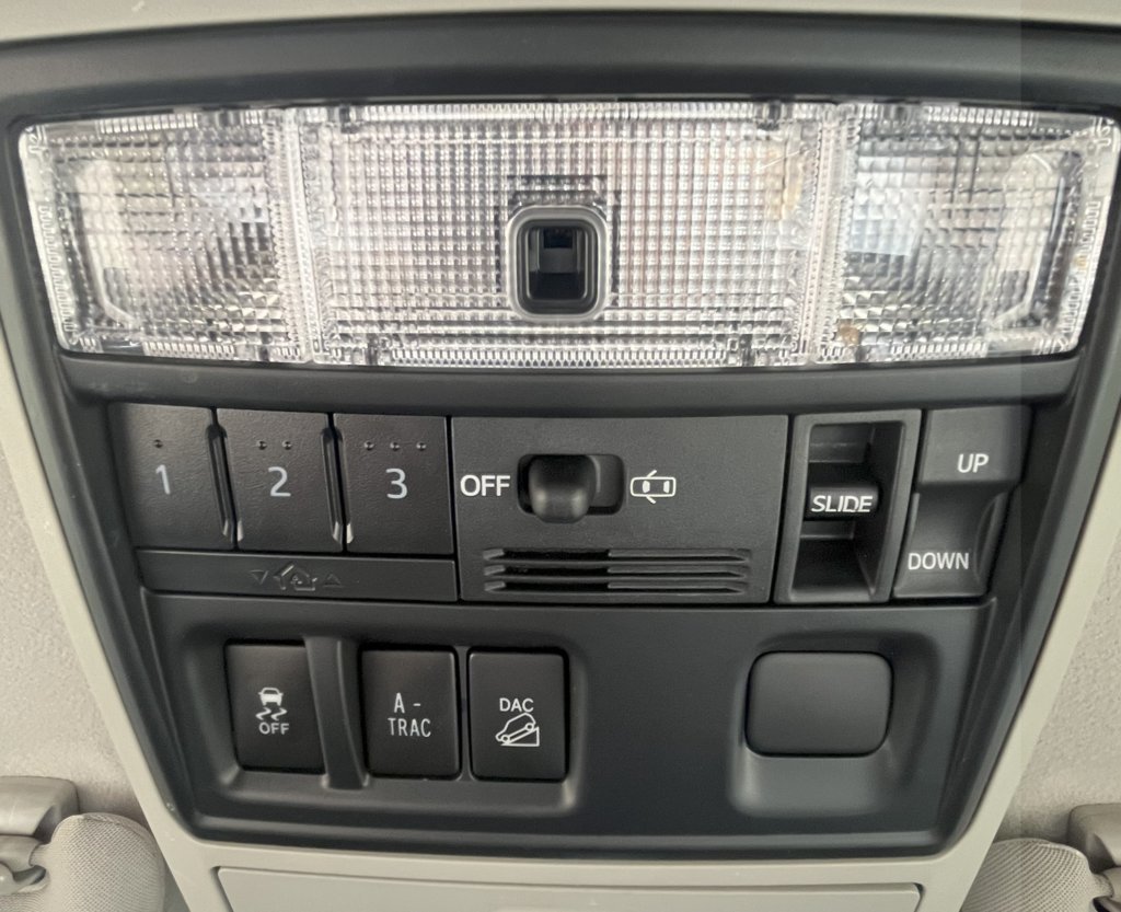

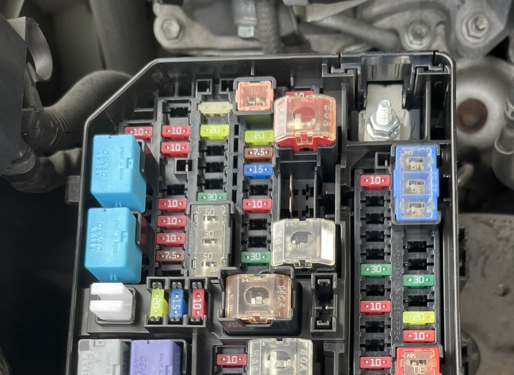

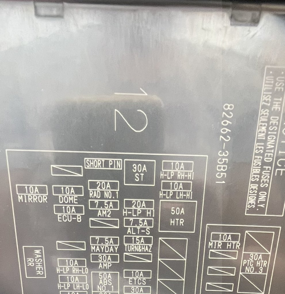

    Hello Madmax20, here are photos that were convincing me that my 4R doesn't have a DCM until I saw your last message: no DCM on screen, no manual SOS switch and no fuse called "Mayday" in the fuse box
    screen capture no DCM.jpg light assembly no SOS button.jpg fuse legend.jpg Fuses no MAYDAY.jpg

    But now, I must re-look at the whole thing again and will be pursuing the potential for a different location for the device. Thanks for following up, luckily I really don't mind getting to know my 4R better....

    Thanks for sharing. Right, no DCM on the radio, no red SOS button in the dome panel.
    You might just be safe after all.

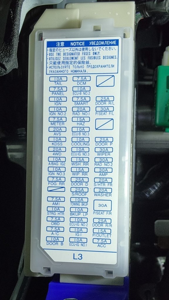

    Just one more thing, (holding a cigar like Columbo)... The DCM fuse (if there is one) is in the in cab fuse box below and to the left of the steering wheel.
    Good luck!
