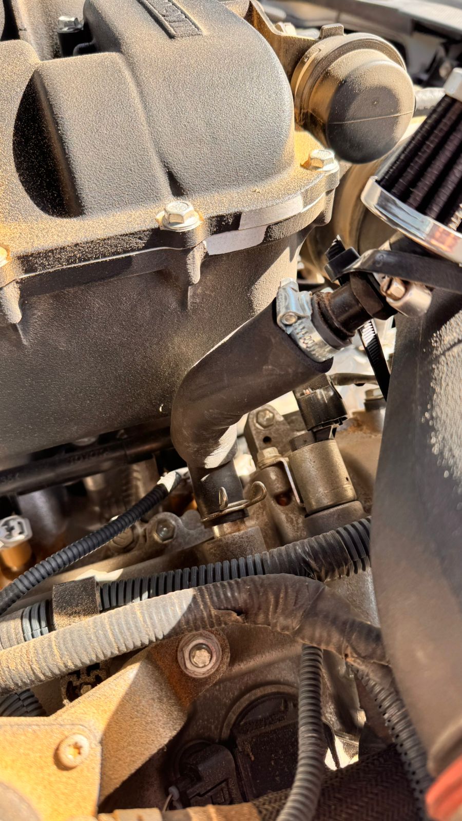

  26. Jan 25, 2025 at 1:44 AM
    #56
    4runnerfromdxb
    4runnerfromdxb New Member
    Oct 8, 2024
    #43274
    39
    How should a crank case breather be routed into the intake on a TRD car?
    The shop that did my setup did a really bad job and just left it dangling inside the engine bay... I shortened it and ziptied to the intake until I figure out what to do with it.
    A non TRD intake has this funky blank connecting it back to the vent.
    But on TRD model there is no extra slot, making me wonder how it is done in the TRD case?
    Because now it's just ridiculous... a short pipe ended with a tiny cone filter. A disaster waiting to happen.
    Thacrow likes this.
  27. Jan 25, 2025 at 1:26 PM
    #57
    jdm-v35
    jdm-v35 New Member
    Feb 11, 2023
    #31200
    152
    CO
    2018 4runner TRDORP, 2019 Audi RS5
    Magnuson Supercharger etc.
    The TRD intake has the pcv breather going back into the coupler on the throttle body. You need replace/extend the PCV hose and reroute it back to the throttle body since it becomes a longer distance with the magnuson. The breather should function ok, just looks crappy.
    ChessGuy likes this.
  28. Jan 25, 2025 at 1:33 PM
    #58
    1,202
    Not only that...but it could throw you a code if this isn't done correctly. This flow needs to be routed right into the throttle.
  29. Jan 26, 2025 at 6:21 AM
    #59
    4runnerfromdxb
    Oct 8, 2024
    #43274
    39
    Eh... another quality job done at Dubai's Magnuson authorized dealer... :| Guys here can break anything. Even when shit is plug and play they find a way to do it their way because of lack of imagination. Anyways, got it installed like on this picture myself. They kept my car for almost 2 weeks and left me with that crap pcv breather hanging loose with a "filter"... :(
