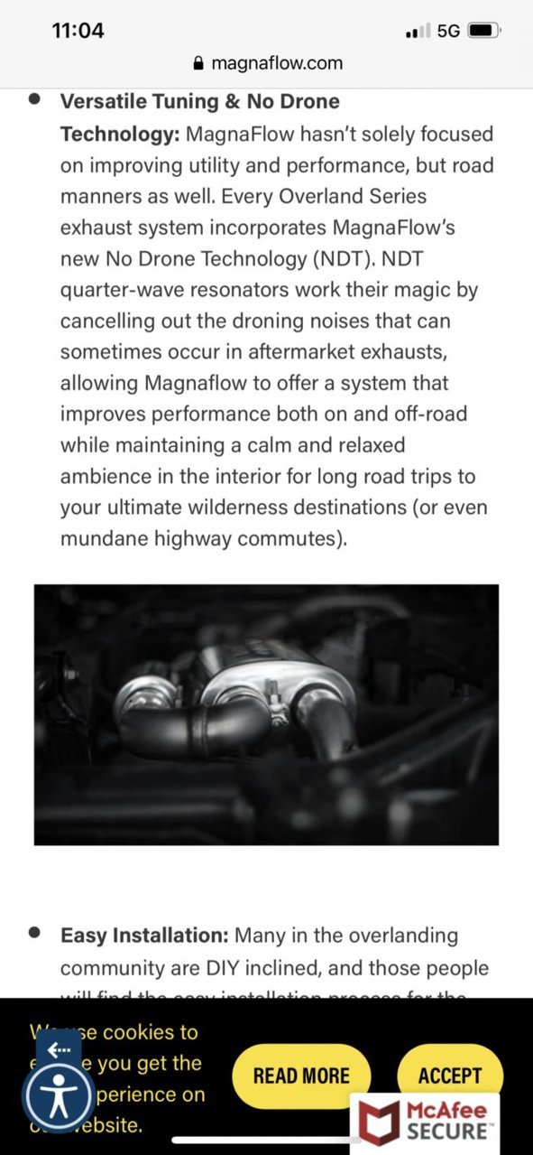

    This system caught my eye when it was 1st rumored as they advertise no drone. I had the TRD exhaust on my 19 orp and again on the 20 pro. Sounded nice until driving up an incline or real bad when loaded down or towing! In Chicago I really don't overland so for those that do, an added bonus is the highest ground clearance you can get on a runner.
    Initial post below, ignore my initial review as I found out what was wrong.
    I didn't want to clog up the TRD thread. This system caught my eye when it was 1st rumored as they advertise no drone. I had the TRD exhaust on my 19 orp and again on the 20 pro. Sounded nice until driving up an incline or real bad when loaded down or towing! In Chicago I really don't overland so for those that do, an added bonus is the highest ground clearance you can get on a runner.
    Really hoping this has no drone as I ordered it on release day Monday so I'll chime back in after the install to let you know
    https://www.magnaflow.com/blogs/magnaflow/tech-talk-overland-series-exhaust-systems?_ke=eyJrbF9jb21wYW55X2lkIjogIlBtaUJGcyIsICJrbF9lbWFpbCI6ICJkc2I3NTlAZ21haWwuY29tIn0=
    Heres a quote from them-
    • Versatile Tuning & No Drone Technology:MagnaFlow hasn’t solely focused on improving utility and performance, but road manners as well. Every Overland Series exhaust system incorporates MagnaFlow’s new No Drone Technology (NDT). NDT quarter-wave resonators work their magic by cancelling out the droning noises that can sometimes occur in aftermarket exhausts, allowing Magnaflow to offer a system that improves performance both on and off-road while maintaining a calm and relaxed ambience in the interior for long road trips to your ultimate wilderness destinations (or even mundane highway commutes).
