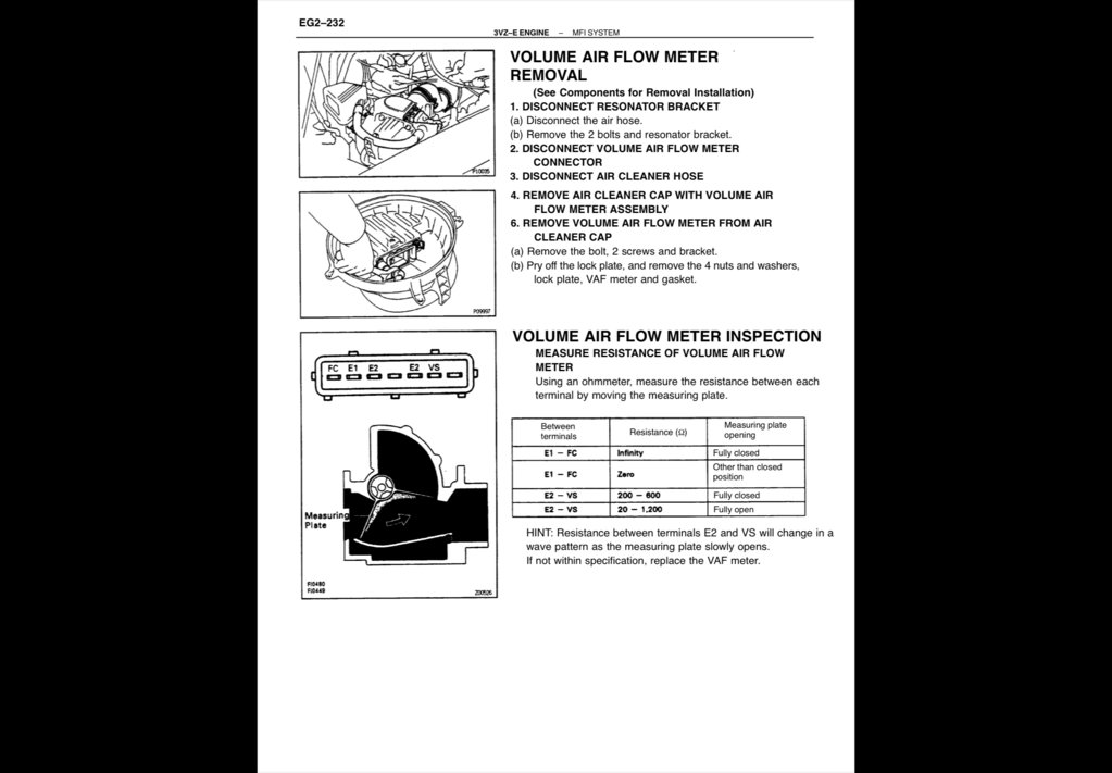

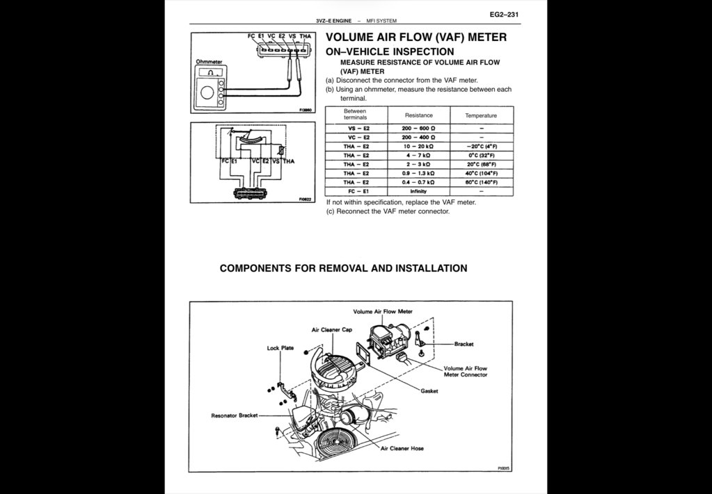

    Why was the original VAF replaced? Did it test bad? If you still have the original OEM VAF, test it with the attached procedure, it is an easy test and you only need a multimeter. If the numbers are good, there is nothing wrong with the VAF. After market VAF’s are usually very low quality components.
    A vacuum leak could be the problem. There are so many sources of a vacuum leak on these old trucks the best way to check is to use a smoke generator. If your mechanic did not use a smoke generator, find a mechanic that has one or buy one from Amazon and check it yourself.
    The distributor, ignition coil and TPS can also be tested with a multimeter. The Ignitor and ECM cannot be tested, but they are very reliable and usually do not fail.
    Keep us posted with your findings.

    Thanks for the info! The original
    maf tested bad. I’m unsure how my
    Mechanic tested for vacuu leaks but I’ll ask. He claims there are none but I’ll check on his method. Appreciate the input and I’ll keep ya posted. If the new ECU doesn’t work at least the company accepts returns! Also I’ll check the ignition coil but I think my Guys did that too.
