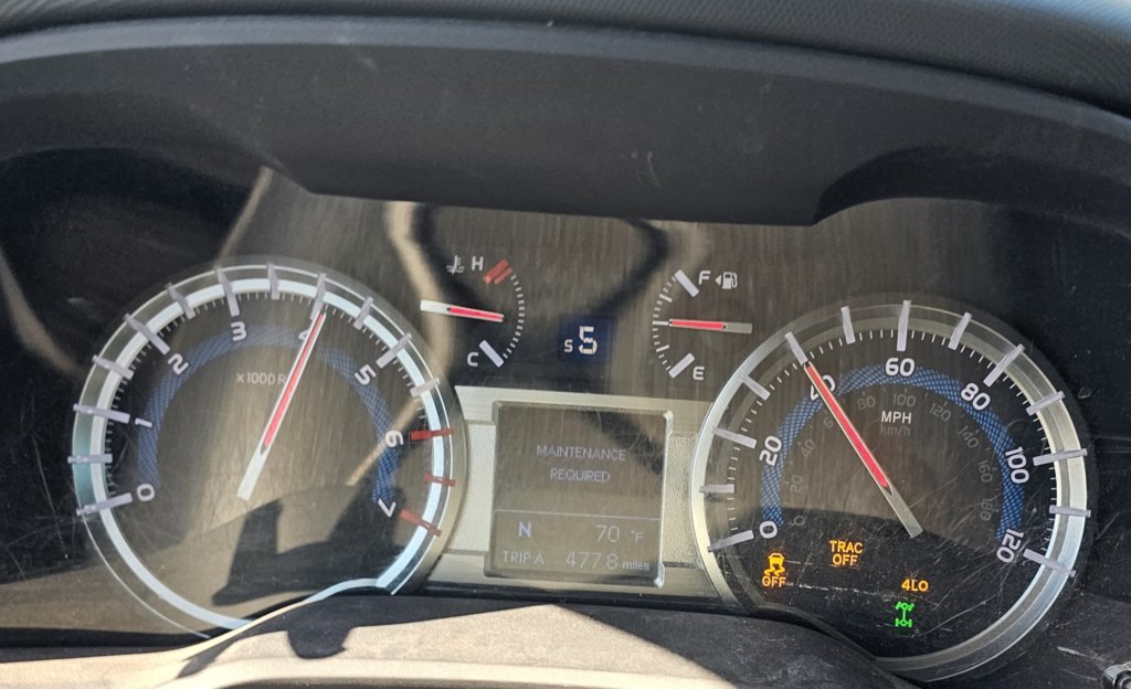

    I think I may have made a beginner mistake.
    I took my 4runner into the desert and I shifted to Low 4 and put it into Sand and loose dirt mode.
    I got carried away and went 30 MPH.
    Now when I turn my steering is a little sticky and when I accelerate its not as responsive.
    I plan on taking it into the dealership. But I thought id brain dump here and ask around before I get "scammed".

    I agree. The symptoms described make it sound like the vehicle was never shifted back into 2 high.

    Looks like you're still in 4hi even though the lever is approximately in the 2hi position. I noticed this behavior a couple of times this winter. Shift into 4hi while moving straight, wait for the indicator to turn solid, then shift back into 2hi. The lever should snap into its 2hi detent crisply.

    @MandoRaider , any updates? It sounded almost as if it hadn't been shifted out of 4wd by the description.
