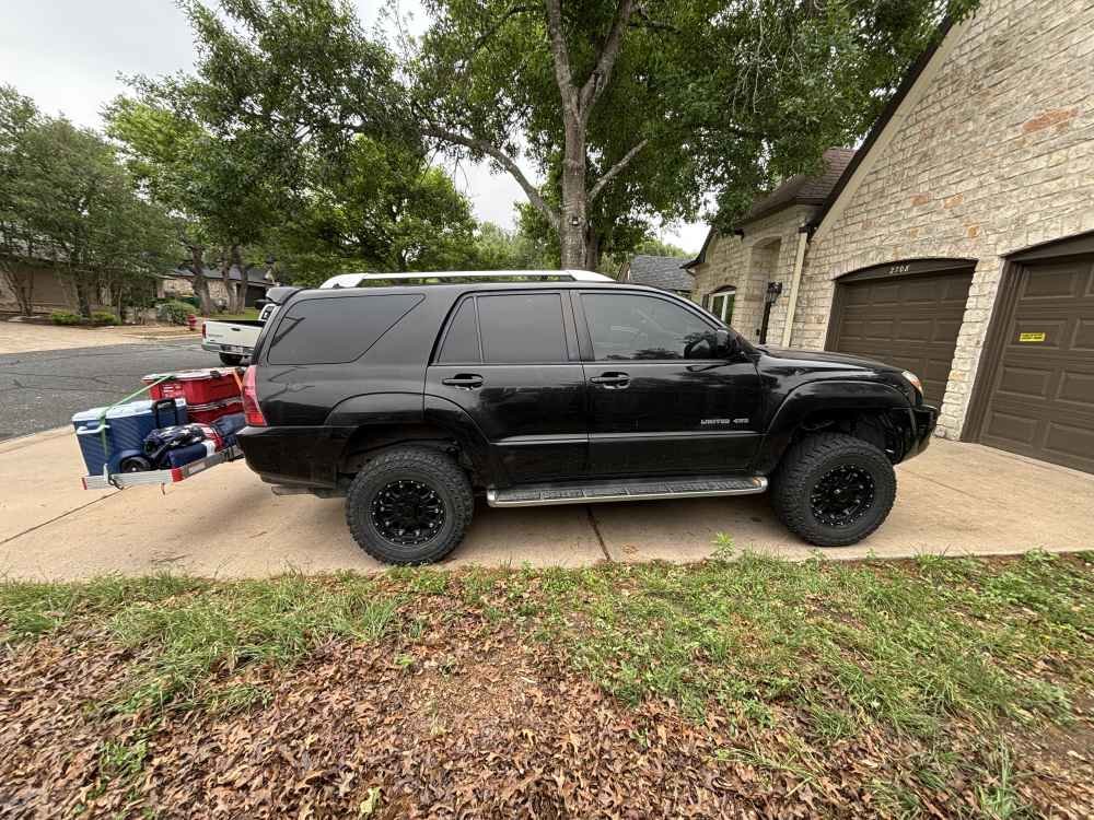

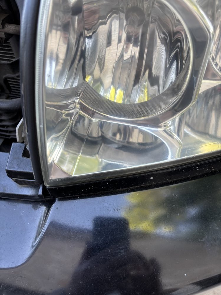

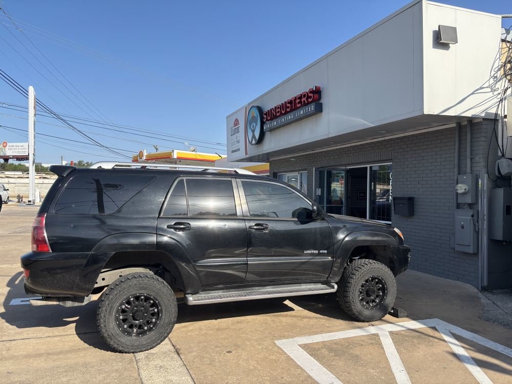

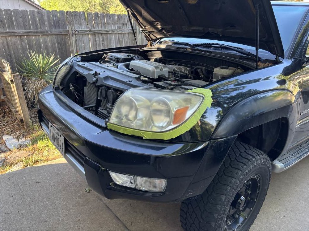

    Dark day yesterday but I retook a full side shot with the blacked out center caps.
    Not sold on them.
    I will pull the larger plastic bolts form the wheels after our event at the end of April.
    Up next will be replacing the turn signal & fog housings and redoing the headlights.
    I'd love to do something more custom for the headlights but I've only driven this a few times at night since I got it.
    As you can see in the first pic I frequently get blocked into the driveway... so not sure super snazzy headlights are a wise purchase.
    Might get some additional lighting though because this dark tint is stupid dark.
    I think I will have it redone with ceramic and not so dark that I can't see out.
    LOSTR4 likes this.

    Just upgrade to the facelift 2006-2009 headlights! WAAAY better and OEM Spec! That's what I did and you can still find the trim piece under the headlights if it bothered you too much...hardly noticeable...

    Interesting.
    That does look better than pre-facelift but then is there always a gap near the grill?
    I looked at a few write ups and it looks like some people had issues with either hyper flash or lights shutting off. Has that all been figured out?

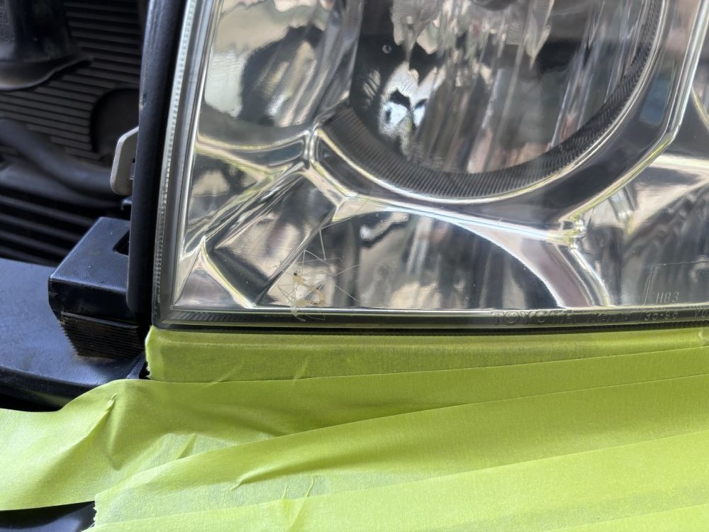

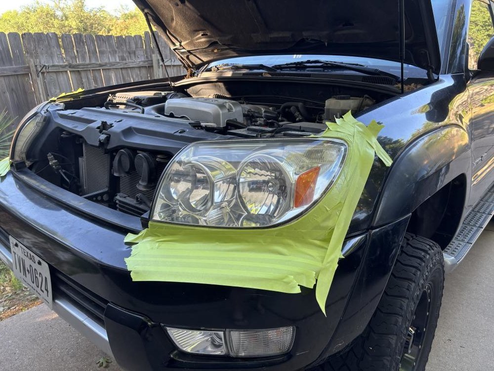

    My pass side turn signal housing was leaking & filling up with water.
    So each time it would rain I ran the chance of it shorting the bulb.
    All my lights were cloudy and since I have a headlight restore kit lying around I figured the easiest/cheapest thing to do, for now, is replace what is in there.
    Just to get it road worthy.
    I ordered new parts from Amazon.
    Blinker Housings
    Fog Lights
    The blinker housings went right in.
    The fog lights had a minor issue.
    One of the screw holes was the same ID as the OD of the OEM screw. So that wasn't going to work.
    First attempt was to cut down and glue in some plastic sheet rock anchors.
    The glue failed so I had to come up with something else.
    LOSTR4 likes this.
  23. Apr 7, 2025 at 2:32 PM
    #53
    lockedup
    lockedup [OP] Old member
    May 23, 2024
    #40657
    47
    2003 V8 4WD Limited with 2.5" Lift and 31s
    I suspect I could have used a 5/16 lag screw and just dulled the tip so it didn't bust through the housing.
    That would require a trip to the store.
    I'm impatient.
    I opted to modify some hardware I had lying around.
    Tapped the housing.
    Cut the screw to match the length of the OEM unit.
    Chamfered the end.
    It worked just fine.
    Anyway ... this is a VERY easy swap to make if you are in this boat. Just check your bolts first.
    Next up I will do the headlight restore.
    BassAckwards, LOSTR4 and gkomo like this.
