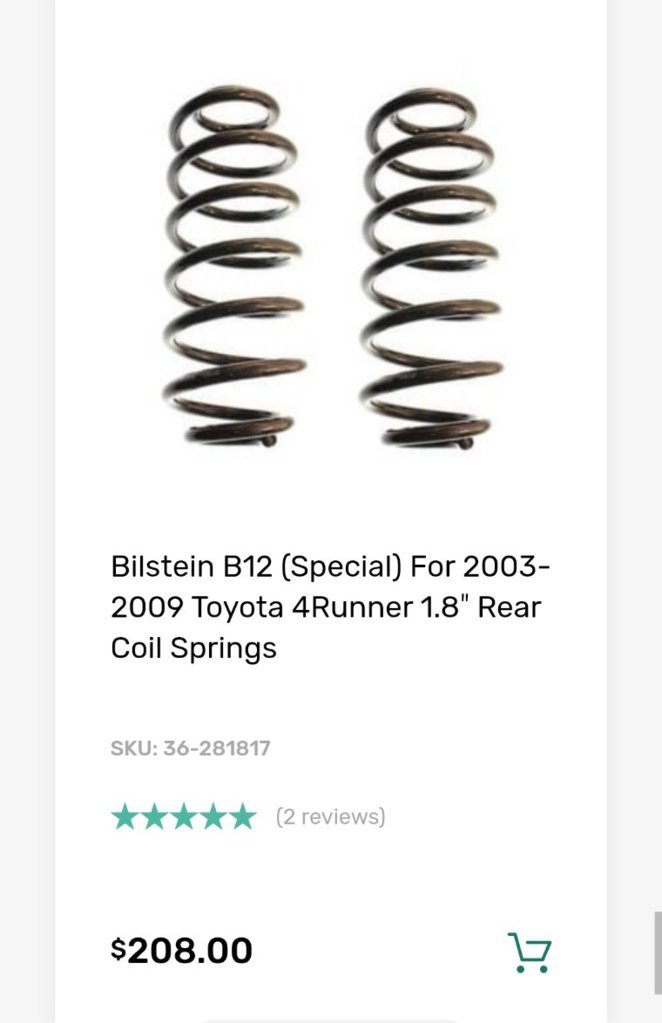

    Thanks everyone for the good info. I got the Tacoma TRD coilovers from a 2022 Tacoma brand new, 4Runner specific 4600s for the rear and splurged a little and got the B12 springs for the back as well. I'm debating the spacers for the front. Is there a good brand to look at for spacers or a brand to stay away from? I've never used spacers in past on my Tacomas. I'm planning on only a 1/4" spacer. I don't need much if any at all. I'm really liking the stance of it now. Just need some new wheels and tires. Thanks.

    Just remember don't use the rear Tacoma shocks. They won't handle the 4runner weight and you'll be bouncing too much. You can keep your current rear shocks. For the spacers just buy aluminum, any brand is goodit is just a peace of metal.

    so what should i do on the rear? i mean i really just need a simple new pair of shocks.
    i dont tow, some very light light trail driving maybe twice a year.
    is something as simple as the $45 each dualast shock from autozone sufficient? that is the first thing that shows up on their website when you look up shocks for my vehicle. plenty of great reviews

    Use this coils for rear. The $45 shocks should be OK, but 4600 will be perfect for sure.

    those will keep my rear end the same height as it already is?
    those will keep the rear end the same height?

    there will seldom be anything in the rear. maybe 180lbs of labradoodles occasionally. this rig takes me to the gym and back once a day, avg ill put 5 miles a day on it, and then take it fishing on the weekends
    my main concern with replacing them, is that it currently sits exactly how i like it. and my new shocks may even add a smidge of height alone.
    this vehicle has never been off road, never towed, or driven rough, or had anything heavy in it. i know the original owners. my plan is to skip the coils, and i will get an alignment about 500 miles into the new shocks and struts. if they find that its not perfectly level, ill add some on there
    not sure what brands make a good coil that is just a design to replace the original. shopping online it feels like they all are designed to add lift

    They'll add about 1.5 inches of lift. Fore reference, mine sits a 22-1/2" center to fender.
