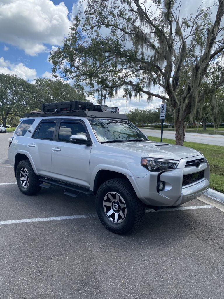

    Pics forthcoming!

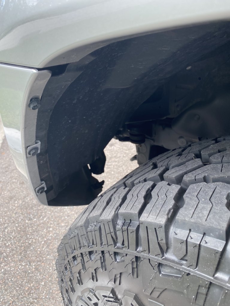

    Was the vehicle aligned after the lift? It should be. That would be my first step before judging how it feels when driving it. Your camber and caster will be very thrown off due to the geometry changes of the lift. Those two things can completely change how it feels driving down the road.
    If you have stock wheels, with 285/70-17s, you technically don’t need a lift to clear them. Regardless, whether you have a lift or not, you only need a little trimming front inside lower corner of the bumper cover, and slight repositioning of the fender liner in that spot. 20 minutes with a box cutter and drill for new holes to reposition the liner.
    However, be aware that if you change to an aftermarket upper control arm, this will require metal work to clear the tires! The reason is that aftermarket control arms reposition the upper ball joint rearward, which means now your tire will likely contact the body mount, or will have the potential to do so under hard suspension cycling. To solve this problem, you have to trim the front sections of the body mounts and weld on new plates to it to close it back up. Personally, I would not change the UCA.
    If this were me, I would first have it aligned before doing anything else. This absolutely has to be done first! They will probably not be able to get the caster angles perfectly within spec, due to the lift, but it will be very close to it. In my experience (with a similar lift and tires), having caster close enough is good enough. However, make sure camber and toe are within spec! This guarantees that your tread contact patch is flat against the road (camber), and aren’t scrubbing too much (toe).
    The next step I would do is to go back to the first shop and ask them again for your fender liners. If they are still saying they threw them away, ask them to make you whole and buy a new set from Toyota.

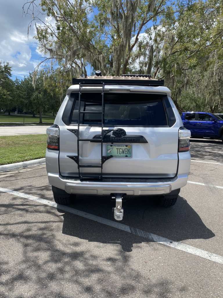

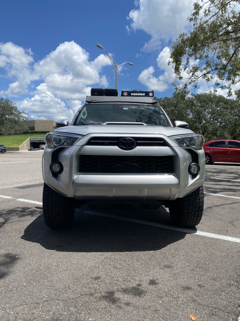

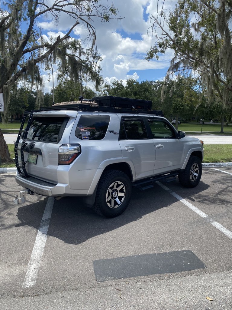

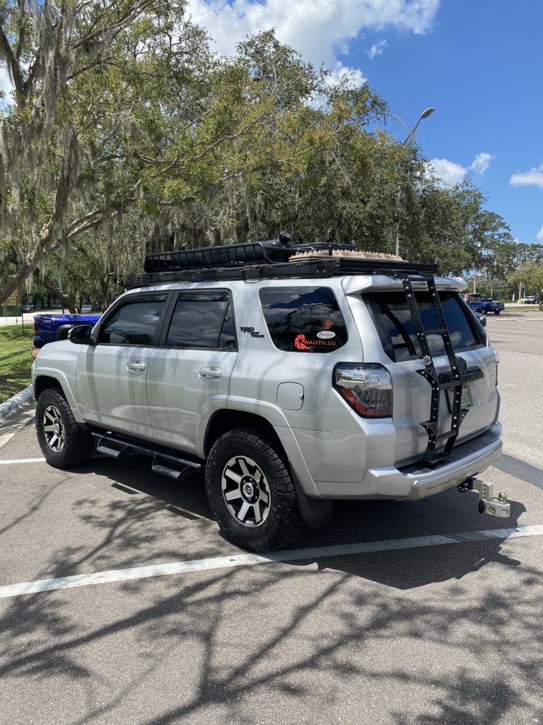

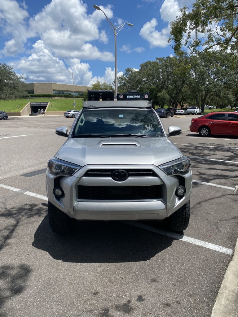

    Pics added at end of thread.
  8. Aug 25, 2025 at 10:56 PM
    6,289

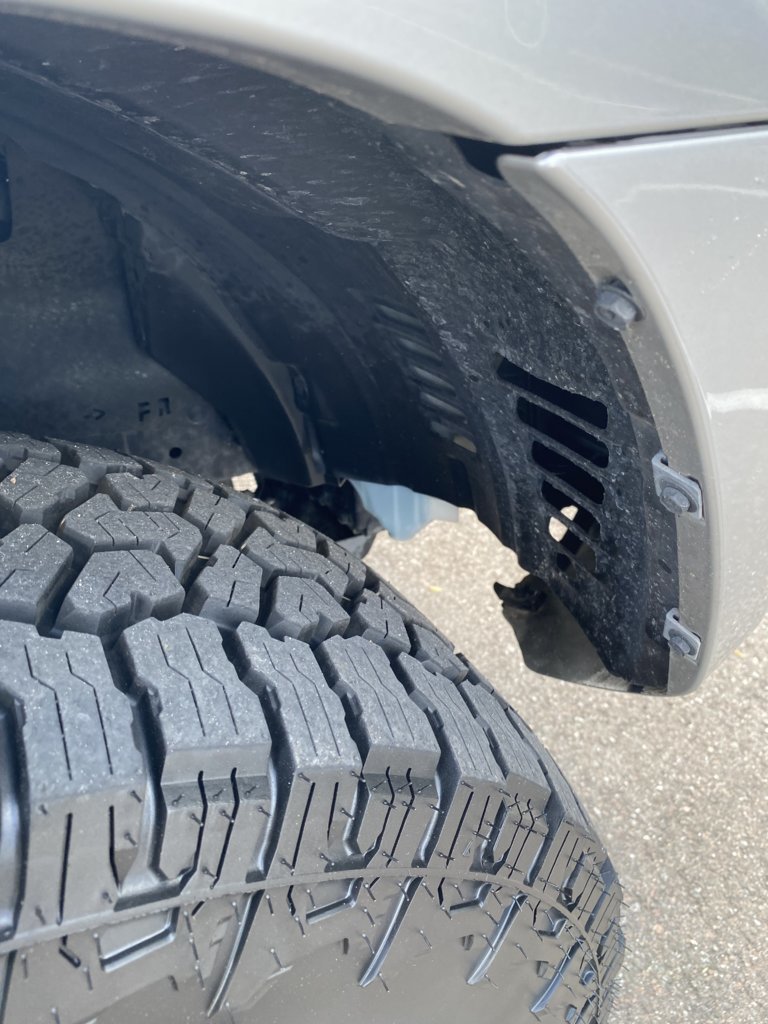

    Oh I see what they did with the fender liners. It’s a bit “inelegant” lol. But, besides that, she sits real nice!

    Yes, inelegant indeed!
    Do you think that could cause any problems, like rainwater getting into the motor (as suggested by another form member) as an example?
  10. Aug 26, 2025 at 11:18 AM
    6,289
    It depends, whatever isn’t covered is going to be affected to some degree. Given the amount of driving I do in winter with road salt spray, I prefer to keep factory shielding intact.
    At the very least, what they cut away will make winter and mud cleanup more difficult for you. You want to make sure any new areas that get exposed to road spray get rinsed out well, including the front frame cross member. Especially if you drive on roads that have been de-iced.
    Ideally, they would have just trimmed the bumper cover plastic at the corner, and pushed the liner forward and drilled a new hole in it to hold it in the new position.
    I’ve got 285/70-17s on stock wheels, with stock UCAs. This is all I had to do to make sure it didn’t have any tire rub at full suspension compression (at least at middle of suspension stroke, where the tire is closest)
    Worst case, you could buy some rubber or other flexible sheet materials and patch that up.

    Just a reminder, if you install the JBAs, it will cause rubbing on the rear side of the tire against the mudflap and the body mount. It probably wont rub in most situations, but if you’re ever turning when the suspension compresses half way, you’ll likely end up tearing a mudflap off, at minimum. The only way to fix this is to cut/trim the body mount with a cutoff wheel and grinder. Then weld on a cap over it.
