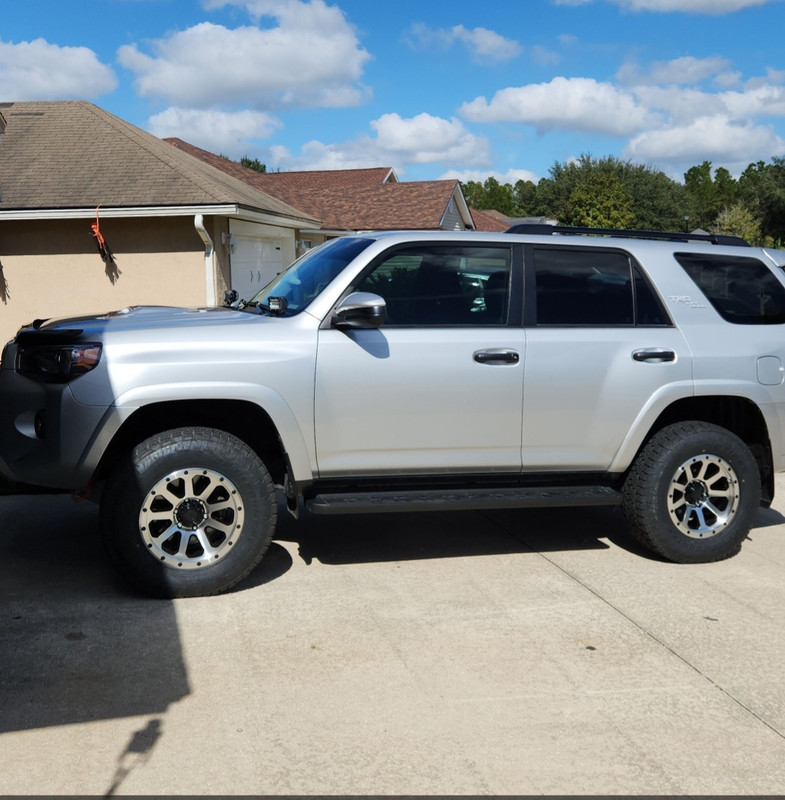

    Bilstein 5100's, 1" Cornfed Rear Spacer, Aluminum Skid Plate, Powerstop Z23 Pads/Rotors, 4WDKING 30" Light Bar, Nilight Ditch Lights, BBG4x4 Front Recovery Points, American Outlaw Gunslinger wheels 17x8.5 -6 Offset with Toyo Open Country AT3's
    [​IMG] [​IMG] Did Bilstein 5100's all around. Reused the factory springs and with the front shocks on the 3rd clip position, which is 1.88inches of lift if I remember correctly, truck was almost perfectly level. I ended up adding a 1" Cornfed spacer to the rear to prevent squatting with passengers or gear in the back. No squeaks or rattles. Far as I can tell it still rides factory. Did loose a little mpg but it is what it is.
