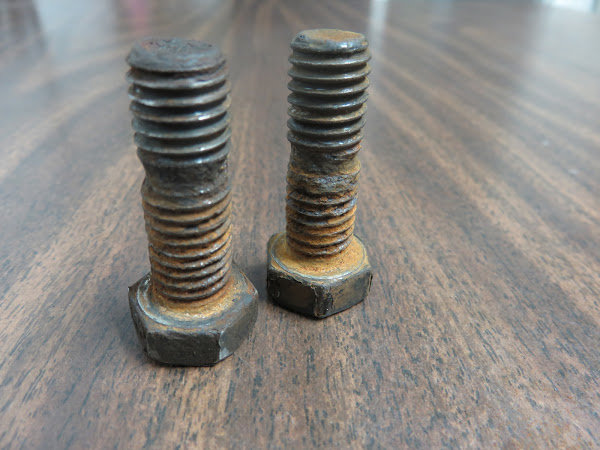

    If you daily towed your boat trailer through the winter road salt, it would last maybe 5 years. Here are 1/2" dia. galvanized grade 8 bolts used to hold up the All-Pro bumper on my previous Tacoma, 3 winters later:
    Galvanized parts still need an appropriate primer and top coat to survive winters here. That top coat needs to be maintained and touched up.
