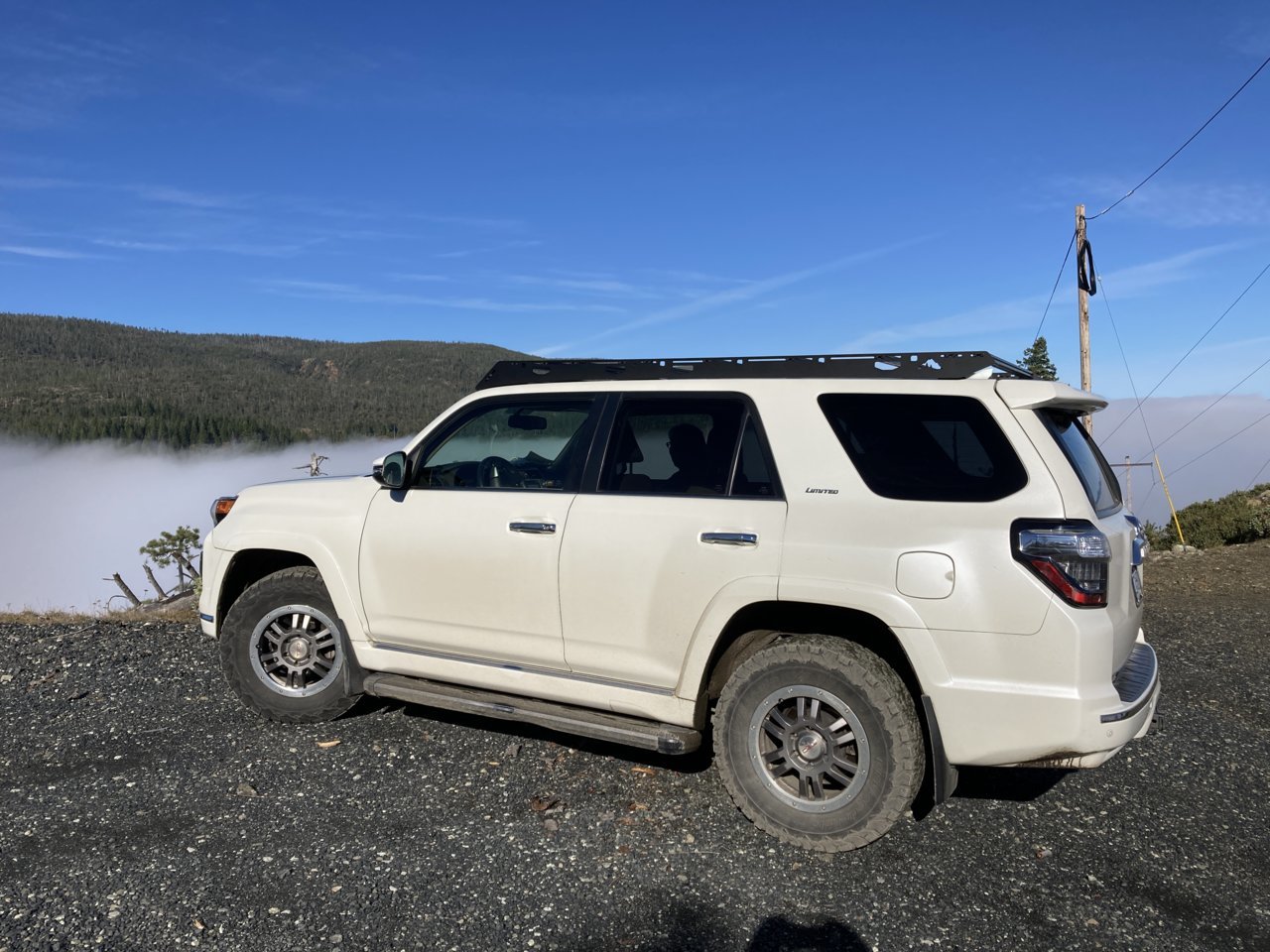

    Here is a mine with a 3" front and rear OME lift. I have Method 704 wheels with 295/70/17 Yokohama Geolandar MT G003. I know you wanted to go with AT's, and I will probably go that way after these tires wear down. Although I will add for MT's they are not very loud. I do live in Southern California and this truck sees all types of terrain. I do have a BMC and very minor trimming. I don't have any rubbing.

    What rack is that?
  26. Jul 20, 2023 at 8:53 AM
    #56
    jvilla1971
    jvilla1971 New Member
    Mar 15, 2021
    #20351
    11
    Baja Rack
    2021venture[QUOTED] likes this.
  27. Jul 20, 2023 at 8:55 AM
    #57
    2021venture
    2021venture New Member
    Jan 15, 2023
    #30658
    898
    Todd
    2021 Venture
    Nice looking rig. I have same rack and don't see many of them.
  28. Jul 20, 2023 at 9:07 AM
    #58
    jvilla1971
    Mar 15, 2021
    #20351
    11
    Thank you, this rack has held up really well.
