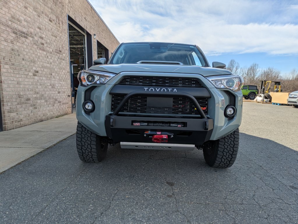

    Yeah bumper and winch have me thinking of adding one on my truck, they seem easy enough to install and aren't overly expensive. The only downside I see is they block a bit of the radiator, so food for thought. Pic of my current front-end setup.

    Talking with a mechanic, he mentioned the bumper and winch blocking the flow as well.
    did a drain, fill and will be ordering the iconic FJ transmission cooler.
