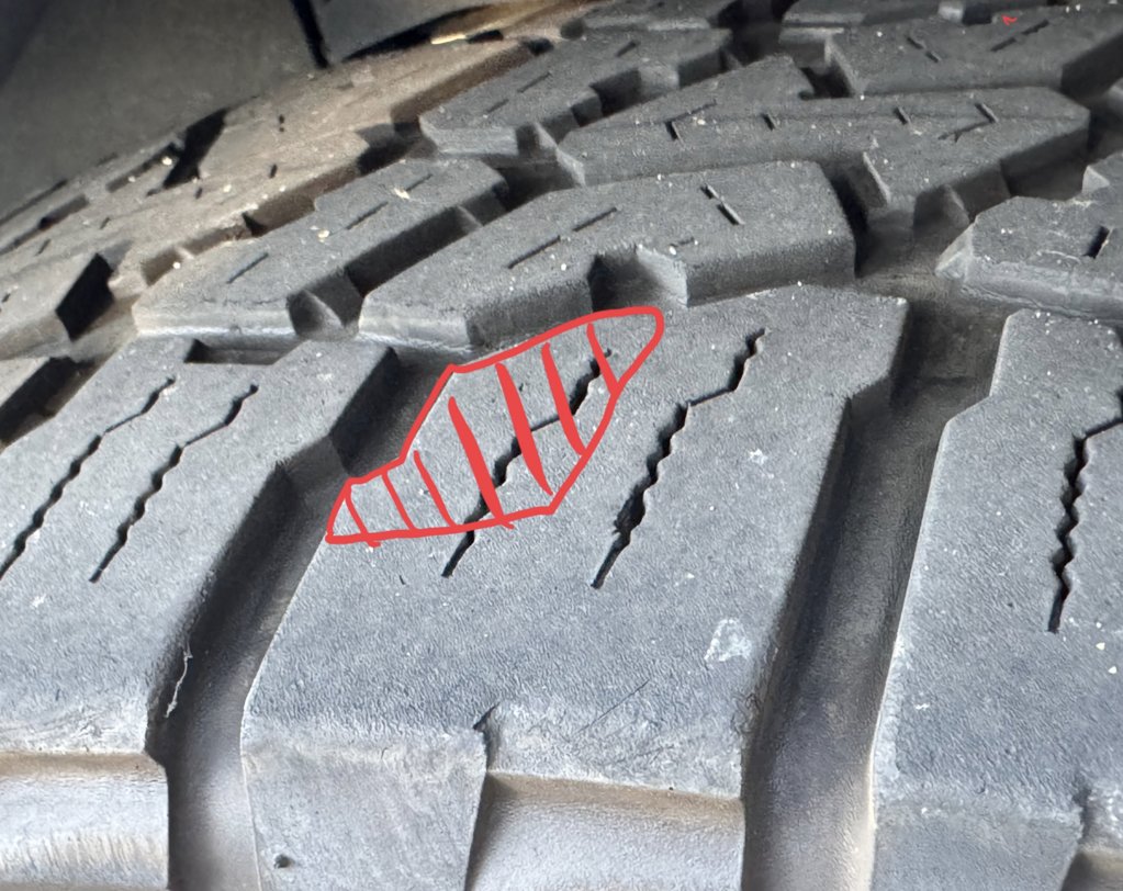

    Post a photo of your uneven tire wear.

    I'm traveling till Friday. I'll see what I can do. Prob a hard thing to capture w an iPhone.

    Hi. Sorry this took so long. Here is a photo. The red bit is where it is lower than the rest of the tire.

    I’d get an SL tire & new rotors with new pads. I bet your caliper could use some TLC. Post some pics of the wheels too
    OP, I just went through this & the fix was new tires & rotors with a mount/balance & alignment

    Thanks. Do you mean break rotors? I had the brakes done about 15,000 miles ago so they should be fine. Plus, I can’t make up in my head of the brakes could cause road noise. But I’m no mechanic.
    New tires are planned. There’s nothing special about the wheels - just the standard black TRD Pro wheels.
