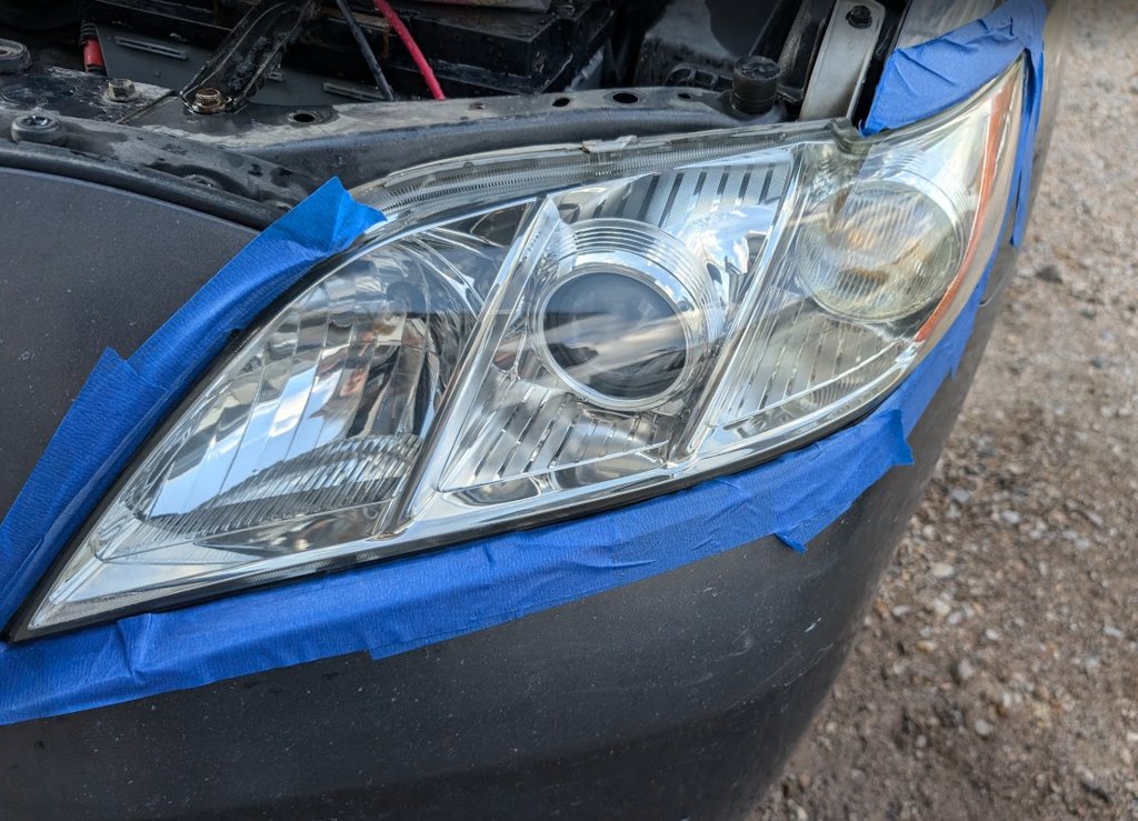

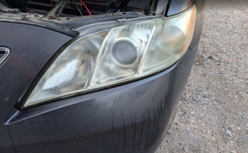

    I did a restoration on my daughters 2016 camry. They were really cloudy, much worse than the OPs. The procedure I used was
    1. Tape off area around headlight
    2. Wet sand with 800 grit
    3. Wet sand with 2000 grit
    4. Wet sand with 5000 grit
    5. Polish with rotary polisher and polishing compound ( w/o any fillers)
    6. Sealed with graphene coating
    Still look great after 8 months in the Texas sun.
    Note- The Meguiars headlight coating was a fail. The first coat was nice, the second looked terrible. If you're gonna use this, do it in one coat. It came off easily w rubbing alcohol.

    Yes. Most of it is just using the right progression of grits, but the clear coat finish makes a difference. It's just like new.
