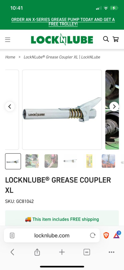

    I highly recommend the extended lock grease coupler.
    I have mine on a rigid (not flexible) pipe on a "pistol" size grease gun.
    Really helps with U-joints especially when under runner in driveway. I chalk the side of propeller shaft with zerk down facing ground.
    I roll runner till I see the chalk-then crawl under and lube. I only do a single pump on sliding yoke.
