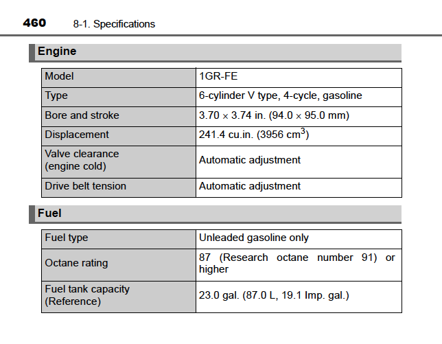

    When I went to the gas station with the dealer guy to fill it up, it only took 19 gallons....?
    I can't believe it's got a 4 gallon reserve, and the specs say 23 gallon tank with up to 490 mile range. After fill up, range went to 375.

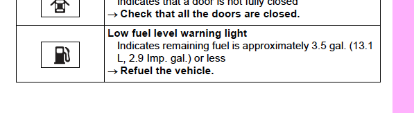

    I think you've answered your own questions, or at least the responses here are correct, but here's a quick recap.
    1) Capacity is 23 gal
    2) Light comes on before you reach "0", but it tells you have have "0 miles remaining"
    3) This is on purpose, both for (a) human engineering and (b) automotive engineering; humans are bad at making good decisions about matters such as refueling, safety, and redundancy, so lying to them is useful; the fuel pump in the fuel tank is cooled by the fuel itself and may overheat when fuel levels are low

    Second fill up: Low fuel warning light came on when the computer said I had 25 Miles Remaining. That was at about 300 miles since the prior fill up. I stopped for gas when the Miles Remaining read 7. The tank tool 20.25 gallons. Computer said I'd averaged 16.2 MPG. My calculation at the pump was 16.1. So dead on.
    So, my preliminary conclusion is that the low fuel light comes on when the computer reaches 25 miles remaining, and at that point there's actually about 3 gallons left in the tank. And when you hit zero miles remaining there's probably going to be roughly 2 gallons remaining. Also, the truck's MPG computer isn't a big fat liar.
