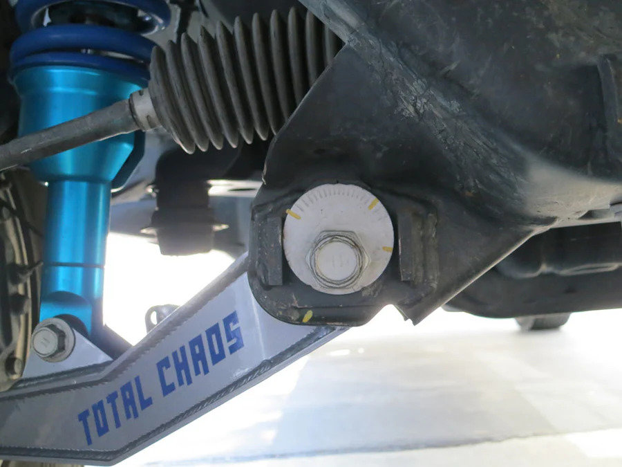

    2,688
    Just as a reference, the front and rear LCA cam bolts should be orientated to this postion give or take counter or clockwise adjustments.

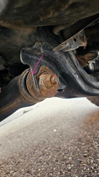

    #87
    2,688
    I had no issues on my 2011 or 2022 with rhe cam bolts as the tie rods and rack are above the bolts as shown in the pic
