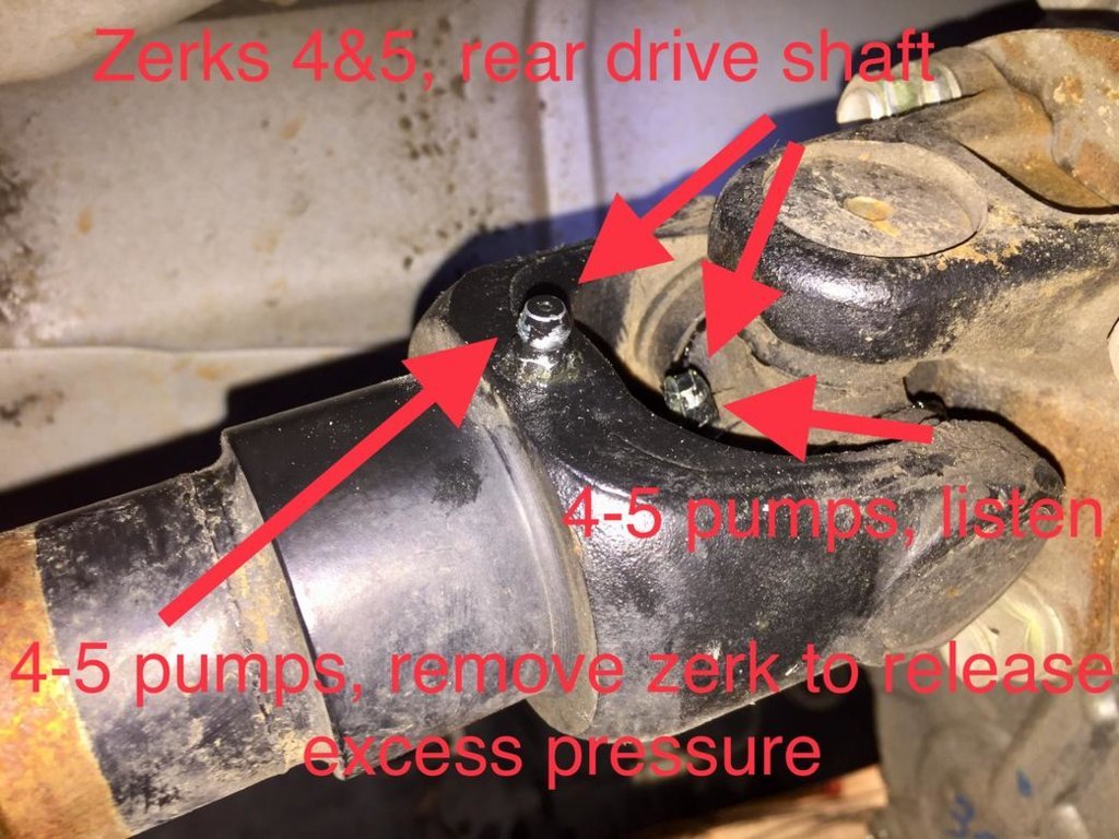

    Also, inspect this area around the zirks and where the shaft connects. There is flexing everytime it goes in/out of reverse. A little crack is all you need for this thing to give you problems.

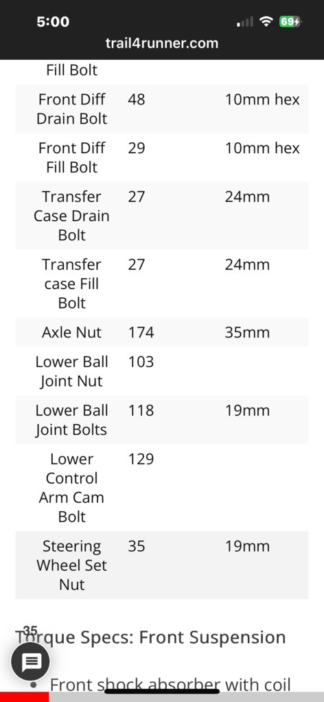

    3. Retorqued to spec: Sway bar bolts (30ft/lbs), LCAs (129*ft/lbs), UCA/Ball joint nut (150ft/lbs), UCA (85ft/lbs), Lower shock bolt (70ft/lbs). Test drove after retorquing each to isolate, clunk remained after each.

    LCA cam bolts are supposed to be 130 ft lbs

    Good catch! I re-retorqued them and amended my comment above. Clunk remains, and actually got worse (i've noticed this in the past when i've checked the torque on these). I may have gotten a video of the culprit though! Going to upload the video shortly once processed. Might be the LCA cam bolt itself slipping!
