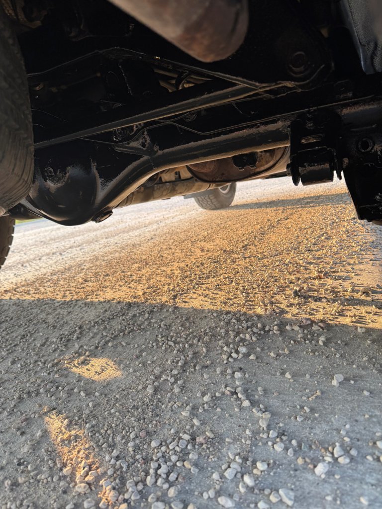

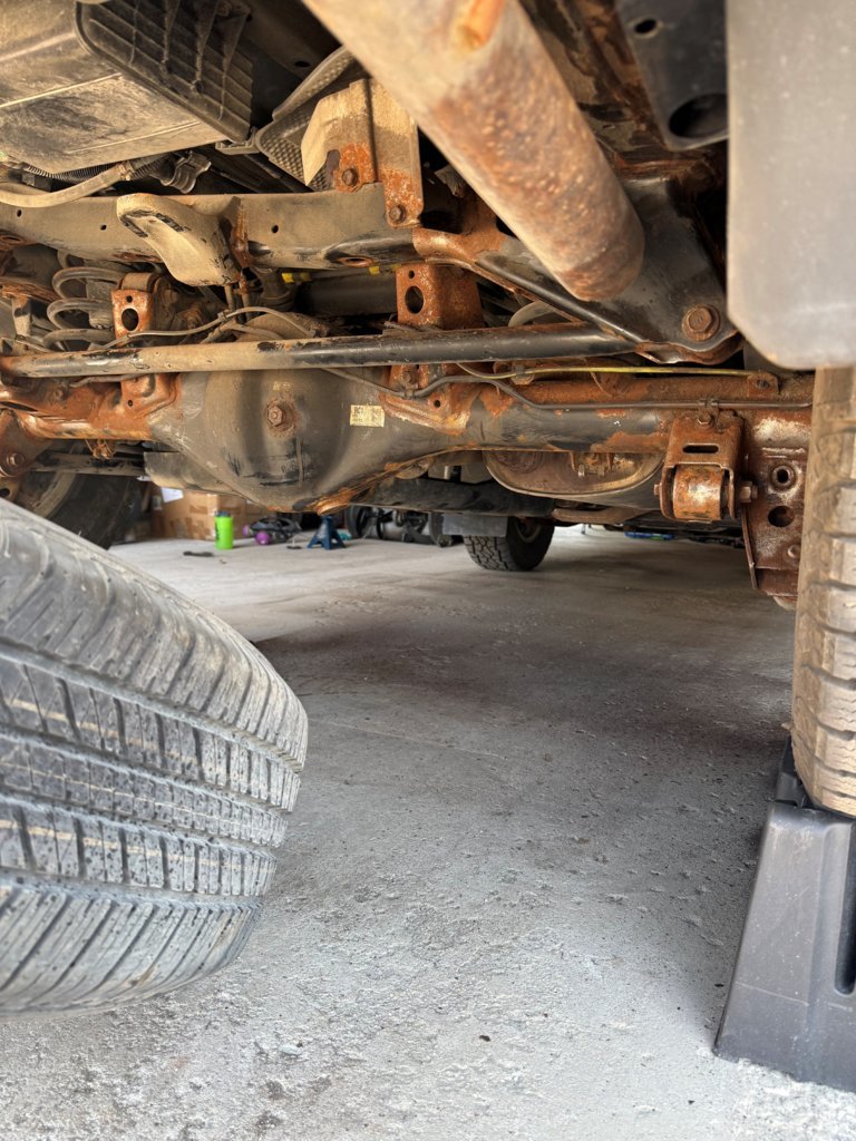

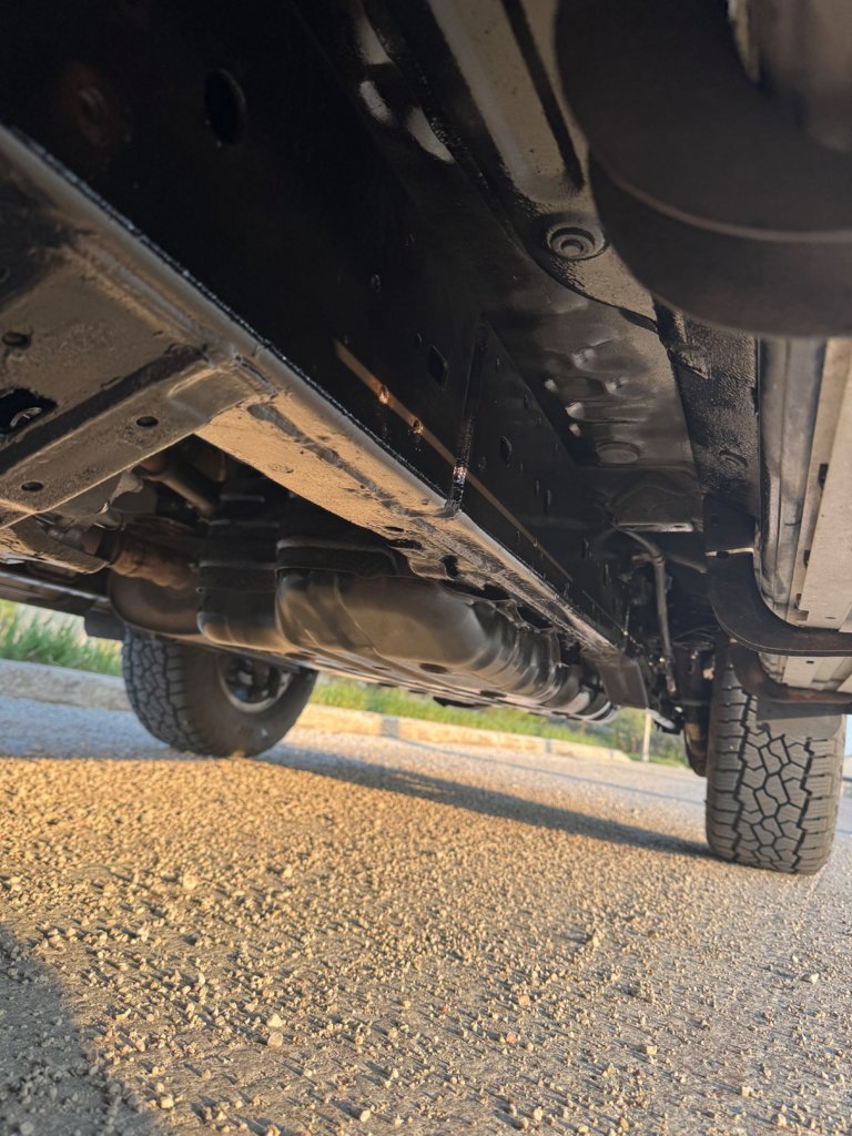

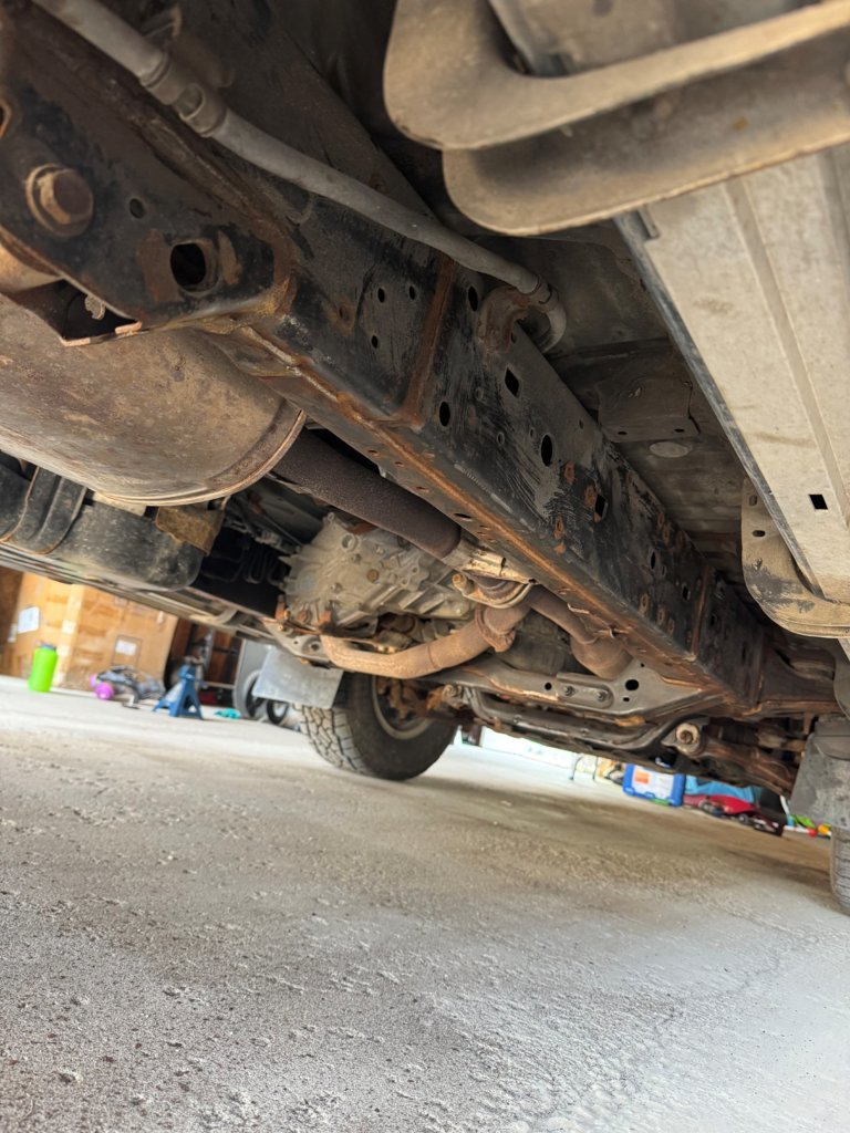

    Alright. Finally had some time to do a deep dive into this a bit further. A bit of a recap of events:
    Shortly after purchase i wanted to get some type of coating on the vehicle before the warmer winter weather. (Where i live they use sand for majority of winter, only when it gets warmer they'll switch to salt/sand combo) I was able to brush on fluid film from the can and use about 4 cans with a 360 wand to coat the inside of the frame rails/rocker panels. This coating held up very well, but without the proper surface prep fluid film could only do so much. Small areas of flaking would become exposed into the spring. Specifically the weld area and some spots on the rear axel.
    This initial coating provide me some peace of mind, but know i would do some more intensive prep this spring. After researching and taking @McSpazatron advice on not being too detailed or obsessive on it, i decided to use a combination of Salt Gone spray, metal gasket scraper, wire brush, wire wheel/angle grinder combo. wire wheel/drill combo. Really wanted to get a needle gun, but didn't have the desire to spend the money on getting one.
    This total project took about 12 hours over 3 days. I really didn't take enough pictures.
    Day 1: Starting to chip away at the rust (most time intensive 6-7 hrs) Very happy to find that all the rust was very early on it's development. With 1" gasket scraper and wire brush i went over most of the loose surface rust, lots of small scale came off and gave me a good chance to really poke around everything. Then started along with the wire wheel/angle grinder working along the welds, rear axle, control arms. This brought a lot of areas down to the bare steel. While good to see no big issues i want to be mindful and not remove too much of the factory coating unnecessarily. The wire wheel/drill was great for getting into the tighter spots that the angle grinder could not.
    Day 2: Under side salt spray (1-2hrs). This was probably the least impactful step, however it provided peace of mind knowing i was clearing out all possible contaminates before applying fluid film. Purchased a bottle of "Salt Gone" from Amazon, it attaches directly to the hose and distributes the product while spraying. I specifically chose those product through reading forms mentioning that it would not remove existing coatings of fluid film or other biased coatings. Sprayed and rinsed off thoroughly, let dry with a highway drive and sitting over night.
    Day 3: Fluid film application (3-4hrs). I used 10 cans total, 4 for inside the frame and holes, 6 for the exterior of the underside. I've always used fluid film clear, but deiced on using black this time. Beginning with the 360 wand i applied to every hole on the underside and inside the frame rails/rad support/ spare tire holder etc. With my previous inner frame rail coating a few months back i felt really good about the "inside" of things having a really good coating. One plus to using black fluid film is you can definitely tell where you have and haven't sprayed. I decided against painting the sanded surfaces as there was no way i was going to get all the rust off and i didn't want to trap any of it under paint. I've seen the build up layer that fluid film creates over the years and I'm confident it would protect the exposed areas. On ramps starting from the rear, i worked my up spraying all the metal surfaces. Very happy with how the coating turned out.
    The pictures I'm uploading are of post surface prep and obviously post spray, prior to the drive down a gravel road.
    ChessGuy, bancroftdg and Sin4R like this.
