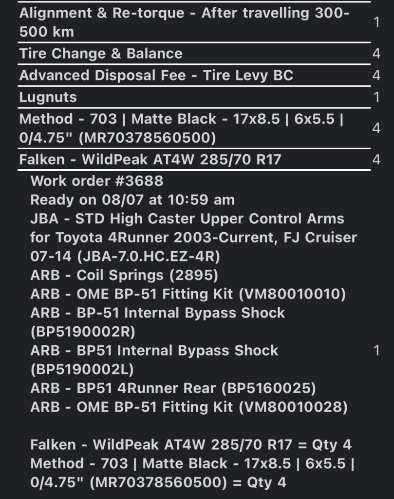

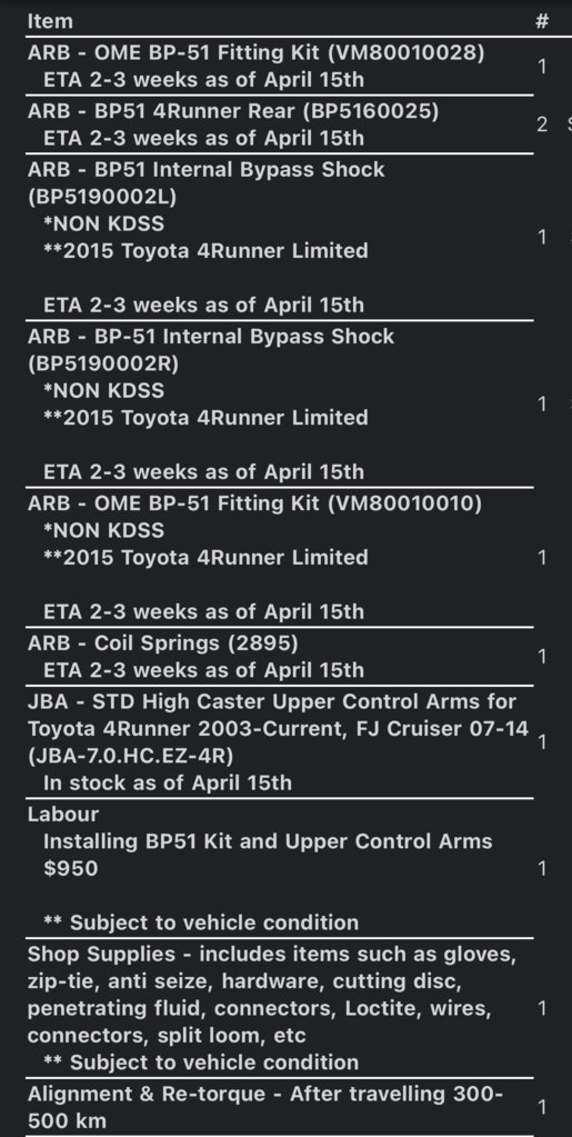

    It was the shop, I think they added the kit. Here are all the items they mentioned in the invoice.

    I tried looking up some part numbers on the ARB/OME BP-51 coils. Their descriptions were really vague and convoluted and I couldn't make much sense of expected lift height from each coil option they had in the time I had.
    If I were you, I'd go back to the shop that installed this and tell them you you'd like less lift, if possible. For the front, that probably means adjusting the front shocks down (if there's room). For the back, that probably means replacing the rear coil with either a smaller lift coil and/or one with a lighter load rating. The rear coils do not have to be OME either. They can put on any rear coil that meets your preference on lift height and load rating. Bilstein, Eibach, and Dobinson all make rear lift coils for our trucks that are worth checking out.
    All the expensive components (the shocks) can remain in place. They will work with these adjustments.
    But talk to your shop first to discuss these possibilities.

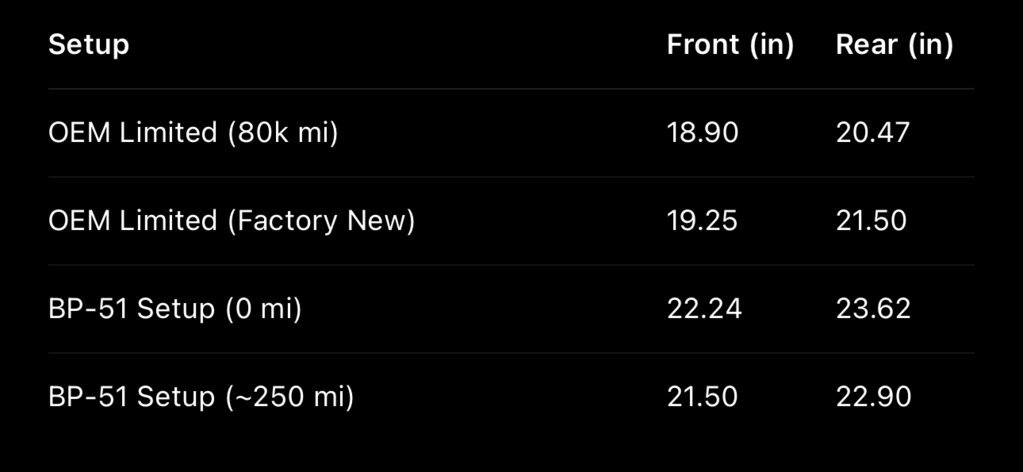

    Update: Drove ~250mi
    Suspension Height Summary (Hub-to-Fender Measurements)
    The BP-51 setup has begun to settle after ~250 miles, showing a reduction of 0.74″ front and 0.72″ rear from initial post-install measurements. The current lift over factory-new Limited height is approximately +2.25″ front and +1.4″ rear
  8. Jul 15, 2025 at 11:19 AM
    4,997
    Well that settled significantly.
    Are you happier with the way it looks now?

    Yes, I’m feeling better now compared to when it had 0 miles. I can now fit it in the garage (which has a max height of 6 ft 10 in) with the Pelican case on top.
    I’ll share some pictures soon—would be great if it settles another 0.5 inch

    Looks good. Load up the back for a few days ride around and these will settle a little more. You will get use to this new look.
