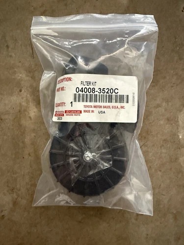

    Yes, Toyota sells a repair kit, it was intended for the 2nd gen tacoma. It is not VIN specific. Includes the cover and another filter, availability appears to vary between sites.

    Got it!
    #04008-3520C
    $25 and change at my local dealer.

    I am confused what the repair kit actually repairs. What ive heard is that sponge gets sucked down into the pump which destroys the pump, hence why everyone switches to the uni-filter

    FYI, as I was poking around the internet, I found a couple parts departments that are no longer selling 04008-3520C. There is a message:
    "Not for Sale"
    "No Longer Available For Purchase"
    But I also found quite a few that list the part available and I was able to put it in the cart and get to checkout. I just didn't pull the trigger on a sale.
    So... don't really know what that means. Maybe if you want one it might be prudent to get it sooner rather than later.

    Yea, at best I think it would be a way to proactively replace the filter before the material breaks down for less than the cost of the entire pump assembly. The lid wouldn't be needed. I suppose the rubber gasket in the lid could dry up over time too...

    This kit was part of a recall or TSB involving 1GR powered second gen Tacomas. I have not heard of a 5th gen 4Runner having this issue but the kit looks like it would fit if folks are worried about the foam degrading.

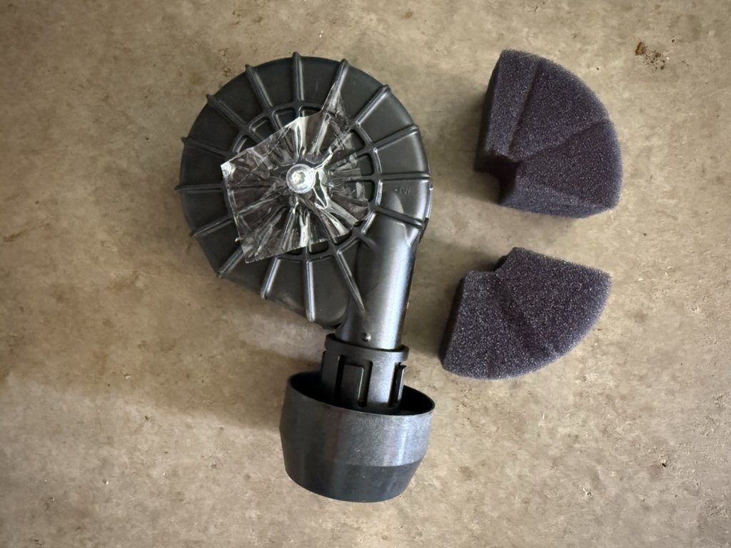

    I did this mod just to eliminate risk, the issue i had was the plastic housing fell apart in some areas, nothing foil tape couldn't fix.
    I used K&N 62-1370.
    If anyone has the housing part code, that would be great, it does irk me knowing its broken.

    This sounds more like the reason. It was for a limited number of of vehicles and that TSB has pretty much run it's course and going forward - when they're out, they're out.
