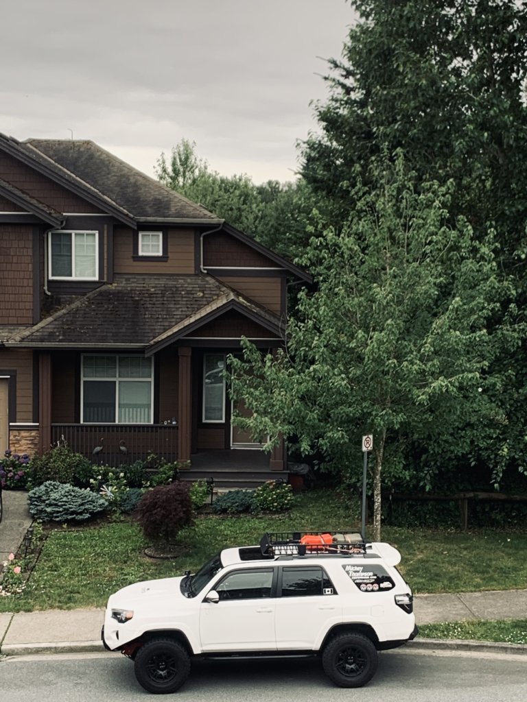

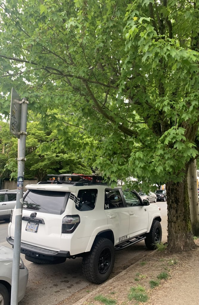

    My 4R parked, patiently waiting for me throughout the work week.

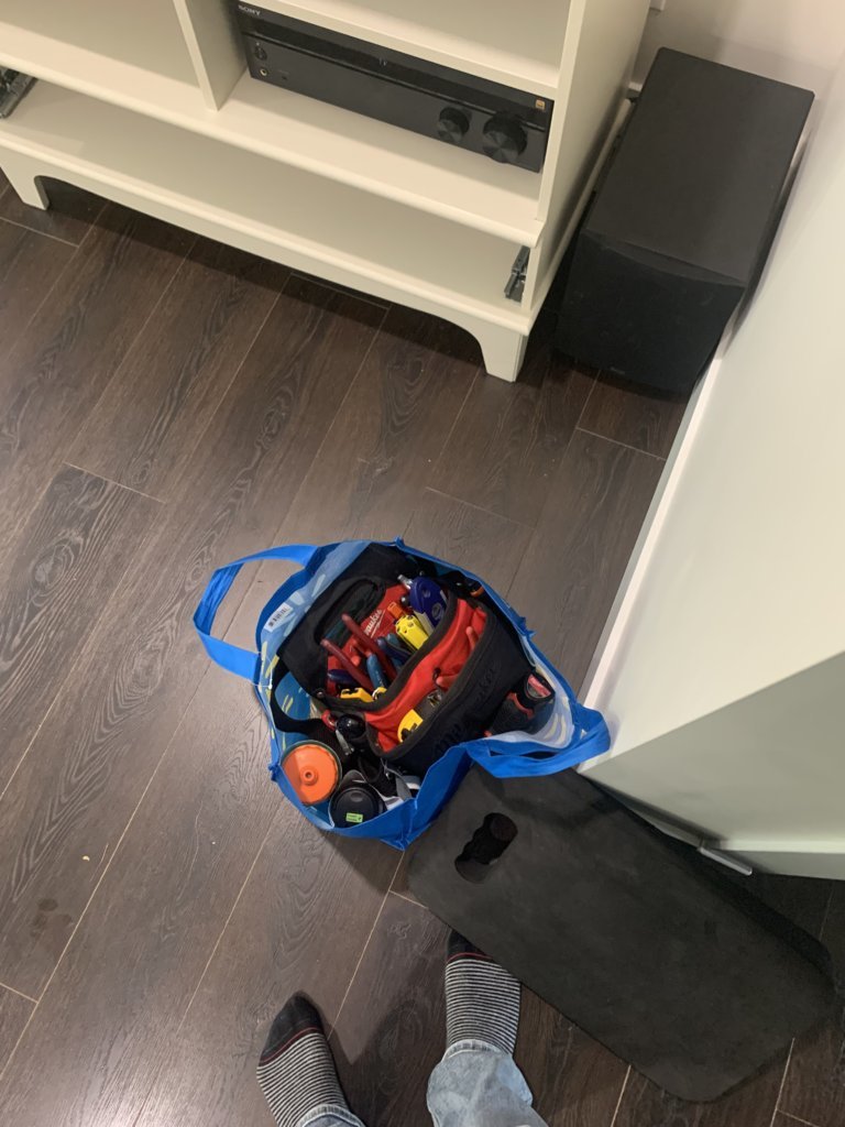

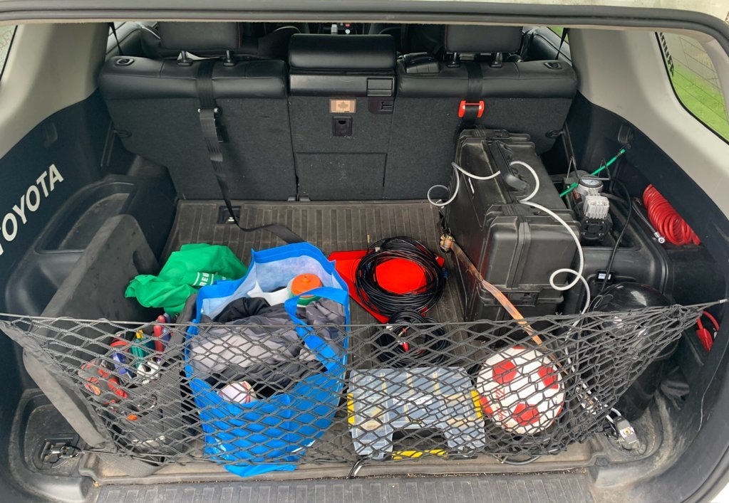

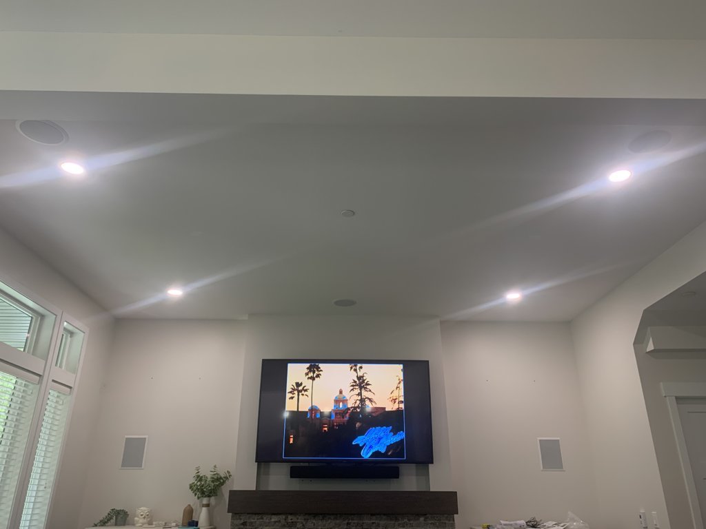

    Used 4R to transport tools & materials, installed 7.1 system in my brothers new house

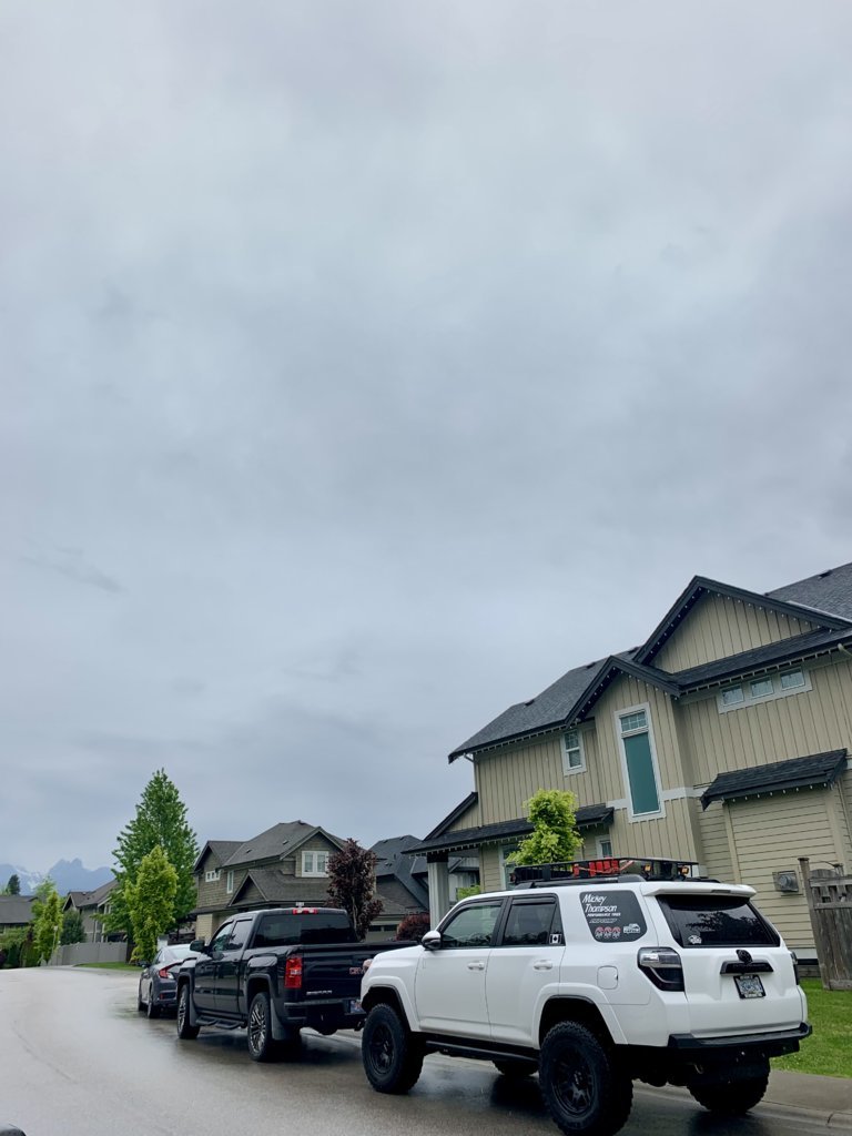

    Drove some of the fam to down to Vancouver for surprise birthday party

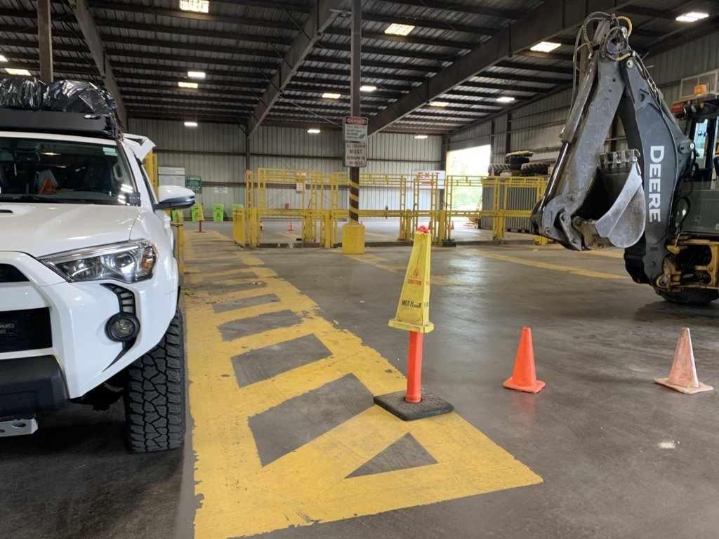

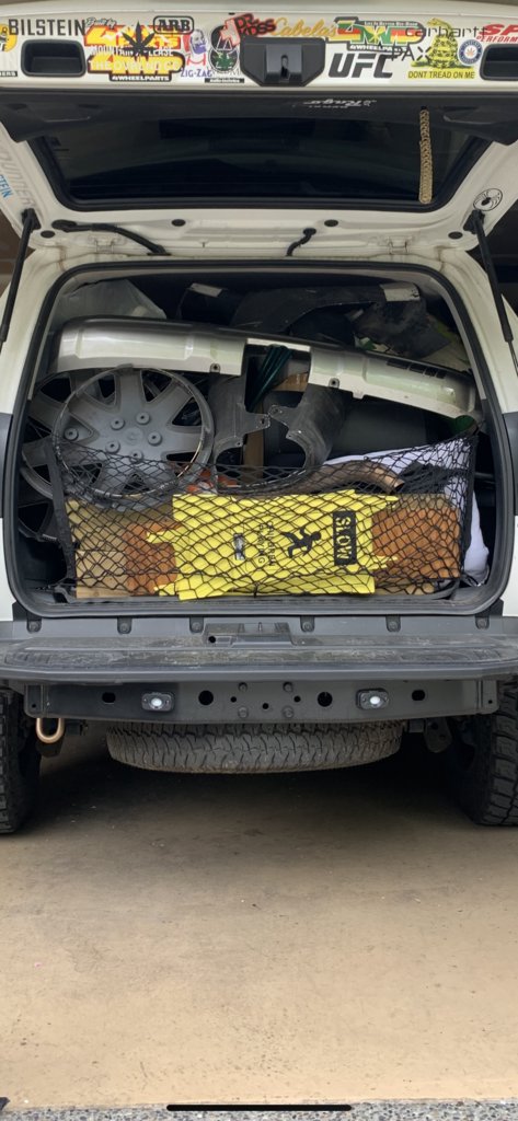

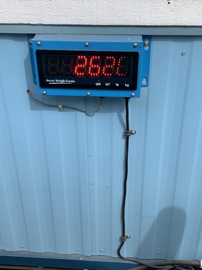

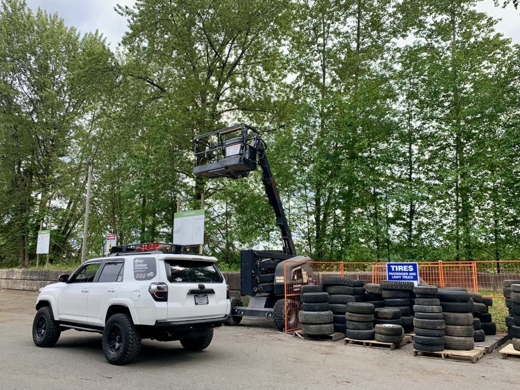

    dump run w/ family

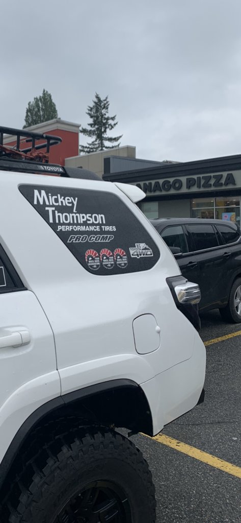

    used 4r to pick up pizza for the family. My wife requested her favourite pizza, as today is our 5yr wedding anniversary. I stopped really quick to wash the wheels on the way.

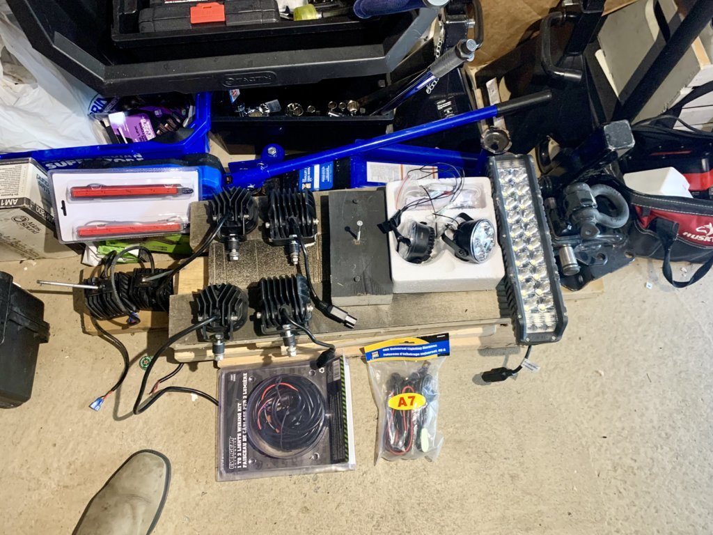

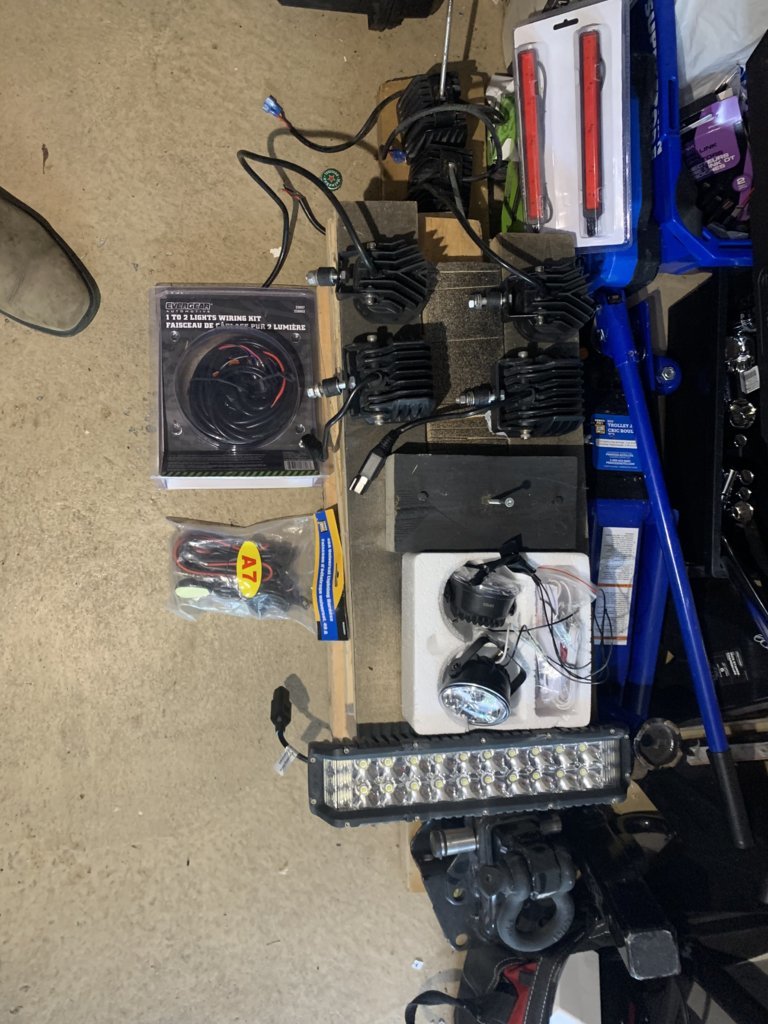

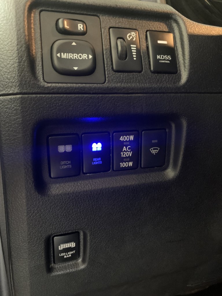

    most of my lighting b-stock

    No artificial colors or flavors….
    …says the EasterEgg pizza shop
    major side note:
    Congrats on the 5 years bud
    Pizza for anniversary is a win!
    Chill on the pastels
  12. May 20, 2025 at 7:05 PM
    #312
    djwantke [OP] New Member
    5,711
    Bought brand new 2016 After May 2021: -Approx 3" lift/level: Bilstein 5100's, OME 2884 590lb 3" front lift springs, SPC UCA's, ICON 158506 2" lift rear coils, diff drop -Mickey Thompson Baja ATZ LT285/70R17 Load E -Mickey Thompson Sidebiter ll 17x9, 0 offset, 5 backspace -Pro Comp black spline lugs ^installed by 4WheelParts^ -New brakes and rotors by brake shop -4-piece ARB skid kit -Smittybilt 2" nerf steps -MBRP black exhaust tip, chopped OEM -Drivers side OEM FJ oh shit handle -All blacked out emblems -Blacked out roof rails -4x WeatherTech window rain guards -OEM custom rear mud flap deletes -KICK BACK MUD FLAPS 12" WIDE - BLACK TOP AND BLACK WEIGHT -FRAM EXTRA GUARD CA10835 engine air filter -1797 LED tricolor fog bulbs Yellow 3000K White 6000K Blue 15000K 28W 4000LM -Armour paint lower rear bumper -Front bumper high stage high clearance cut -Fenders cut straight across, pink reservoir sprayed black -4Runner Lifestyle sequential fog fangs -4Runner Lifestyle smoked taillight decals -Pedal Commander -Rear passenger cargo mounted 120v truck tire pump -4x Spidertrax 1.25" black aluminum wheel spacers -Yota Twins Paracord Hatch Strap sand camo -Teton Workshop hard anodized matte black aluminum shift knob -Ditch flood lights 4 LED 20w 1400lm w/ OEM hood mounts on OEM style dash switch -Backup flood lights under bumper 6 LED 18w 1500lm on OEM style dash switch -Body Mount Chop; cut, weld, paint -Fender mount chop, re-weld, paint -Fender Liner cut behind wheel (I cut liner in front of wheel clean off at top of viper cut) -Wheel well firewall hammering, painting ^done by Arc One Industries^ -valance cap trim -Agency6 Black Shackle Block 2" US Certified 6061 T6 CNC machined aluminum -DRT fab universal hitch skid -ACDelco inner tie rods, outer tie rods, bellows -Full Dr. KDSS switch kit -March 31 Behind grille 13-1/4" 32 LED light bar + wide-angle, eagle-eye lens 6000lm on OEM style dash switch -RAA Powder coated steel roof rack cargo basket, 1" side rails, 64" x 39" x 6", 250lb limit -roof gas can, water can, shovel -PEAKTOW PTT0063 Hitch Mount Cargo Carrier 51-1/2 x 17-1/2 x 4 inches 500 lbs. Capacity (trips only) -July/2023: purchased first needed SPC balljoint replacement kit - newly released, upgraded non-zerk sealed joints 25002 -July 15/2023: The Original Universal EZ Flares, 1". All four corners -Dec. 2023: removed bumper cover and crash bar, drilled frame, installed Apex Overland KDSS Recovery Points -Jan. 2024: SPC balljoint replacement kit - upgraded non-zerk sealed joint design 25002 -Jan. 2024: custom installed 2lb fire extinguisher between drivers seat and door -Feb. 2024: swapped interior lighting to diode dynamics led’s -Feb. 3/ 2024: 4x KC Wire Hiders, for roof rack lighting -Feb. 13/2024: double ditch lights, on new Rago Fabrication Extension brackets. -3inch Quad Row Amber Pods from LED-Club. 32W 3200Lm 16-LED Spot Beam. Existing: 3inch EVERGEAR clear lens LED pods -May 2024: custom black aluminum grille mesh installed in front of factory plastic -June 2024: custom built powder coated dom sliders -Nov. 2024: thermo-plastic rear mudflaps -Dec. 2024: rear bumper cover clearance cut, sprayed newly exposed parts black -Jan. 2025: trailer hitch removal, relocation of rear led pods to crossmember New: -Exhaust pipe chop after axle -March 2025: new SPC upper control arms, bushings, balljoints. Raised front end 0.75” via Bilstein 5100 spring seat. -April 2025: Evergear bezel-less cube ditch lights 4 LEDs 40W 3.33A 4800Lm 328’ beam distance 30° 6000k beam angle shatter & crack resistant lens -April 2025: Evergear Ultra Series light bar 27-3/4” flood spot combo 60 LEDs 60W 5A 6000Lm 1227’ beam distance Dual row, dual beam angle 30°/60° April 2025: BULLY Rock Crawler Hi-Intensity LED Utility Lights, Pair 1260 lumens @ 15w (3 x 5w CREE) each 120° flood beam waterproof, dustproof. Under hood: -Blue Fire 6-Circuit Fuse Block w/ LED Indicator & Protection Cover -Blue Sea 100A Circuit Breaker w/ reset lever In progress/in the garage queue: ~ Wanted - 80% OFFROAD Hitch Replacement Recovery Point, PerryParts or Wheelers bump stops, 1" body lift, custom dom front bumper, winch, rear dom bumper with side hoops, kdss angle correction, C or D load 35’s, bolt on cat shields
    Right, not a huge fan of the pizza boxes either, they got good pizza and cheddar jalapeño dips tho HAHA
    Thanks for the congrats

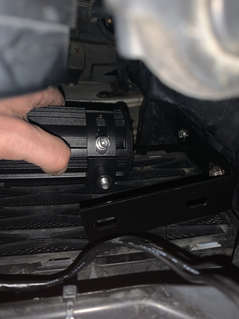

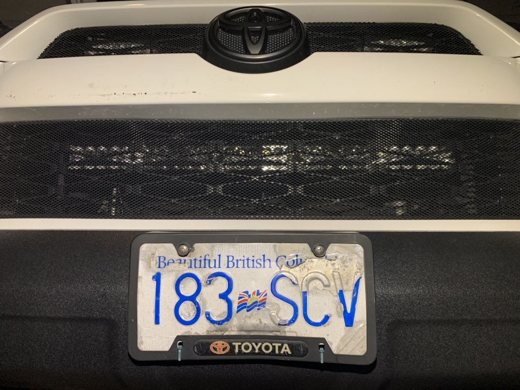

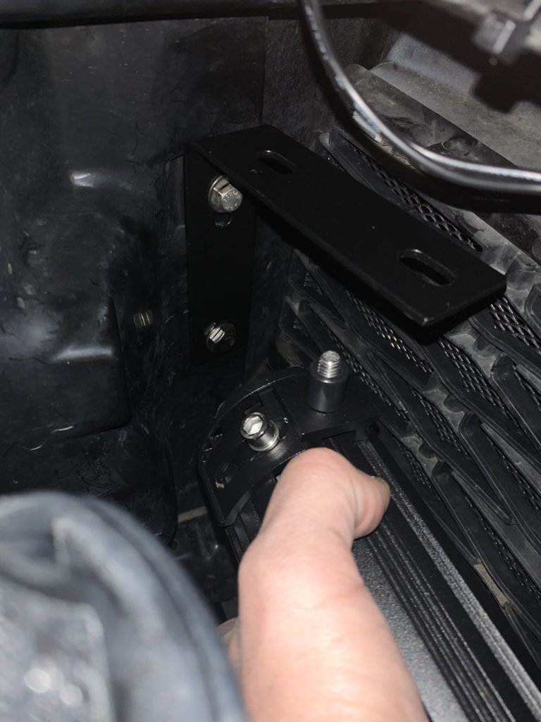

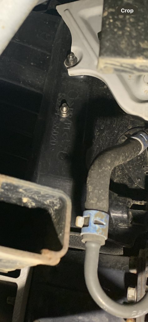

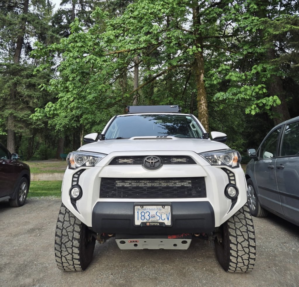

    diy grill lightbar brackets installed

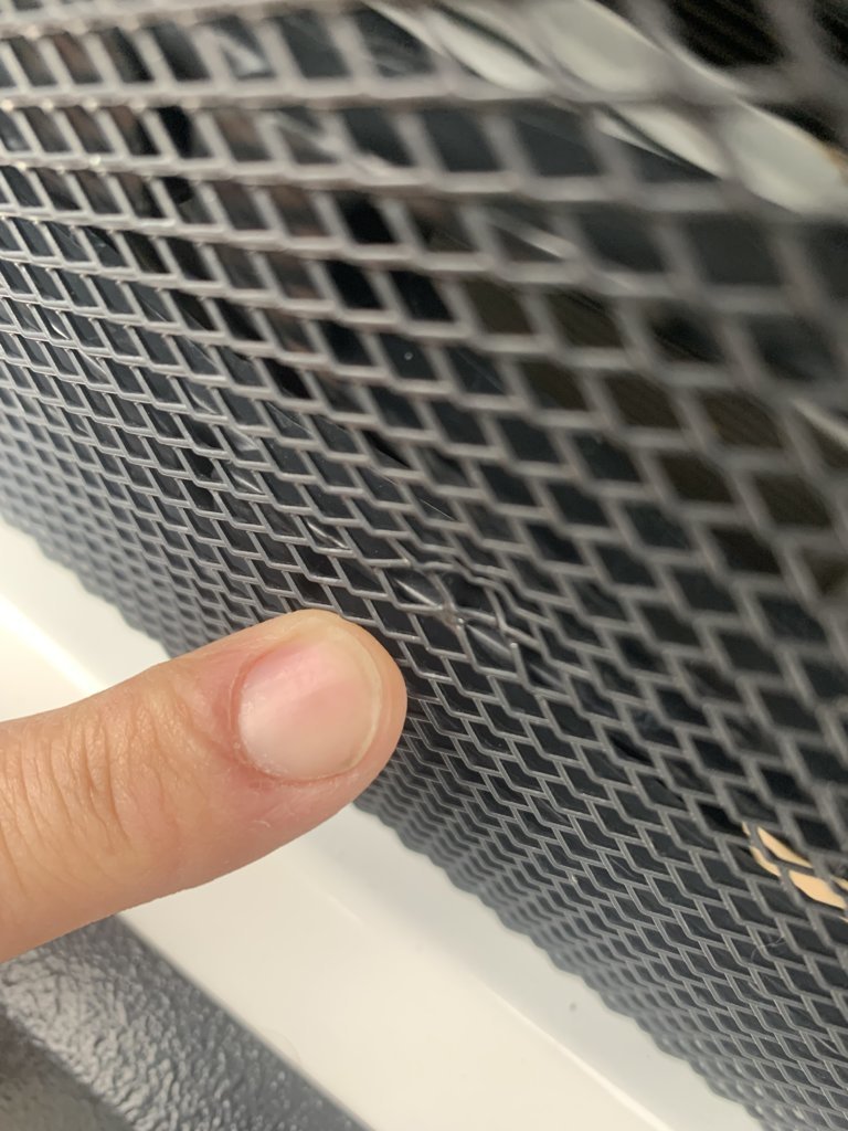

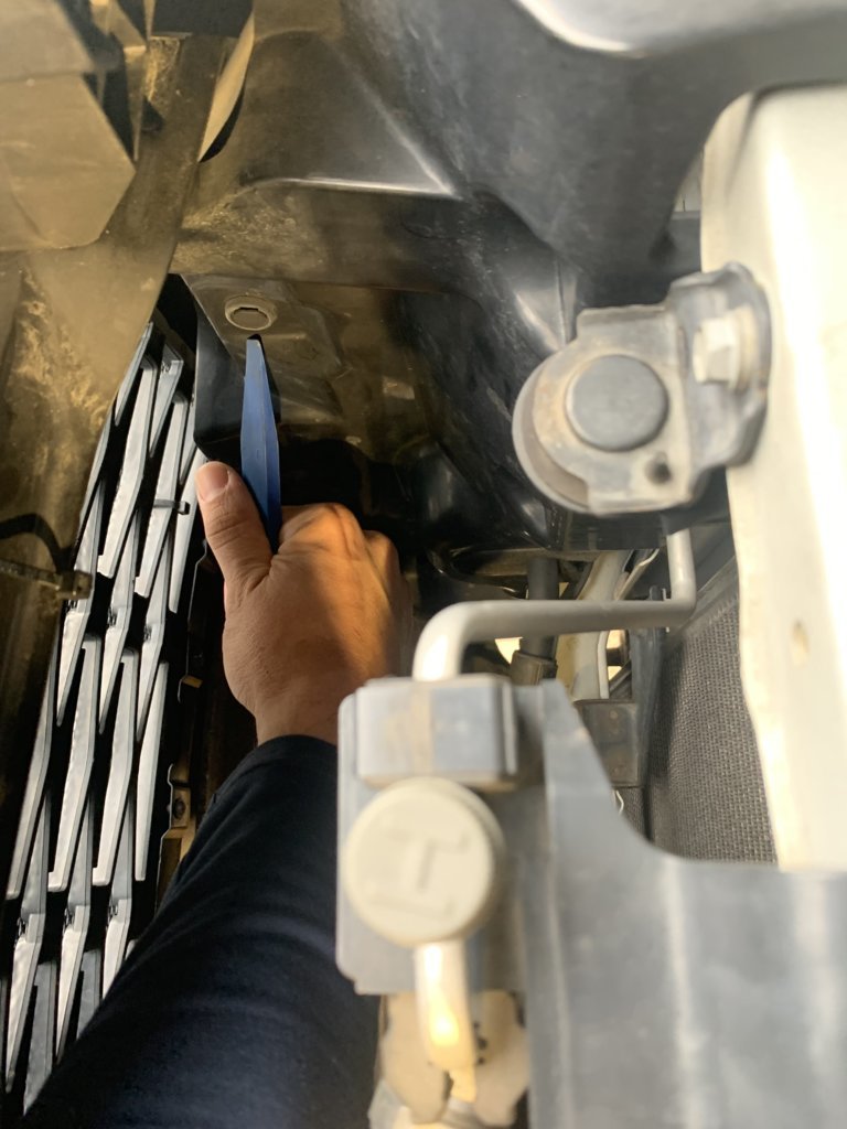

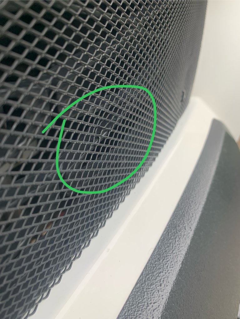

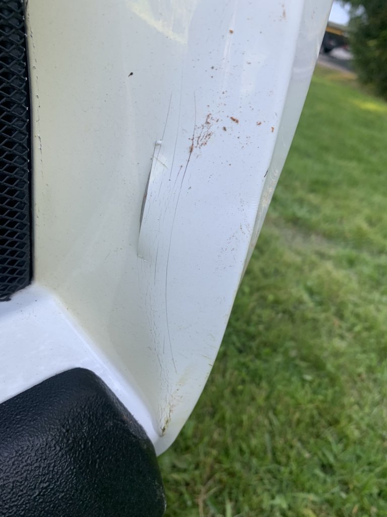

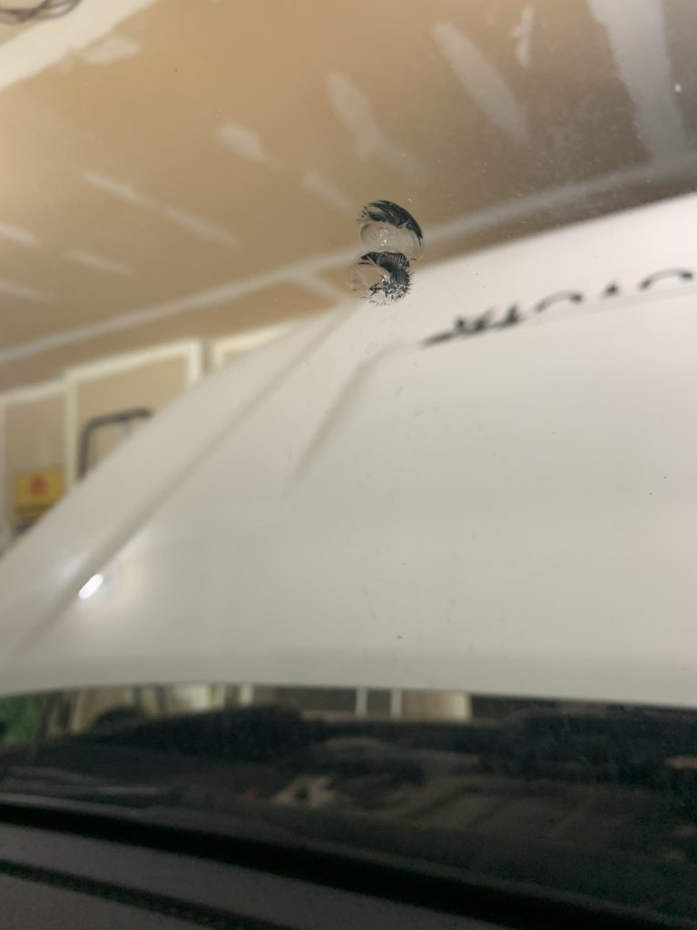

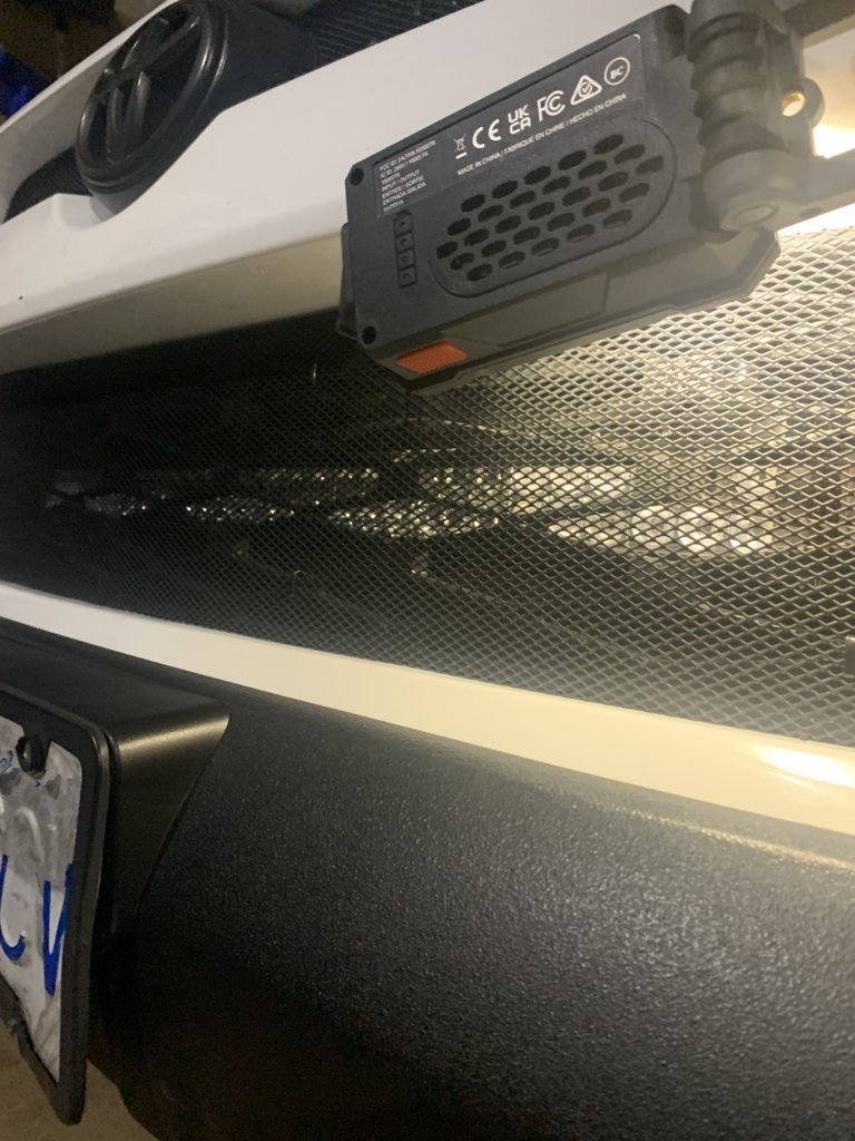

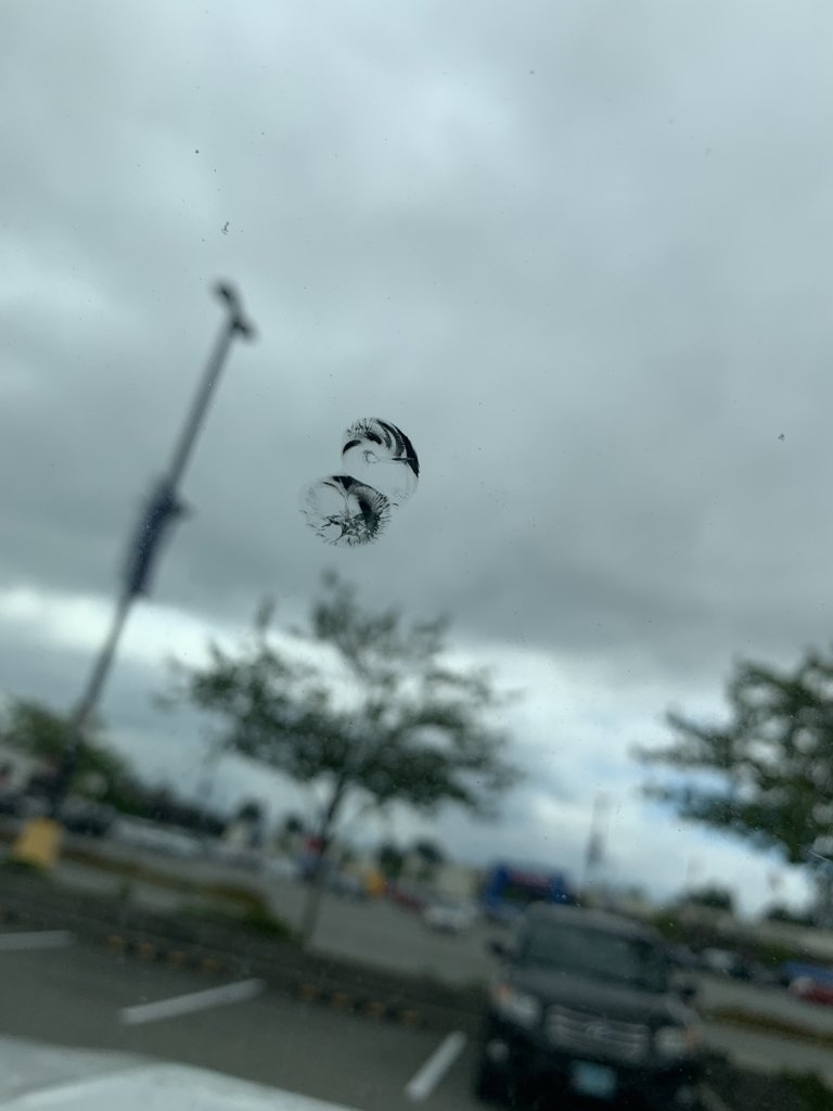

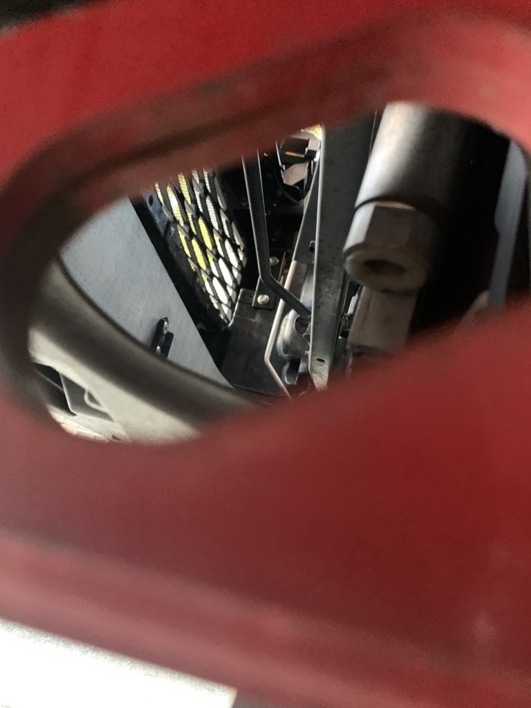

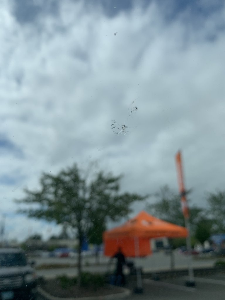

    I got pelted in the front end real good on the fsr from a passer by in a side-by-side.
    At least one rock struck the windshield.
    I stopped and looked but couldn’t find more damage.
    Pretty sure I just located the mystery point of impact..dented in my metal grill mesh!

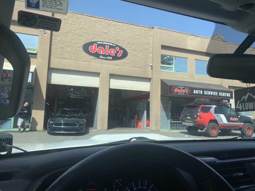

    going up on the lift today

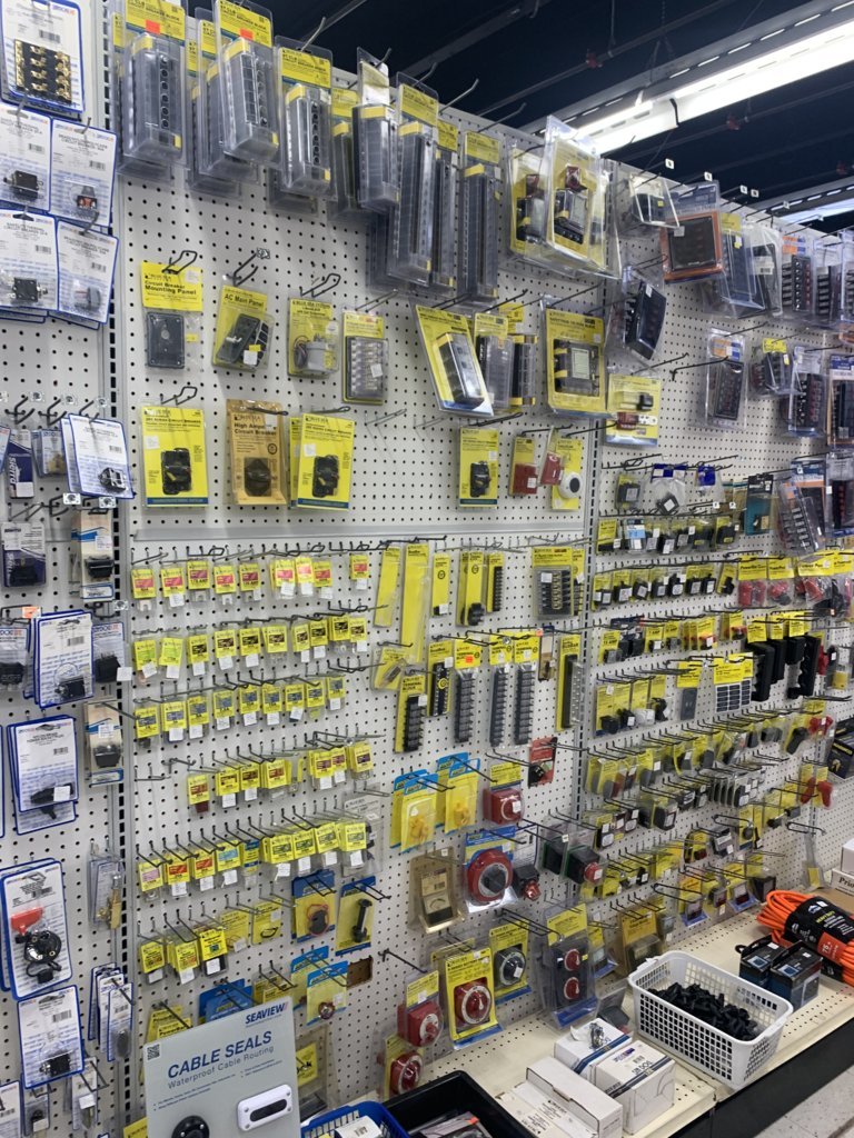

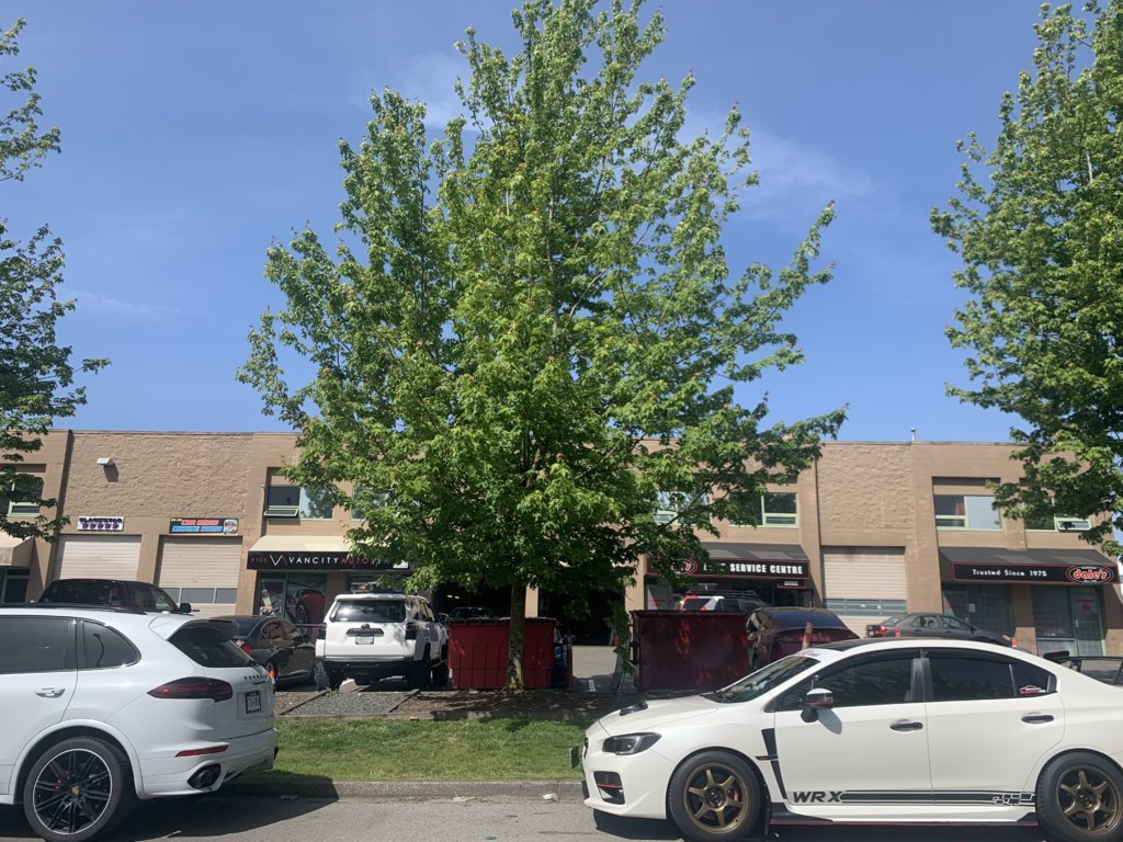

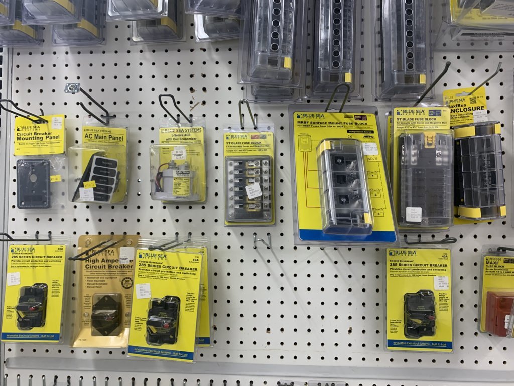

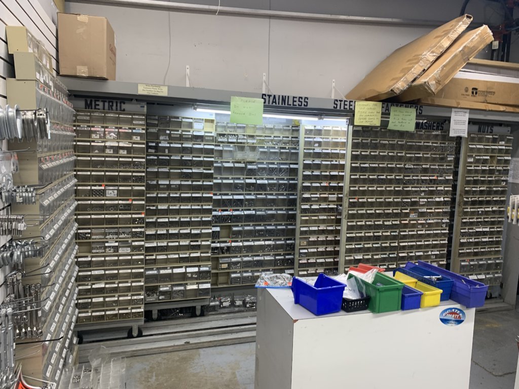

    shopping for stainless at a killer marine hardware store.
    killing time while truck suspension I gets the shop inspection.
    check out the sea of Blue Sea Systems products.

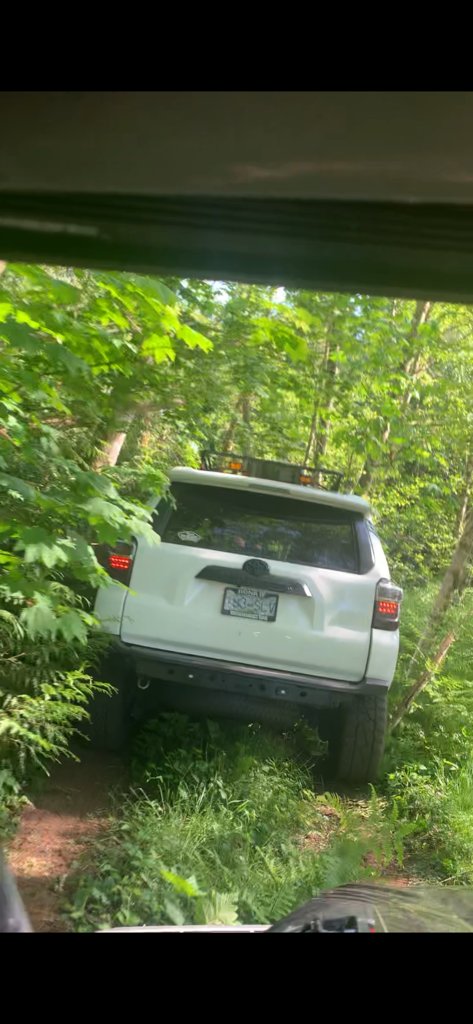

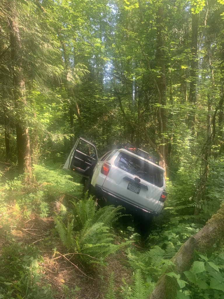

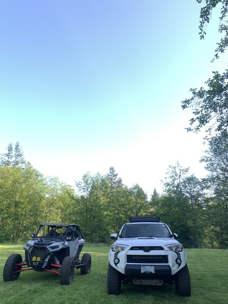

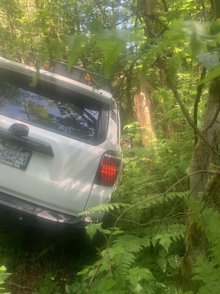

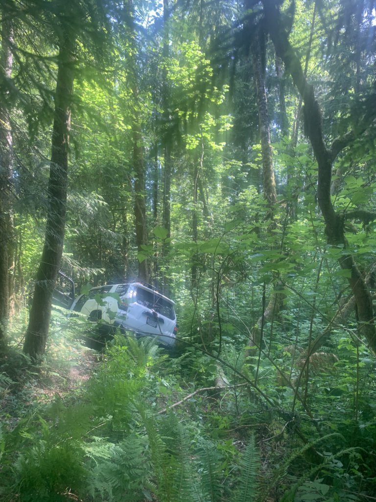

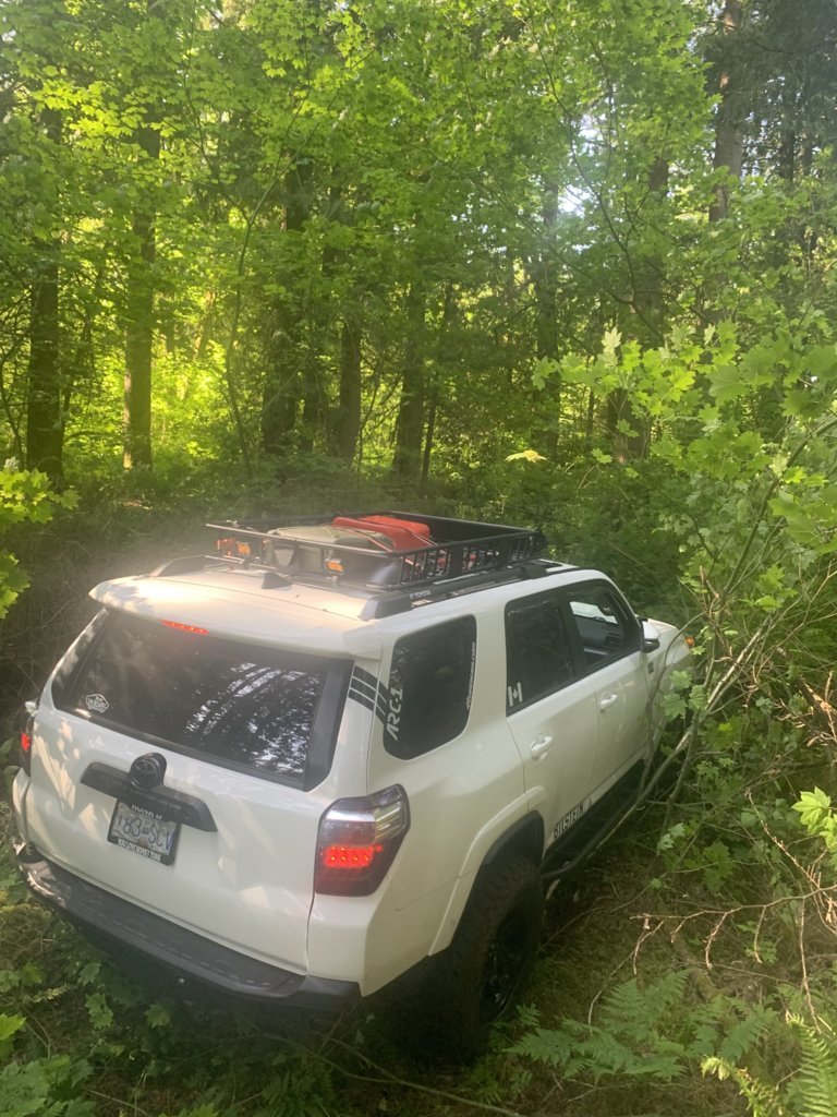

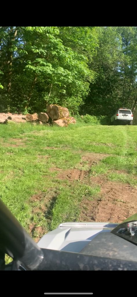

    wheeling at my father/& brother in-laws property this last weekend.

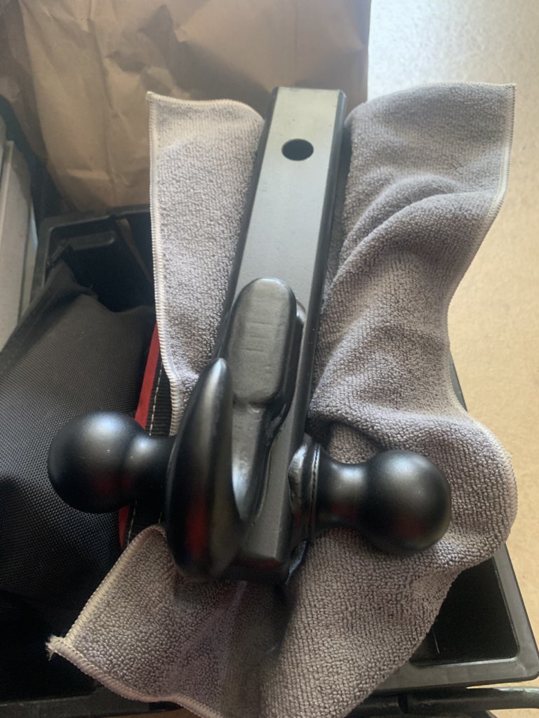

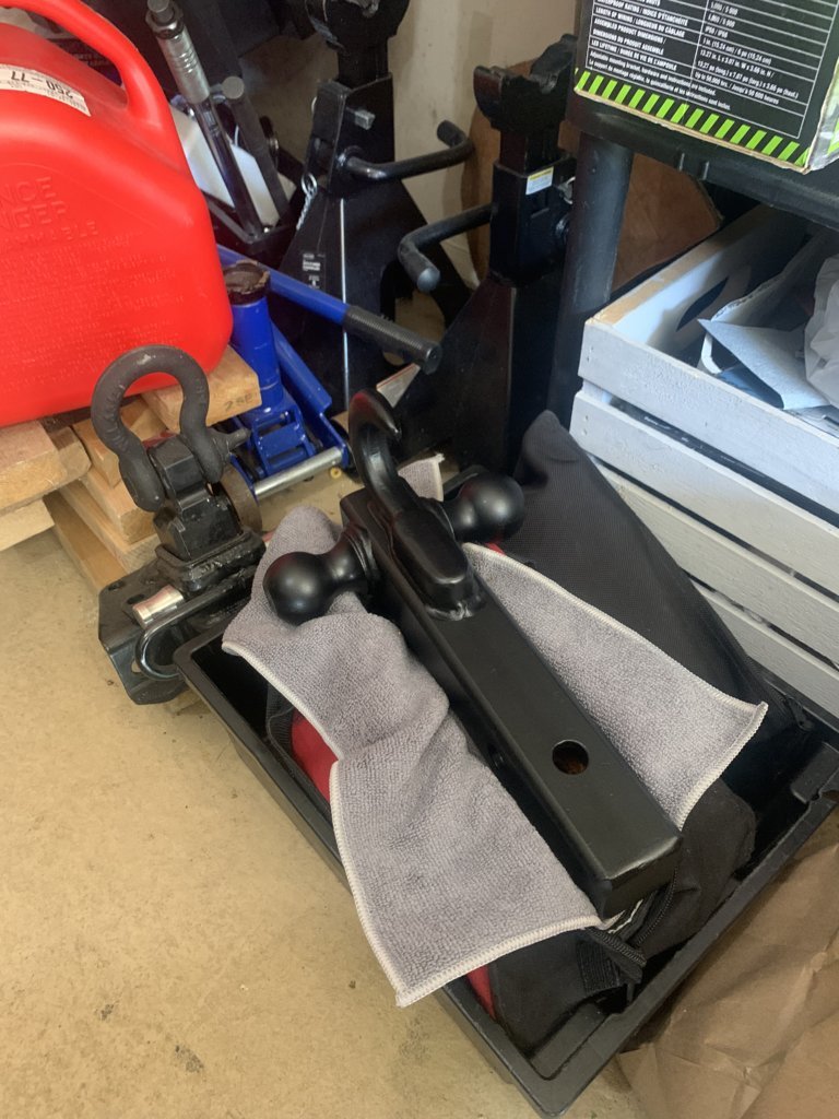

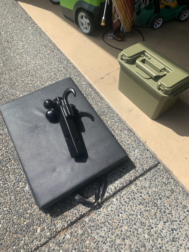

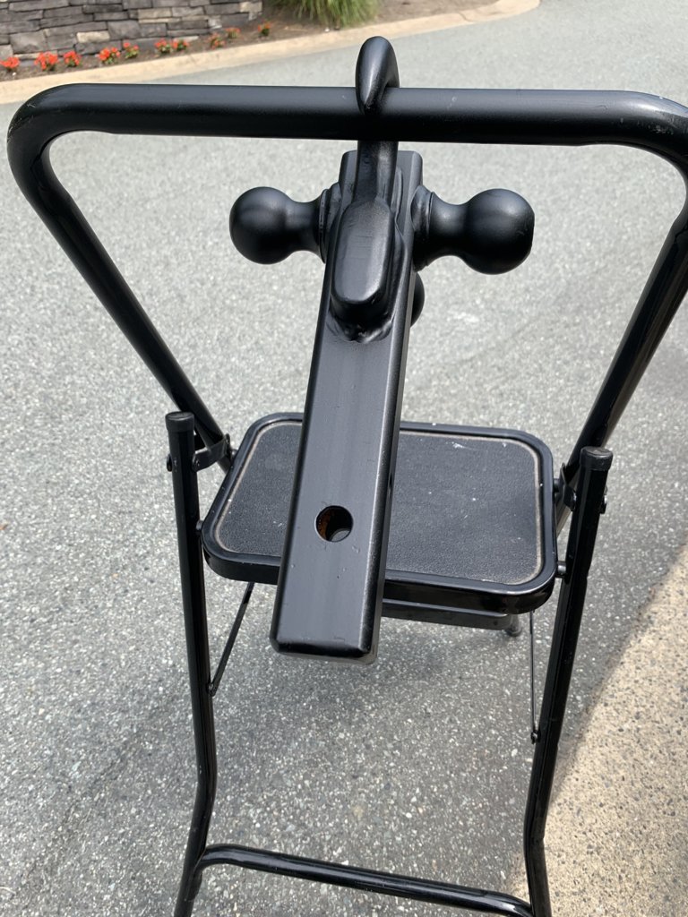

    painted the big black hitch
    gunna off-load it on fb marketplace

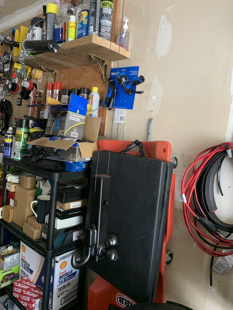

    paint done

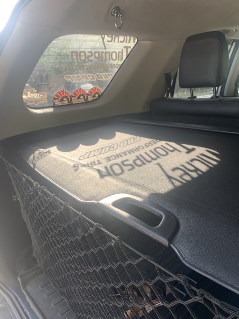

    cool shadow just now

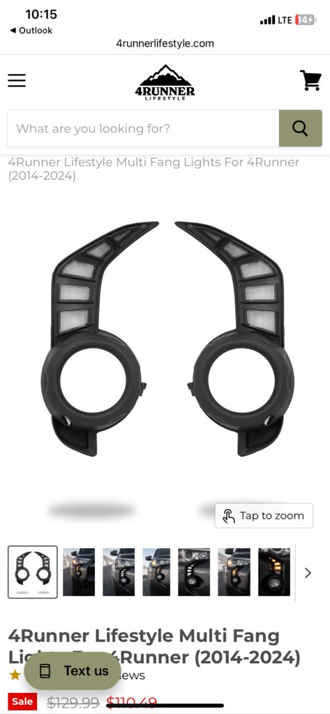

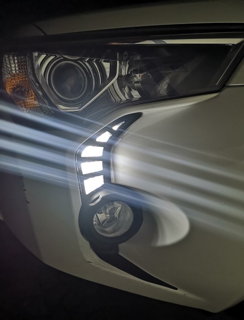

    surprised I’ve gotten almost 3 years out of the sequential switchbacks, considering I run them as drl’s

    I got those too. Although I am not as excited about them as I used to be. I wonder if these things are a battery drain parasite along with the kraptor...lights.
  26. Jun 29, 2025 at 2:51 PM
    #326
    5,711
    Is that right eh, I hear ya. Except I’m actually perfectly content with them, and luckily for me, all my 4runnerlifestyle purchases have been OK
    Aiden James ain’t perfect either I’ve seen now

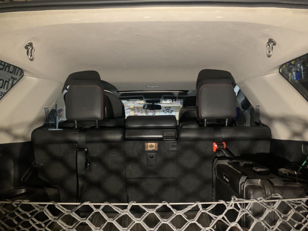

    new rear cargo area tie downs:
    Local Marine Hardware Supplier (specialty stainless metric items)
    Store: Steveston Marine & Hardware
    •(2) M6 stainless shouldered eye bolt (1/2” I.N.). 6mm x 2-1/2”
    Brand: Sea-Dog [Quality Marine Gear]
    https://sea-dog.com/
    •(2) M6 large stainless fender washer
    •(2) M6 stainless lock washer
    •(2) 5/16” captain pin stainless bow shackle
    Brand: Cruiser Hardware (Product of Spain)
    Store: Home Depot
    •(2) 3/8” rubber split grommet inside the eyelet
    •(4) 1/4” rubber split grommet on the shackle pin

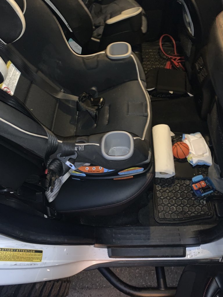

    installed a skookum new toddler car seat:
    rear cargo whee well tie down points:
    got my hands on 304 stainless shouldered m6 eyebolts (low profile) - installed utilizing factory holes on rear cargo inner wheel wells, for hooks and shackles to fasten to. friggin fit perfect. test fitted assorted d-rings as well but didn’t like the inevitable rattling.

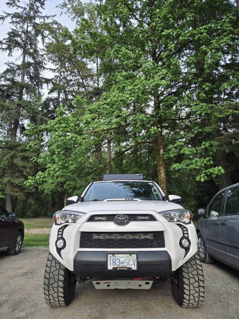

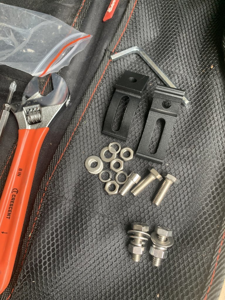

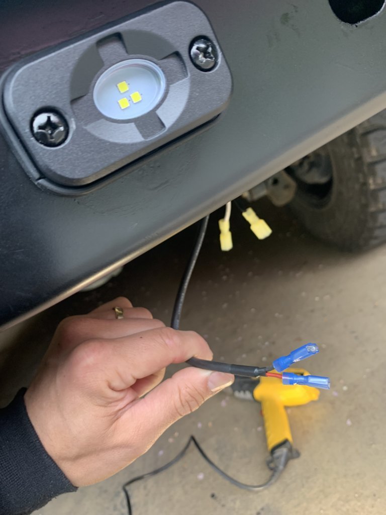

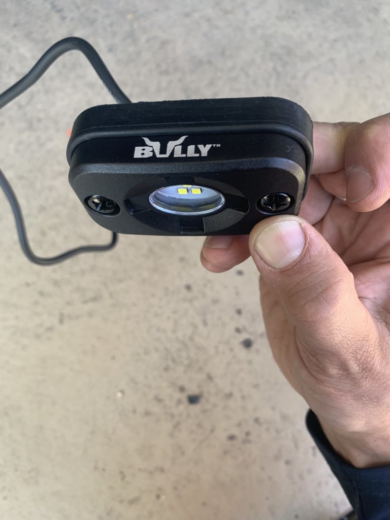

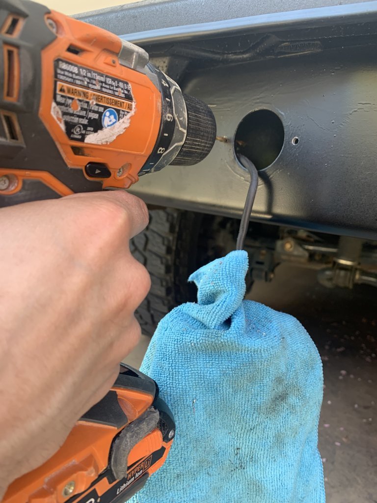

    recent mods+maintenance completions:
    continued
    reverse rock lights

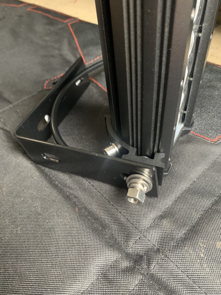

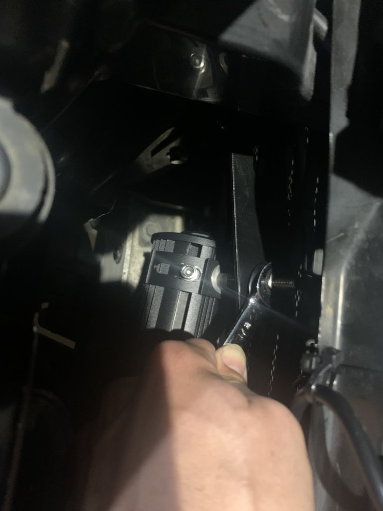

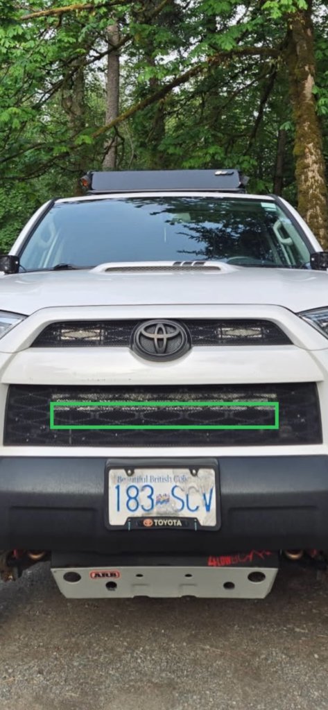

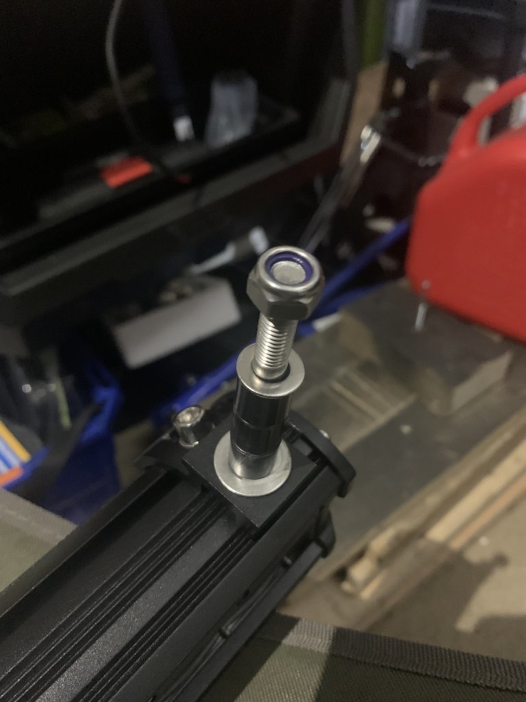

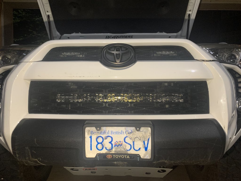

    sourced nylon spacers to lower 27” light bar down to perfect center in lower grill (on custom L-brackets)
    marine supplier:
    Stainless M8x80mm (2)
    Stainless M8 flat washers (6)
    Stainless M8 lock washers (2)
    Stainless nylon nut (2)
    Spacers from a TV mounting bracket (6)
    ^used these on ditch light brackets

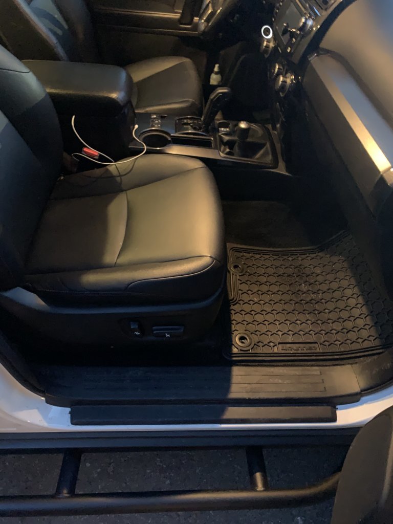

    Interior

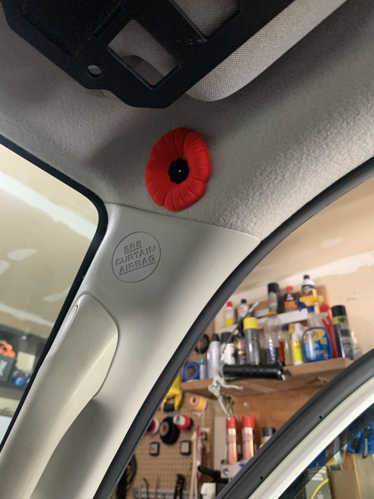

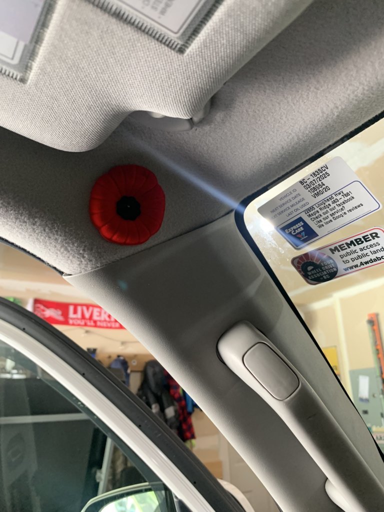

    Poppies

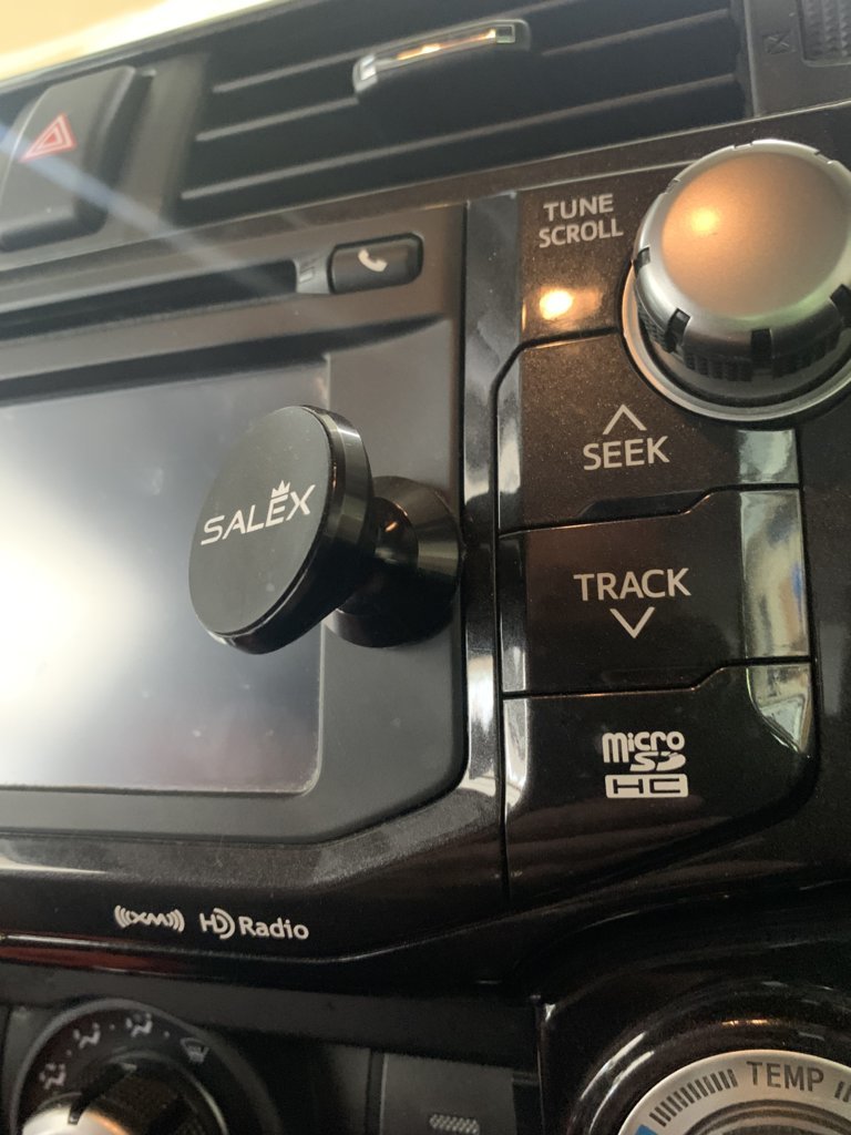

    SALEX Magnetic Phone Mount off Amazoné

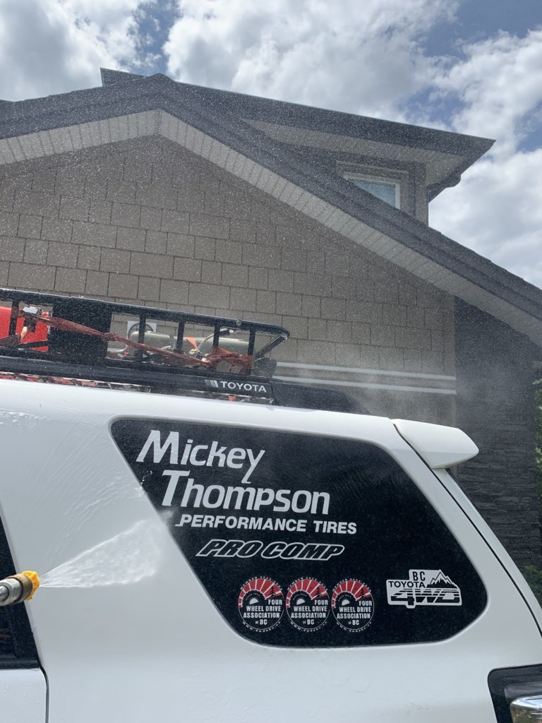

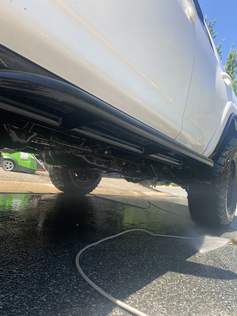

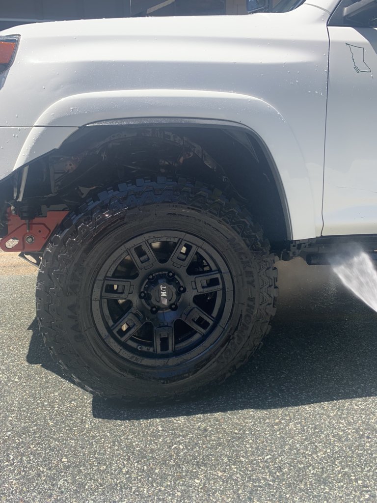

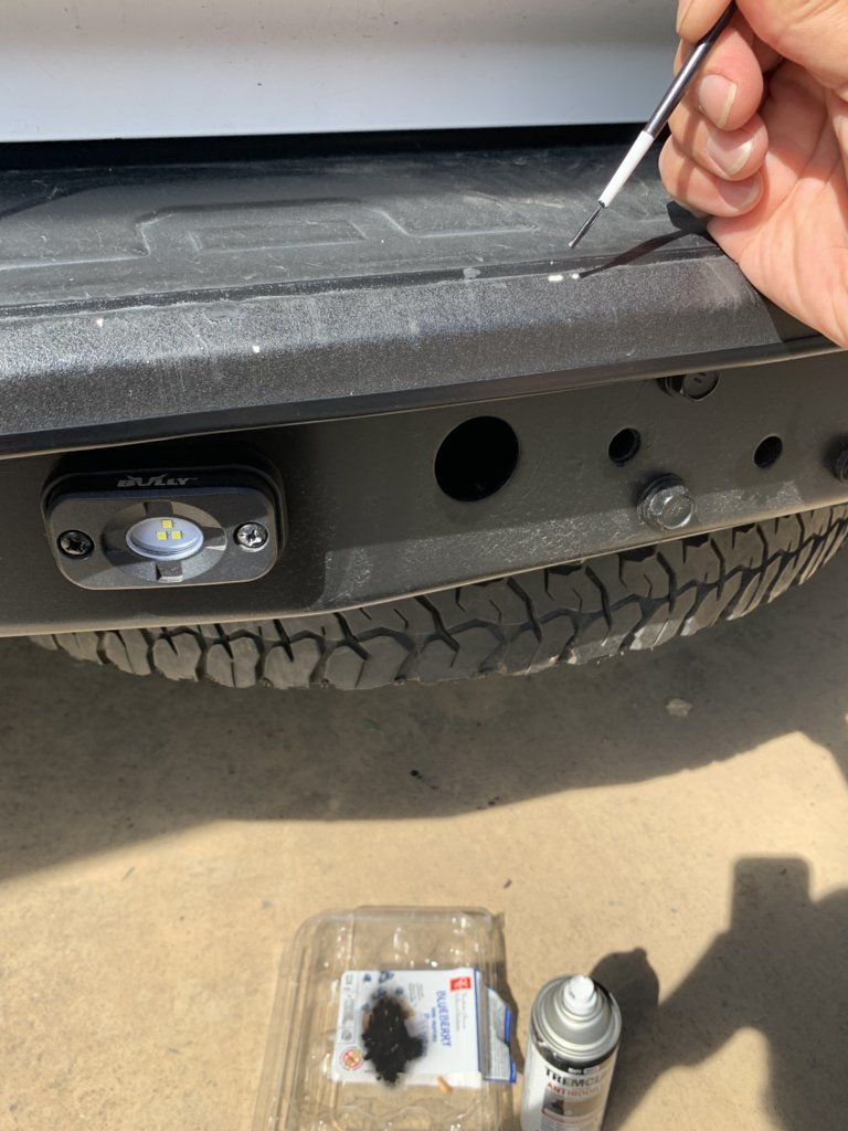

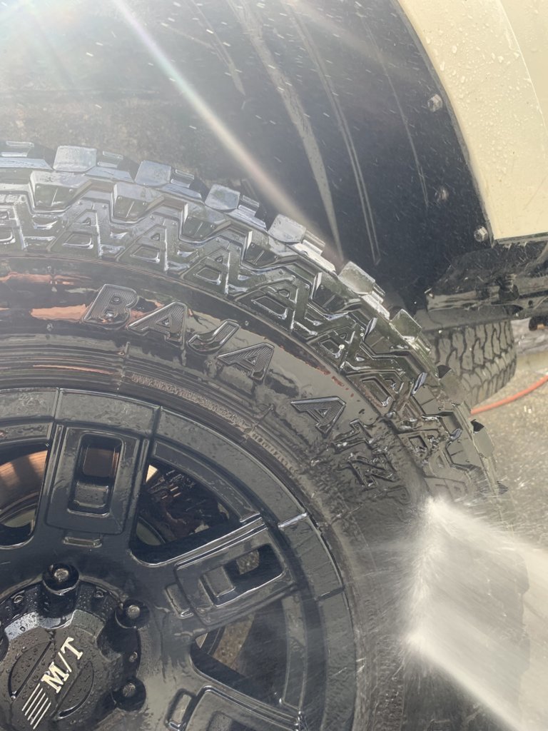

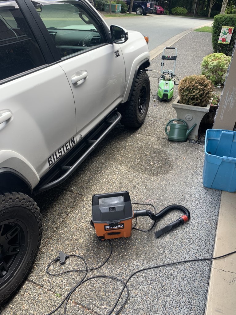

    Painting washing wiping vacuuming
    Rock chips repairs
    After:

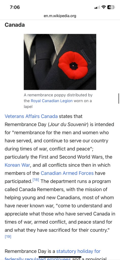

    [QUOTE="djwantke, post: 740430, member: 19487”]Poppies[/QUOTE]
    Poppies?

    installed poppy pins I had waiting in the garage, around memorial day
