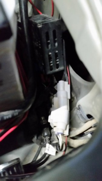

    I've seen the pix on Tacomaworld of which wire to remove from the harness connector. Since there is some differences between the years & models I didn't want to just try it. Is this the same as on a 2000 4R? Later on in that same thread, there was an idea of just pulling a wire from the heavy heatsink between the battery & fender under the hood. anyone have experience with either of these?

    I got bored today after work & decided to give the 2nd option above a try because it was the easiest of the 2 options. I verified that what worked on the 2000 model year Tacoma with the 3.4L 5VZ-FE also works on the 4Runner with the 3.4L 5VZ-FE in it.
    As described in the tacomaworld post, here is the caged heatsink & the grey connector:
    Disconnect it & DRL is disabled without disabling anything else. The headlight/foglight controllers on the steering column work as you'd expect as well as the high-beam indicator. Hopefully lifetimeledlights.com will still honor their warranty, this was my 4th pair with the low beams fried.

    Pretty simple mod. Glad it worked the same as on the taco.
    Fourth pair though... Damn :eek:

    When I installed my HIDs from retrofit...they stated I had to disable my DRL. Otherwise it would be very hard on the HID bulb...and could cause early failure. So, I did just as you did here...I too unplugged the connector. Piece of cake!! Now that you've disabled your DRL...I'm sure you'll quite eating LEDs.

    This is how I disconnected my DTRL's. I just unplugged this connector just like @Husky Driver did. Everything else continued to work as normal. The only thing that changes...is the DTRL's do not turn on! Your headlights come on as normal. They are not any brighter...or anything... they just work normally.
    Most guys want to disable their DTRL's because they have changed out the headlights one way or another. Either by installing HID's or a set of LED bulbs. If you've done either change...you have to turn the DTRL's power off otherwise that power will fry your new bulbs.
    So you really don't have "control" over the DTRL's...you just shut them off by disconnecting the plug...you permanently shut them off....the only way for them to come back on, you would have to re-connect that connector plug. Now if you are wanting to control the DTRL's and be able to turn them off and on from the driver's seat...you'd have to cut that plug off...run wires from the plug back into the cab and attach to a switch. I hope this help Sir.
