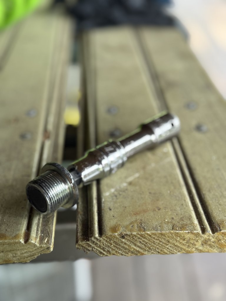

    when it broke free, the noise…IMG_7296.jpg IMG_7298.png…thought I broke my arm
    Side note: read somewhere bout a guy putting antiseize on the plug before reinstalling to avoid all this, different vehicle…I dunno, but I’m pretty sure that’s a realllllllly bad idea
