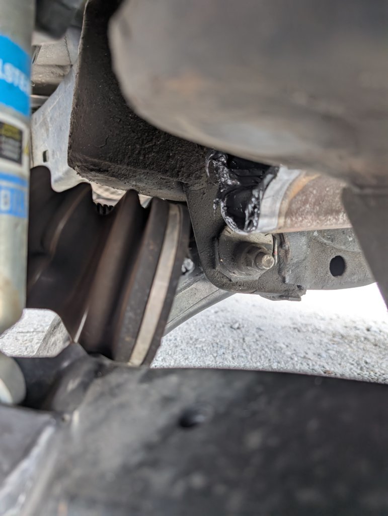

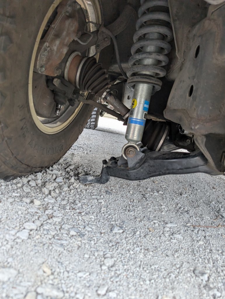

    Okay so update. I first was running premium gas and that solved the check engine for a bit. I just recently had time to switch injector 1 and 3 to see if it switches because my lower ball joint popped going into my driveway. So, I had to fix that first. I'll be driving it this weekend to see if it is the injector. My guess it is going to be the injector.

    Who installed that lower ball joint? That's not normally how they pop. Someone failed on the install.

    It was some shop where I live but the bolt on the ball joint just slipped off and stripped the threading somehow.
    I installed new lower controls arms, ball joints, and an axle.

    That sucks, there I good chance you ruined your CV axle (maybe not, nothing has to break for it to come out like that) and you can't get good new ones anymore.
    If a shop did install it I'd warranty their work, I wouldn't trust them to do it again, but you should get refunded because that's not something that happens without improper installation if you used quality parts.
