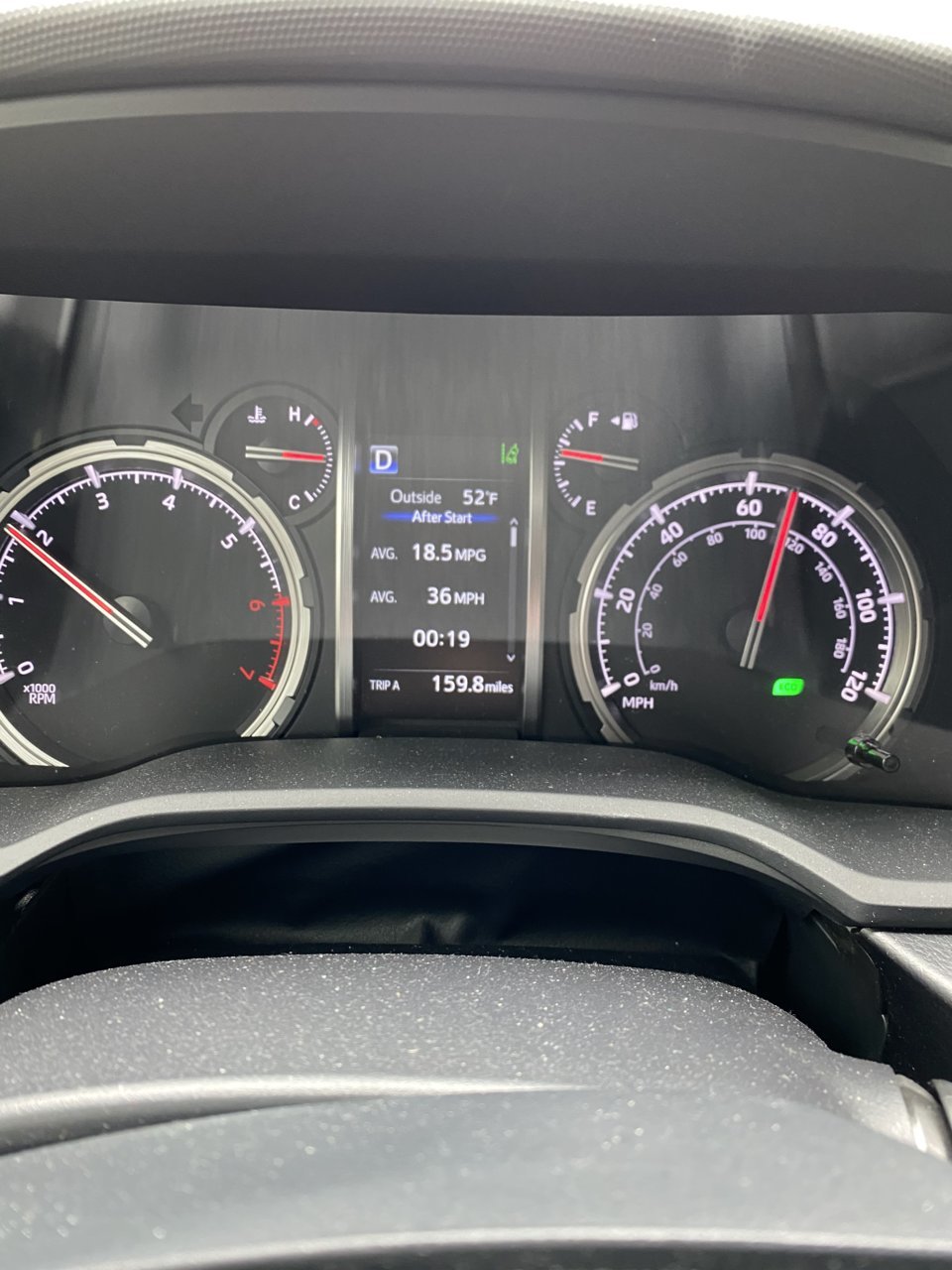

    Immediately after getting it swapped out today I noticed the road drag was gone, the road feedback was gone, and my mpg increased back to where it was before. I was averaging 17.7 on my tank to the shop, and then 20-30 miles after coming home it was 19.4. A huge difference all around.

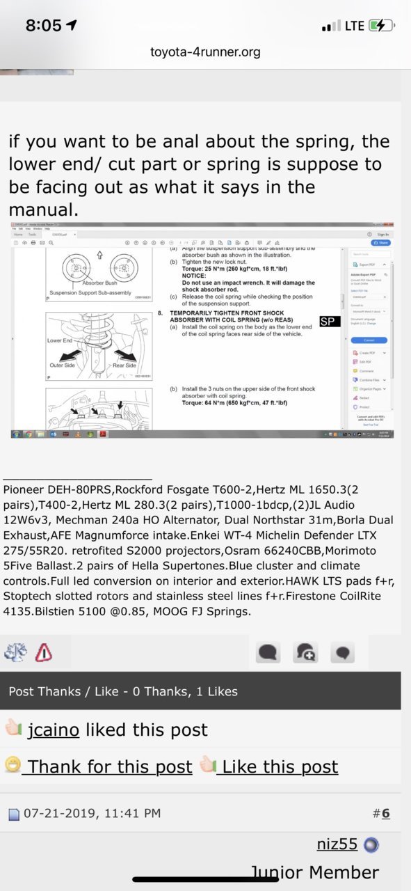

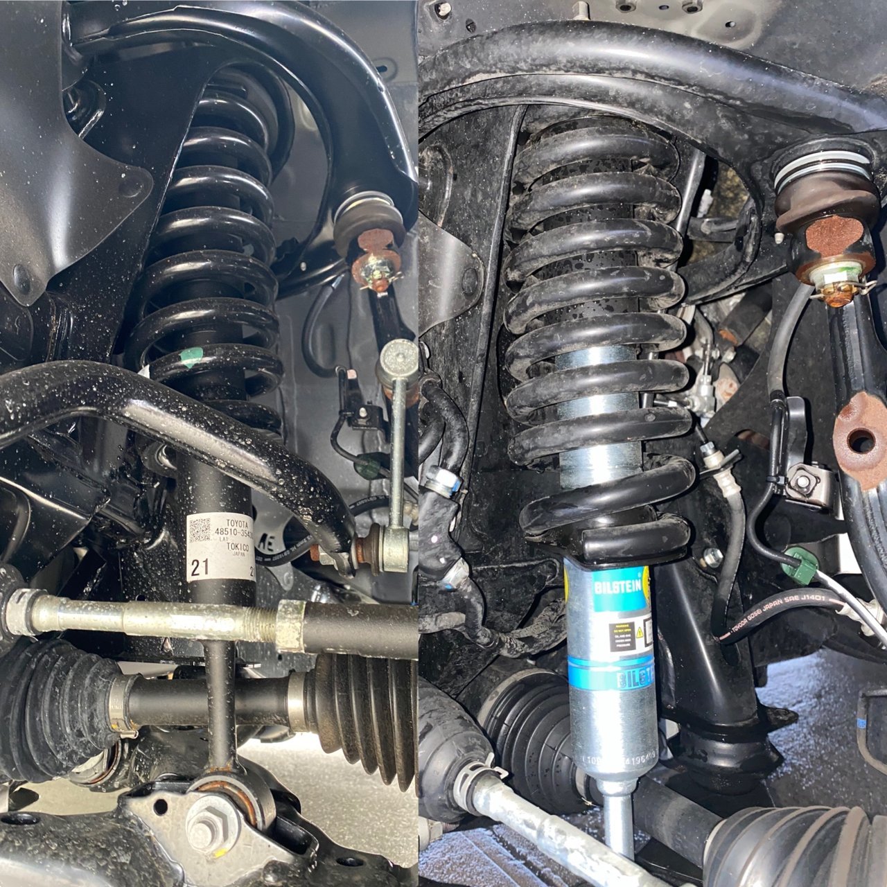

    Something to note potentially as a root cause is that the Bilstein center bolt is really long and I think that causes the 9 ring springs to be over compressed. It’s at least a quarter inch longer than the Tokico’s. See image below. Bilstein does not differentiate between 9 ring springs vs 8 ring springs or if there’s a stabilization system such as KDSS, and so as a one size fits all, we are subject to making every thing fit as one height on springs since there isn’t a left or right shock for the kit.
    However there is a right and left for the Tokico’s, which is indicated by the dots facing forward and is noted in the repair manual for installing the spring in the correct direction by making sure the pigtail exits toward the rear and outward. Also, the factory Tokico’s have a fixed seat so assure the direction, while on the Bilstein the seat can be turned to any direction allowing the rear of the spring and pigtail to end forward and facing inward.

    I’m not claiming they effected my mpg, however the three weeks I had them on, I experienced low mpg and on the way home from removing them it increased and has been back to normal since. Even on a new tank.
