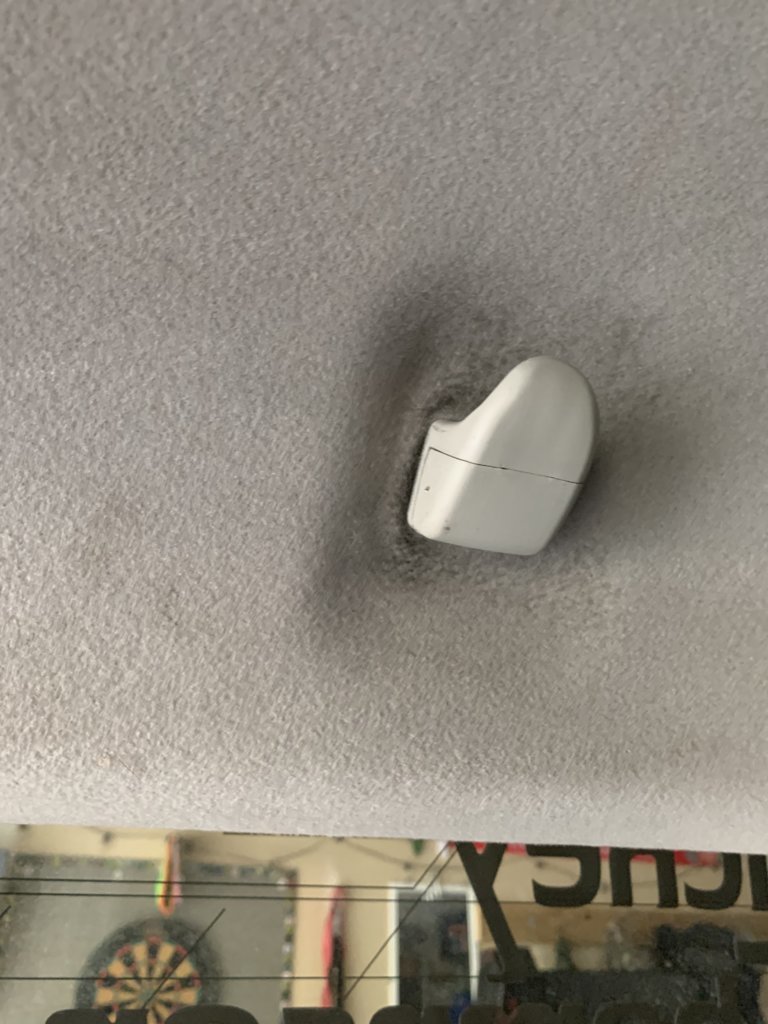

  10. May 12, 2025 at 9:18 AM
    4,980

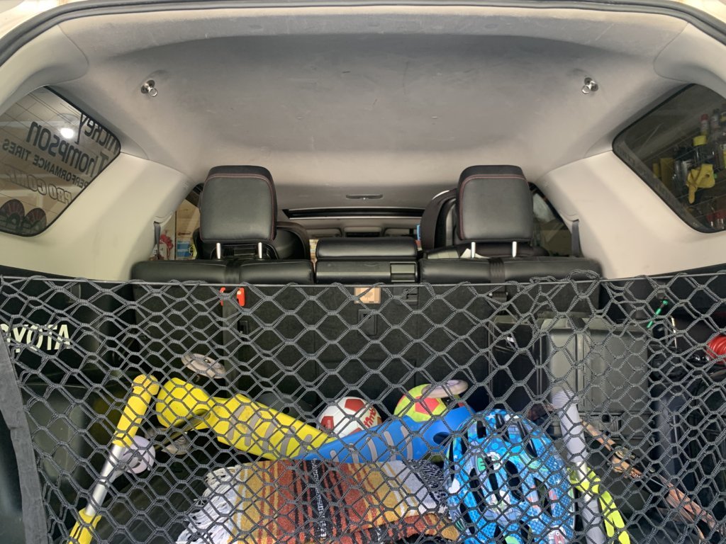

    Bought brand new 2016 After May 2021: -Approx 3" lift/level: Bilstein 5100's, OME 2884 590lb 3" front lift springs, SPC UCA's, ICON 158506 2" lift rear coils, diff drop -Mickey Thompson Baja ATZ LT285/70R17 Load E -Mickey Thompson Sidebiter ll 17x9, 0 offset, 5 backspace -Pro Comp black spline lugs ^installed by 4WheelParts^ -New brakes and rotors by brake shop -4-piece ARB skid kit -Smittybilt 2" nerf steps -MBRP black exhaust tip, chopped OEM -Drivers side OEM FJ oh shit handle -All blacked out emblems -Blacked out roof rails -4x WeatherTech window rain guards -OEM custom rear mud flap deletes -KICK BACK MUD FLAPS 12" WIDE - BLACK TOP AND BLACK WEIGHT -FRAM EXTRA GUARD CA10835 engine air filter -1797 LED tricolor fog bulbs Yellow 3000K White 6000K Blue 15000K 28W 4000LM -Armour paint lower rear bumper -Front bumper high stage high clearance cut -Fenders cut straight across, pink reservoir sprayed black -4Runner Lifestyle sequential fog fangs -4Runner Lifestyle smoked taillight decals -Pedal Commander -Rear passenger cargo mounted 120v truck tire pump -4x Spidertrax 1.25" black aluminum wheel spacers -Yota Twins Paracord Hatch Strap sand camo -Teton Workshop hard anodized matte black aluminum shift knob -Ditch flood lights 4 LED 20w 1400lm w/ OEM hood mounts on OEM style dash switch -Backup flood lights under bumper 6 LED 18w 1500lm on OEM style dash switch -Body Mount Chop; cut, weld, paint -Fender mount chop, re-weld, paint -Fender Liner cut behind wheel (I cut liner in front of wheel clean off at top of viper cut) -Wheel well firewall hammering, painting ^done by Arc One Industries^ -valance cap trim -Agency6 Black Shackle Block 2" US Certified 6061 T6 CNC machined aluminum -DRT fab universal hitch skid -ACDelco inner tie rods, outer tie rods, bellows -Full Dr. KDSS switch kit -March 31 Behind grille 13-1/4" 32 LED light bar + wide-angle, eagle-eye lens 6000lm on OEM style dash switch -RAA Powder coated steel roof rack cargo basket, 1" side rails, 64" x 39" x 6", 250lb limit -roof gas can, water can, shovel -PEAKTOW PTT0063 Hitch Mount Cargo Carrier 51-1/2 x 17-1/2 x 4 inches 500 lbs. Capacity (trips only) -July/2023: purchased first needed SPC balljoint replacement kit - newly released, upgraded non-zerk sealed joints 25002 -July 15/2023: The Original Universal EZ Flares, 1". All four corners -Dec. 2023: removed bumper cover and crash bar, drilled frame, installed Apex Overland KDSS Recovery Points -Jan. 2024: SPC balljoint replacement kit - upgraded non-zerk sealed joint design 25002 -Jan. 2024: custom installed 2lb fire extinguisher between drivers seat and door -Feb. 2024: swapped interior lighting to diode dynamics led’s -Feb. 3/ 2024: 4x KC Wire Hiders, for roof rack lighting -Feb. 13/2024: double ditch lights, on new Rago Fabrication Extension brackets. -3inch Quad Row Amber Pods from LED-Club. 32W 3200Lm 16-LED Spot Beam. Existing: 3inch EVERGEAR clear lens LED pods -May 2024: custom black aluminum grille mesh installed in front of factory plastic -June 2024: custom built powder coated dom sliders -Nov. 2024: thermo-plastic rear mudflaps -Dec. 2024: rear bumper cover clearance cut, sprayed newly exposed parts black -Jan. 2025: trailer hitch removal, relocation of rear led pods to crossmember New: -Exhaust pipe chop after axle -March 2025: new SPC upper control arms, bushings, balljoints. Raised front end 0.75” via Bilstein 5100 spring seat. -April 2025: Evergear bezel-less cube ditch lights 4 LEDs 40W 3.33A 4800Lm 328’ beam distance 30° 6000k beam angle shatter & crack resistant lens -April 2025: Evergear Ultra Series light bar 27-3/4” flood spot combo 60 LEDs 60W 5A 6000Lm 1227’ beam distance Dual row, dual beam angle 30°/60° April 2025: BULLY Rock Crawler Hi-Intensity LED Utility Lights, Pair 1260 lumens @ 15w (3 x 5w CREE) each 120° flood beam waterproof, dustproof. Under hood: -Blue Fire 6-Circuit Fuse Block w/ LED Indicator & Protection Cover -Blue Sea 100A Circuit Breaker w/ reset lever In progress/in the garage queue: ~ Wanted - 80% OFFROAD Hitch Replacement Recovery Point, PerryParts or Wheelers bump stops, 1" body lift, custom dom front bumper, winch, rear dom bumper with side hoops, kdss angle correction, C or D load 35’s, bolt on cat shields
    I think OP is implying hanging clothing in the rear cargo area on the insufficient hooks, not in the back seats where the handles are.
    I sometimes like to hang stuff at the back so my little kids can’t touch the clothes, or so passengers have space.
    I like @scottiezilla d-ring idear
    *I’m currently working on installing a new type of hook that holds hangars and such in place better. Not interested in molle back there or anything that spans across

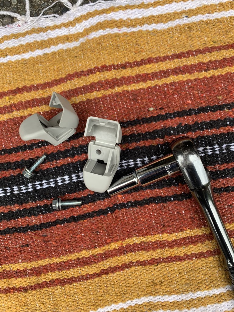

  12. May 12, 2025 at 4:36 PM
    4,980
    @Emmantik bro! thank-you
    oh what ur from Coquitlam, I’m from Maple Ridge.
    CHEERS

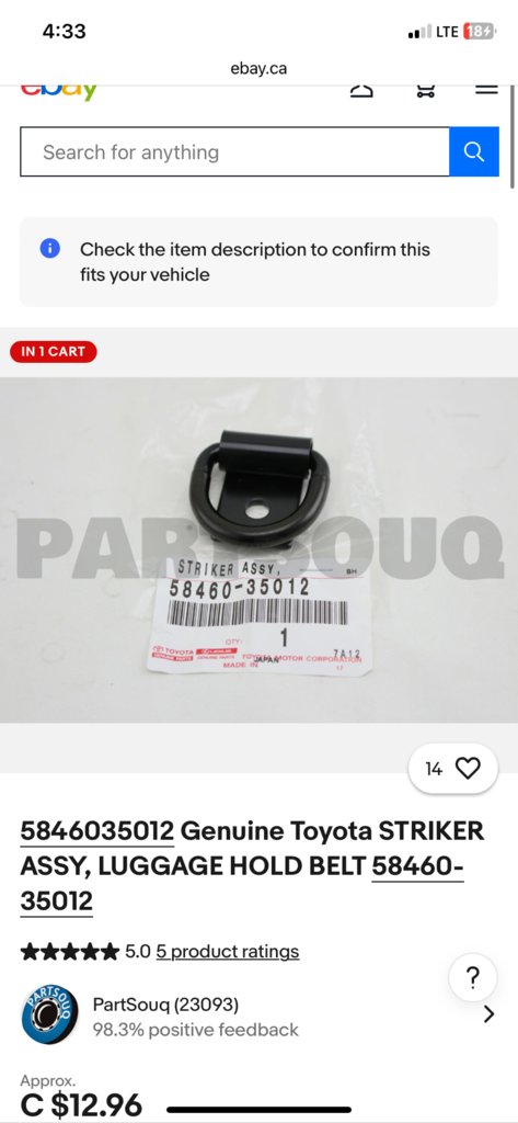

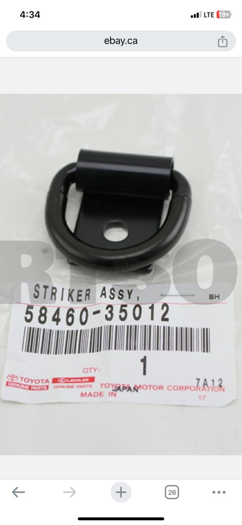

    This FJ d-ring is interesting
    scottiezilla likes this.
  13. May 12, 2025 at 4:39 PM
    scottiezilla
    scottiezilla New Member
    #19839
    645
    Oh snap the FJ d-ring
    there’s a mod that was used for, I think something more than just hanging clothes
    but it was all the rage over on T4R.org back in 17/18
    research time
    Saker and djwantke[QUOTED] like this.

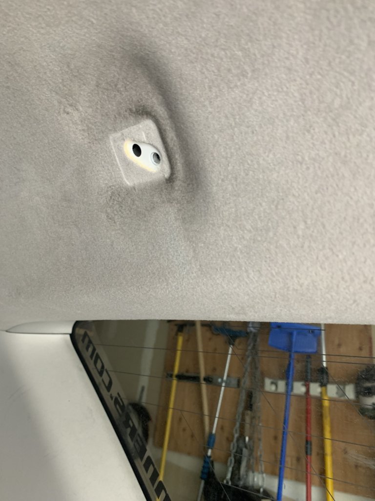

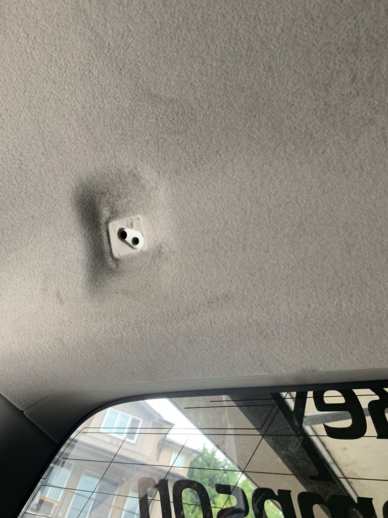

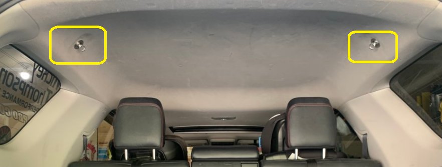

  17. May 18, 2025 at 5:20 PM
    4,980
  18. May 19, 2025 at 5:32 AM
    836
    How many clean, pressed shirts are you guys wanting to hang on that hook? Or are you hanging a big, heavy coat? Or something else?
    I've been designing a replacement to fit that location (not necessarily for the dry cleaning), and now I'm more curious what uses other people have in mind. Maybe that'll change my design somewhat, and perhaps I can prototype it and a) let you guys be guinea pigs, and b) help us all out a bit.

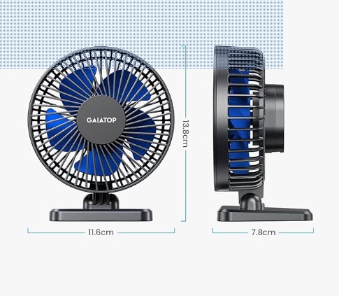

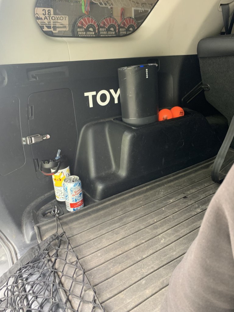

    If you are designing something i would make it as versatile as possible. I use mine to stick a light on, but it would be great if it could hold a heavy jacket or bag. A hook with a D ring would be sweet. Maybe it can take various attachments on top of just an improved hook? I would love to hang my small fan from it.
    vthoky[QUOTED] likes this.
  21. May 19, 2025 at 6:39 PM
    #51
    836
    What kind of light or fan are you thinking of hanging? Got pics or specs you can share?
    I have some ideas for a modular base, with easy-to-swap (or easy-to-adapt) features. Let’s chat! :^)
  22. May 22, 2025 at 6:12 AM
    #52
    Ripper238
    Ripper238 New Member
    #30792
    1,316
    2019 TRD OR
    I can mod the fan or make some kind of mounting solution, which i have.
    This is a great fan for air circulation, but many others have clamps. So maybe you can have something with surface area to clamp or double-sided tape to.
  23. May 22, 2025 at 8:42 AM
    #53
    836
    Thank you for the dimensioned diagram!
    I'll bang around on this design some more. What's that fan weigh, do you know?
  24. May 22, 2025 at 9:27 AM
    #54
    Ripper238
    #30792
    1,316
    2019 TRD OR
    It's not heavy at all, maybe 1/4lb?

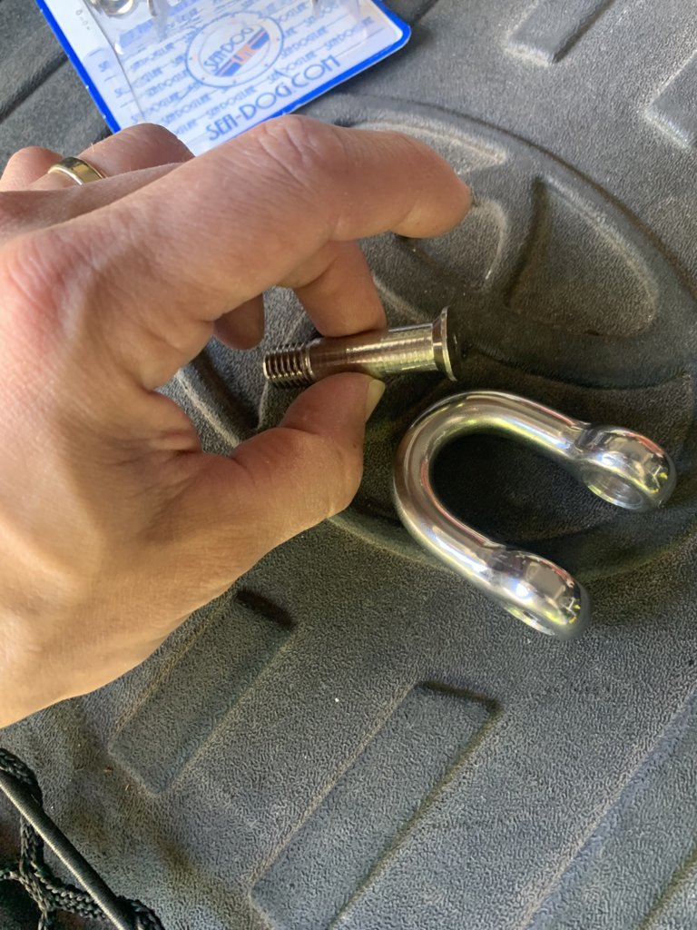

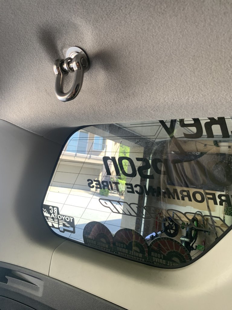

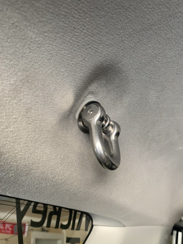

  25. May 25, 2025 at 1:13 AM
    #55
    4,980
    I did dis today
  26. May 25, 2025 at 8:46 AM
    #56
    7,533
    Heavy duty, for sure. Parts list/links? What did you use for these:
  27. May 25, 2025 at 1:32 PM
    #57
    2,654
    Those stainless shackles are sexy! For those who might want to try somthing similar, but not with identical hardware, can you tell us what the tread size of the threaded hole is? (Is it a threaded hole?)
  28. May 25, 2025 at 4:05 PM
    #58
    4,980
    Thanks dude, I agree the stainless is very nice. I’m test fitting non stainless hardware as well, and perhaps return the stainless to save a couple bucks, we’ll see.
    (I also want to attempt to install a shouldered eyelet w/ shackle while keep the factory hook installed…other option on the table is ordering black FJ ceiling d-rings)
    The threaded hole is standard M6! And there’s at least 2.5” of depth behind it, surprisingly.
  29. May 25, 2025 at 4:17 PM
    #59
    4,980
    Yea these are obviously heavy duty but I like the sizing. Almost any M6 fastener in the cargo area is overkill, google says M6 tensile strength starts at upwards of 1,100kg, some sources as high as 13-16k lbs. These shackles are rated above 20k lol)
    I bought 1/2” (inner diameter) stainless shouldered eyelets from brand: Sea-Dog, with a large stainless M6 fender washer + lock washer. Then 1/2” flush-pin stainless shackles from brand Cruiser Hardware.
    store: Steveston Marine & Hardware
  30. May 25, 2025 at 5:30 PM
    #60
    2,654
    I think that rating assumes that the threaded eyelets are through-bolted and backed up by similarly rated nuts. In your case the eyelets are threaded into mild steel, and that is the weak link.
