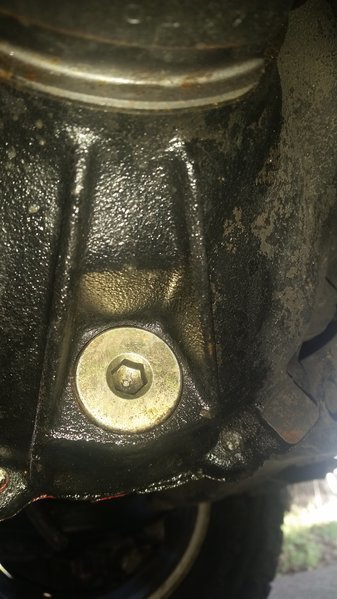

    Now, we will move on to the front differential. In order to access the drain and fill plugs, the skid plate will have to be removed.
    Once the skid plate has been removed, you will notice the fill plug on the front of the differential:
    The drain plug is below:
    These plugs require a 10MM or a 12MM hex to remove. Please confirm sizing, I needed to use a 10MM hex for both drain and fill plugs. Some have used a 10MM for the fill and 12MM for the drain.
    Remove the fill plug first (not pictured), then remove the drain plug.
    Removing the drain plug:
    Comparing the drill and fill plugs with the new set. Again, check for any abnormal shavings on the magnet of the drain plug.
    Once the front differential is fully drained plug the drain and proceed with filling:
    Again, the differential is full when you see a steady stream of differential oil flow out of the fill hole.
    Once the differential is full, set the fill plug:

    Great write up, I’d throw in a suggestion to upgrade the Lexus diff plugs, which will change your Hex plugs on the front diff to 12mm plugs you can get a socket on. Far less strip hassle
    part numbers: 90341-24016 & 90341-18060
