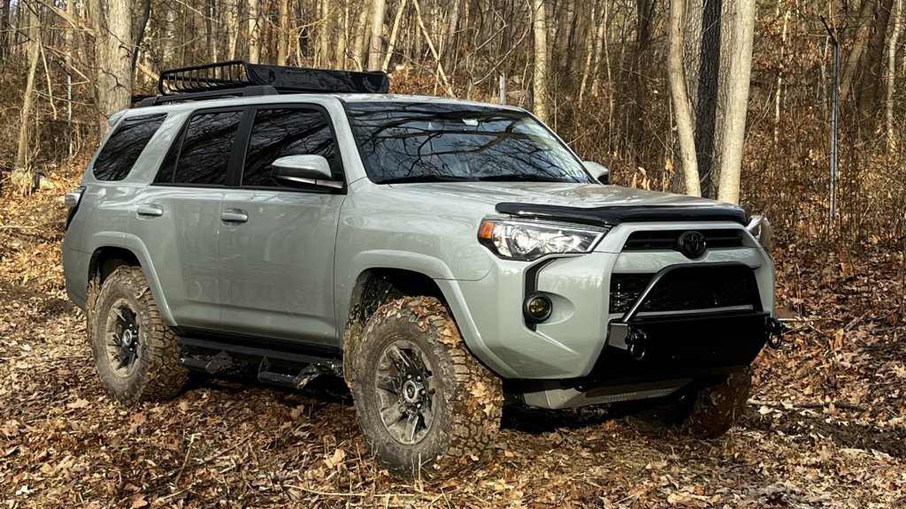

  3. Aug 12, 2025 at 4:21 PM
    4,969
    Bought brand new 2016 After May 2021: -Approx 3" lift/level: Bilstein 5100's, OME 2884 590lb 3" front lift springs, SPC UCA's, ICON 158506 2" lift rear coils, diff drop -Mickey Thompson Baja ATZ LT285/70R17 Load E -Mickey Thompson Sidebiter ll 17x9, 0 offset, 5 backspace -Pro Comp black spline lugs ^installed by 4WheelParts^ -New brakes and rotors by brake shop -4-piece ARB skid kit -Smittybilt 2" nerf steps -MBRP black exhaust tip, chopped OEM -Drivers side OEM FJ oh shit handle -All blacked out emblems -Blacked out roof rails -4x WeatherTech window rain guards -OEM custom rear mud flap deletes -KICK BACK MUD FLAPS 12" WIDE - BLACK TOP AND BLACK WEIGHT -FRAM EXTRA GUARD CA10835 engine air filter -1797 LED tricolor fog bulbs Yellow 3000K White 6000K Blue 15000K 28W 4000LM -Armour paint lower rear bumper -Front bumper high stage high clearance cut -Fenders cut straight across, pink reservoir sprayed black -4Runner Lifestyle sequential fog fangs -4Runner Lifestyle smoked taillight decals -Pedal Commander -Rear passenger cargo mounted 120v truck tire pump -4x Spidertrax 1.25" black aluminum wheel spacers -Yota Twins Paracord Hatch Strap sand camo -Teton Workshop hard anodized matte black aluminum shift knob -Ditch flood lights 4 LED 20w 1400lm w/ OEM hood mounts on OEM style dash switch -Backup flood lights under bumper 6 LED 18w 1500lm on OEM style dash switch -Body Mount Chop; cut, weld, paint -Fender mount chop, re-weld, paint -Fender Liner cut behind wheel (I cut liner in front of wheel clean off at top of viper cut) -Wheel well firewall hammering, painting ^done by Arc One Industries^ -valance cap trim -Agency6 Black Shackle Block 2" US Certified 6061 T6 CNC machined aluminum -DRT fab universal hitch skid -ACDelco inner tie rods, outer tie rods, bellows -Full Dr. KDSS switch kit -March 31 Behind grille 13-1/4" 32 LED light bar + wide-angle, eagle-eye lens 6000lm on OEM style dash switch -RAA Powder coated steel roof rack cargo basket, 1" side rails, 64" x 39" x 6", 250lb limit -roof gas can, water can, shovel -PEAKTOW PTT0063 Hitch Mount Cargo Carrier 51-1/2 x 17-1/2 x 4 inches 500 lbs. Capacity (trips only) -July/2023: purchased first needed SPC balljoint replacement kit - newly released, upgraded non-zerk sealed joints 25002 -July 15/2023: The Original Universal EZ Flares, 1". All four corners -Dec. 2023: removed bumper cover and crash bar, drilled frame, installed Apex Overland KDSS Recovery Points -Jan. 2024: SPC balljoint replacement kit - upgraded non-zerk sealed joint design 25002 -Jan. 2024: custom installed 2lb fire extinguisher between drivers seat and door -Feb. 2024: swapped interior lighting to diode dynamics led’s -Feb. 3/ 2024: 4x KC Wire Hiders, for roof rack lighting -Feb. 13/2024: double ditch lights, on new Rago Fabrication Extension brackets. -3inch Quad Row Amber Pods from LED-Club. 32W 3200Lm 16-LED Spot Beam. Existing: 3inch EVERGEAR clear lens LED pods -May 2024: custom black aluminum grille mesh installed in front of factory plastic -June 2024: custom built powder coated dom sliders -Nov. 2024: thermo-plastic rear mudflaps -Dec. 2024: rear bumper cover clearance cut, sprayed newly exposed parts black -Jan. 2025: trailer hitch removal, relocation of rear led pods to crossmember New: -Exhaust pipe chop after axle -March 2025: new SPC upper control arms, bushings, balljoints. Raised front end 0.75” via Bilstein 5100 spring seat. -April 2025: Evergear bezel-less cube ditch lights 4 LEDs 40W 3.33A 4800Lm 328’ beam distance 30° 6000k beam angle shatter & crack resistant lens -April 2025: Evergear Ultra Series light bar 27-3/4” flood spot combo 60 LEDs 60W 5A 6000Lm 1227’ beam distance Dual row, dual beam angle 30°/60° April 2025: BULLY Rock Crawler Hi-Intensity LED Utility Lights, Pair 1260 lumens @ 15w (3 x 5w CREE) each 120° flood beam waterproof, dustproof. Under hood: -Blue Fire 6-Circuit Fuse Block w/ LED Indicator & Protection Cover -Blue Sea 100A Circuit Breaker w/ reset lever In progress/in the garage queue: ~ Wanted - 80% OFFROAD Hitch Replacement Recovery Point, PerryParts or Wheelers bump stops, 1" body lift, custom dom front bumper, winch, rear dom bumper with side hoops, kdss angle correction, C or D load 35’s, bolt on cat shields
    @Hashkaash ur good man ignore noise in the comments, wise as it may be. Ur already at 3.5” on fat 33’s w/ spacers. Just bend the fender mount flanges over everyone does it, and get ur shop buddy to help you confirm body mount contact.
    can you please tell us what exact wheel spec and what exact tire spec your running?
    do you have a suspension lift or spacer lift or combination of the two

    Lol, im not worried at all about their comments. Im running the stock TRD wheels, 17x7 +15mm
    33x12.50R17 Tires
    3.5 Adjusted lift with 2 inch wheel spacers
    Just suspension loft

    Those 2" spacers are not helping your situation at all. Take them off and see what happens. May not solve the rubbing completely, but it will be noticeably reduced.

    Ya exactly, 2” spacers are big and could even make 265’s rub.. 12.5” fat 33’s are more rare on 5th gens, could rub under compression with those alone as well

    Oh yeah for sure. Definitely worth a shot to try and fit though. They're only going to get bigger from here so. Ill see how they go without the spacers. Im gonna get a Body chop tomorrow anyway so we will see what happens. I plan on getting either -33 or -56 offset wheels so the spacers will test it out

    I had awful rub. Maxed out caster to push wheels as far forward as possible while still having 0 camber angle and it solved rubbing. Had to reshape and reposition plastic liner in front of tire a little but that was easy.

    youre trying to fix a problem (spacers) by changing a whole bunch of stuff. Ditch the spacers and you wont have to do 99% of the stuff you mentioned above.
    mine is a 2” lift with 285/70/17 on factory trail special rims. No trim, no body cuts or hammering, i have all mudflaps in place and no rubbing at full lock.

    Yeah, it’s hard to get rid of the spacers if the whole point is the massive poke look. It’s not my personal taste, but I can respect the idea of wanting a certain look (or stance, as the youts say these days).
    The only thing that made me raise a spock eyebrow is the 3.5 in of lift. That doesn’t leave much down travel if you’re off roading, especially in front. The increased rear pinion and U-joint angles might also result in early failure.
    One interesting thing I recently learned regarding negative offset was that besides the impact on wheel bearings and steering, the upper ball joints and the UCA long-bolt (and shock tower) will experience large increases in lateral forces. The spindle will be transmitting these side forces, which will also means it’s much easier to bend it as well. Just mentioning this because the OP seems like he does off-roading, so it’s probably good to be a gentle with things as possible and avoid “full-send” while off road.
    Eta: if you’re not 100 percent sure you want the massive offset Hawaiian look, then don’t do it. It’s probably a bigger financial and maintainance commitment than most mods you can do if you off-road. And it’s probably fair to say that massive poke will make it vulnerable to breakage off-road. You might get away without breaking things if your 4runner is only used on the street. But even so, hitting some potholes can be worse than anything you experience off road, which can still lead to the same bent spindles, bent long bolts, cracked shock tower brackets, broken ball joints, or power steering failures.

    Fine fine. I will take the spacers off until I can get more reinforced underparts

    @Hashkaash - my friend I totally get it. We all do. We’ve been you. First there’s a vision. It sticks in your head. You can’t shake it. You picture yourself driving along in this behemoth that you’ve created. You're so enamored with the vision that you’ll do whatever it takes, no matter the cost in blood and treasure, to see that vision realized. And by sheer will and determination you make it happen. And ther you are. Behind the wheel of your vision. Feeling mighty, filled with a sense of pride and accomplishment at having caught the white whale. But soon the glory begins to fade. The impracticalities begin to rear their ugly heads. And soon, much sooner than you might have suspected, you start to feel like Dr. Frankenstein, regretting having created the monster.
    I would never presume to tell you not to follow your dream. By all means, follow it with gusto. And when you’ve had your fun, when you see your Frankenstein’s monster as a failure rather than a success, take solace in knowing that good judgment comes from experience, and experience comes from bad judgment. And now you have acquired good judgment.
