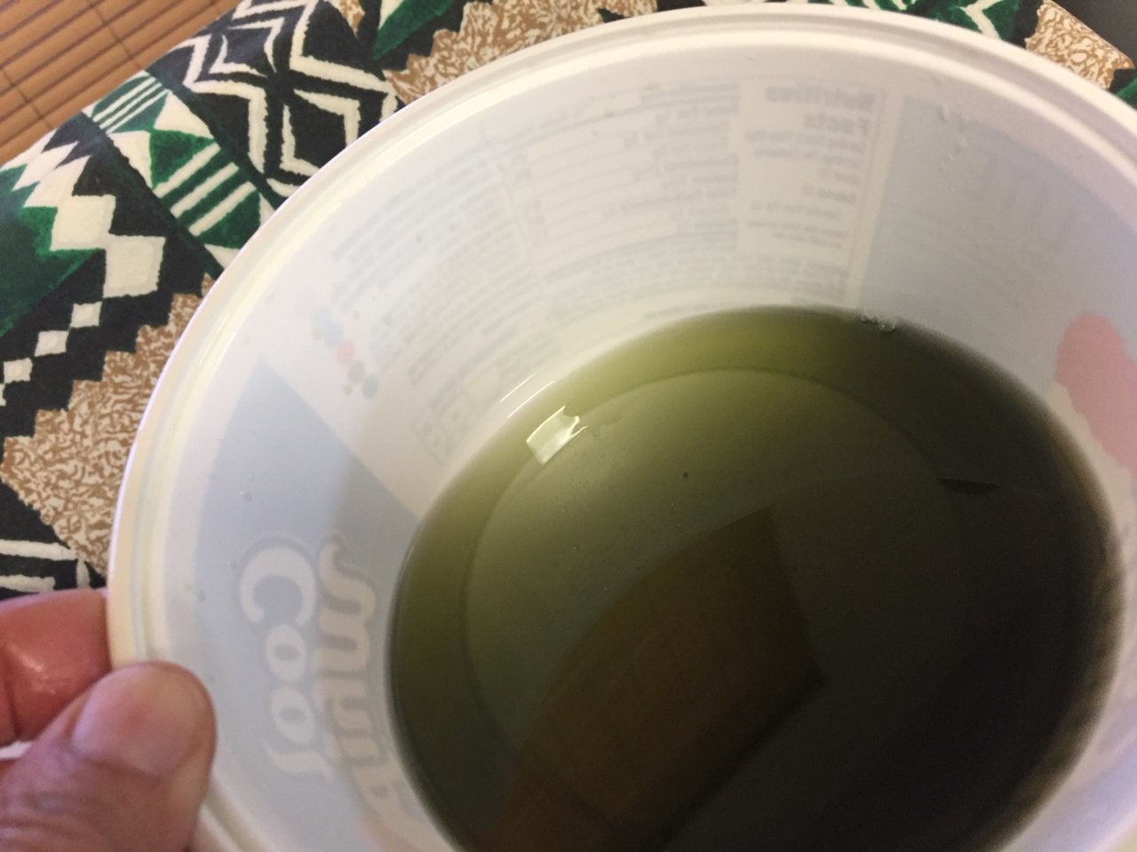

    That's what the mechanics have been telling me, I have to replace the ASB and Master Cylinder, for $4k; however, ever since we removed some of the brake fluid and brought the level to below the "max" line in the reservoir, there is no leak. I'm thinking the previous owner topped off all fluids before I bought her (in September), without realizing the 3rd gens need to have the brakes pumped (while engine is off) approx 40 times before topping it off. I'm hoping I just saved myself $4k, but time will tell. So far brakes seem good and no leaks. Here's a pic of some of the brake fluid we removed;

    SlvrSlug
    SlvrSlug Slightly bent.
    Jun 3, 2018
    #6172
    7,875
    Ramona Ca.
    That does not look good at all, have you flushed it out?
  14. Dec 30, 2019 at 6:04 PM
    AlohaSylvia
    AlohaSylvia [OP] New Member
    Oct 6, 2019
    #11564
    15
    2” Lift
    No, that was next on the list to do, wanted to monitor the leak for a few more days first.

  15. Dec 31, 2019 at 5:31 AM
    NightOwl
    NightOwl 1985 Toyota 4 Runner DLX 22REC
    Aug 29, 2019
    #11070
    179
    Amos
    Ballwin, MO
    LCE header, 2.5 inch exhaust, 31x 10.50 BF Goodrich, 15 X 8 aluminum wheels, Bilstein Shocks, 3 inch lift kit, 3M fender flares
    Yep...Your right...that is..or looks like greenish brake fluid??? I would flush it like the other guys suggest and put Toyota brake fluid in and see how it goes. Sorry I was no help what so ever. These post are awesome but it's kind of like being a doctor and trying to diagnose from an e-mail...I'll be much more careful in my future posts as to not waste others time...Happy New Year!!!
