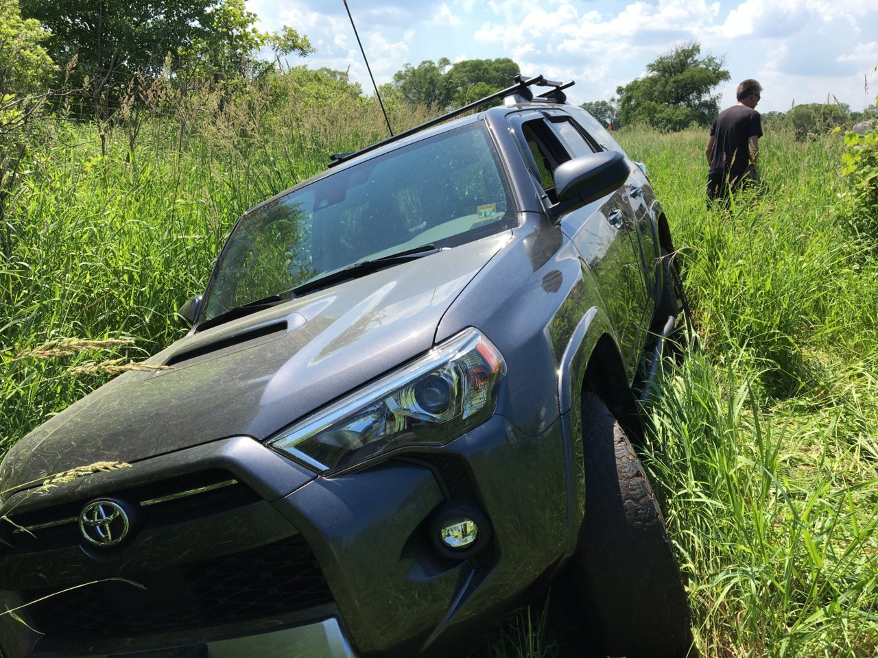

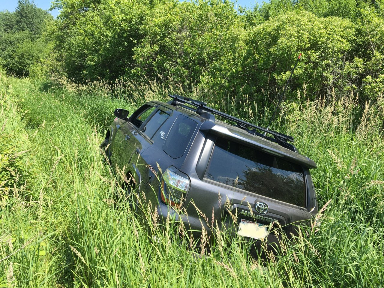

    Here are historical action shots from when the lumber helped save my 4runner lol (the dark boards on the passenger ramp are the ones completely buried at the bottom of the last picture).
