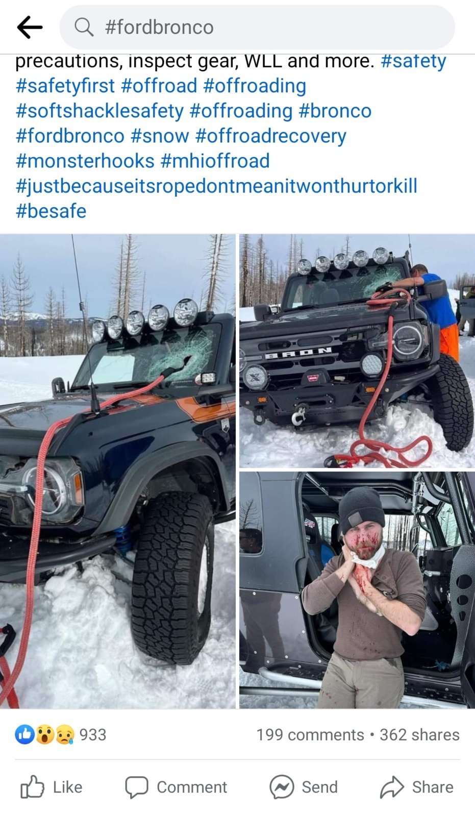

    There was another recovery incident recently. Some blaming a generic soft shackle, one comment blamed the recovery vehicle for pulling too hard/fast.
    Either way, a good reminder to be careful, and don't try to cheap out on recovery gear.
    Also, another reminder that kinetic ropes can be extremely dangerous. I personally consider them a last resort at this point.

  3. Mar 3, 2024 at 6:30 AM

    I watched from beginning to end, and his conclusions seemed right to me. His takeaways were:
    1. He didn't spend enough time assessing the situation.
    2. He should have dug the buried wheel. This can't be emphasized enough. (My observation: a lot of the recovery disasters posted online stem from people not understanding how big an obstacle they're trying to overcome.)
    3. The kinetic pulls were way too hard.
    4. The soft shackle was mounted to a clevis
    5. The soft shackle was of unknown quality. However, he did note the frame damage which indicated that it survived an incredible amount of force.
    Getting back to the winch question, I suspect that given his frame damage, a winch may not have had enough power to get him clear of the obstacle as it was situated, especially if the pulling vehicle was on an icy surface. That part in italics is critical, though. It may have worked if he had dug out first. I've always felt like I'm not done digging until there's nothing diggable left in front of any tires.

    It wasn't a winch cable. It is not customary or effective to put a winch damper on kinetic rope pulls.
    Copying from the TW discussion thread:
    Don’t go ham yanking on a kinetic rope
    Don’t use a soft shackle through a recovery point that isn’t designed for them
    Don’t use cheap soft shackles
    Use appropriately sized kinetic rope that'll stretch as intended. The pull had a harder impact on both vehicles because the 1" rope was too stiff, acting more like a tow strap.
