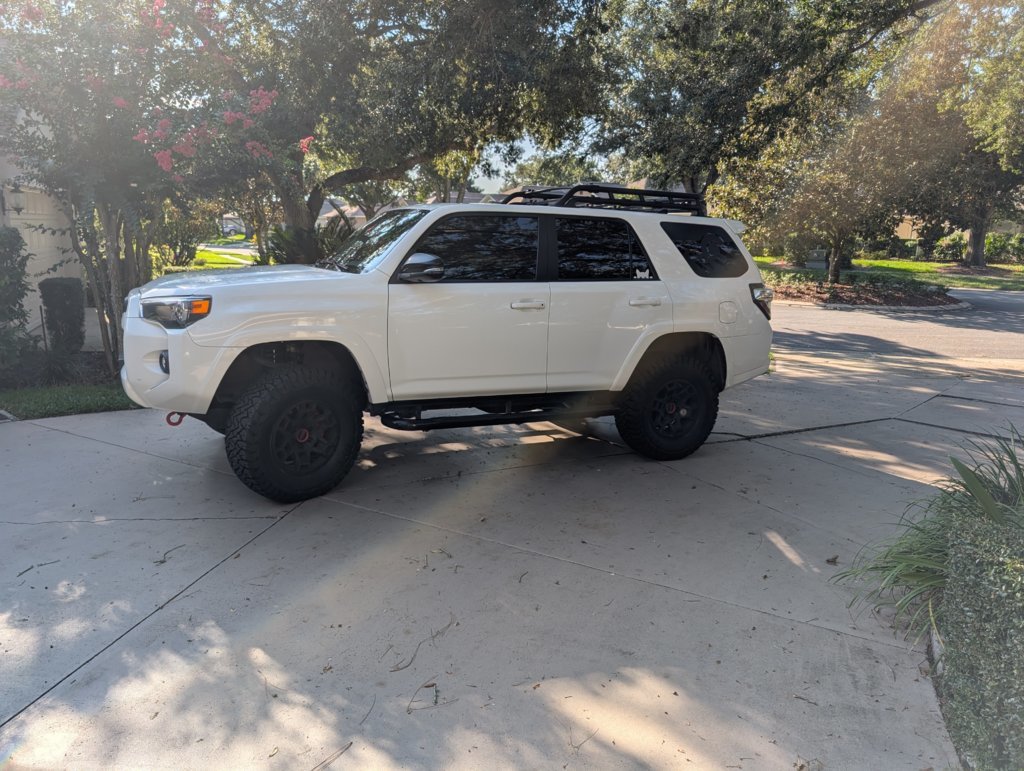

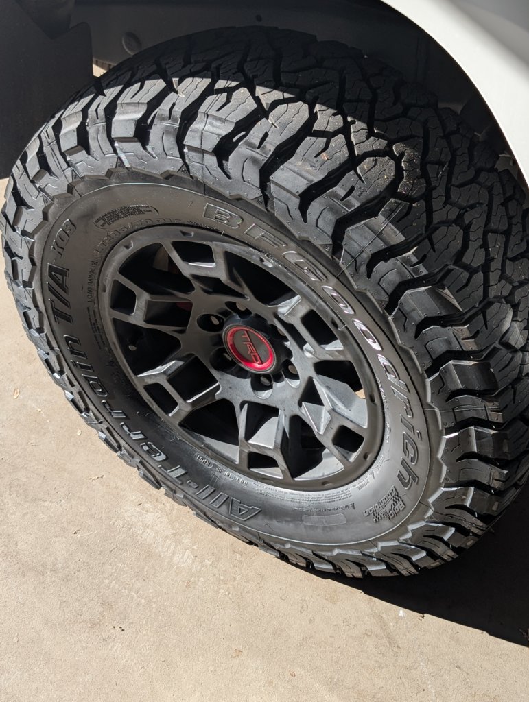

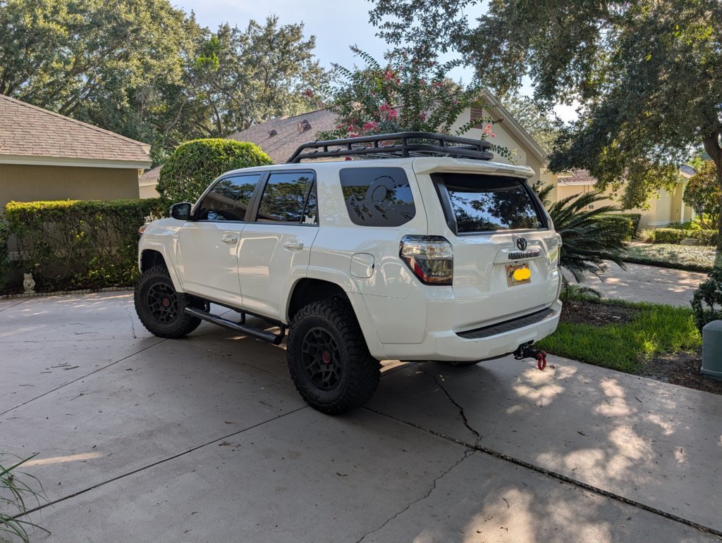

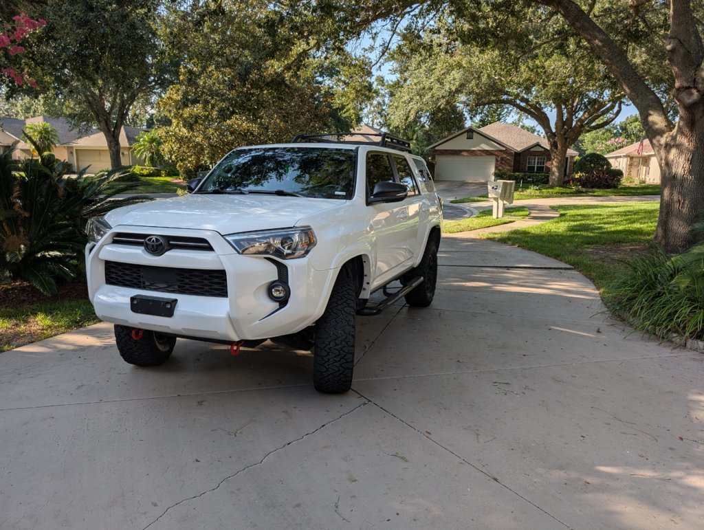

    #82
    Kat5280
    Kat5280 [OP] New Member
    Aug 5, 2024
    #42023
    21
    Kat
    Florida
    2022 SR5 Premium 4x4
    3" lift, deleted mud flaps, skid plate
    Finally took some pics....and with the new tires. I ended up going with BFG All Terrain T/A 285's. They rub a tiny bit, but I'm going to trim the plastic to accommodate. side.jpg front.jpg back.jpg tire.jpg
    nimby, RusPro17, Saker and 4 others like this.
