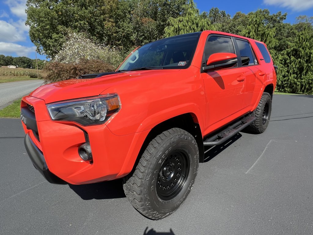

    They are the SL load. I do not need a E rated tire. You can feel the difference in weight. I know from doing them in the past.

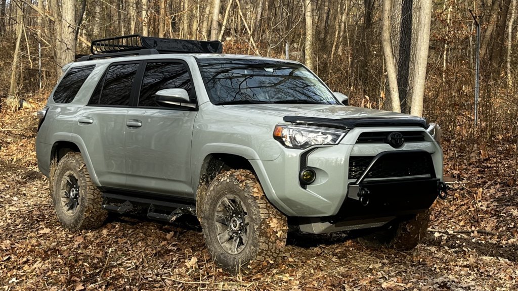

    thats why I chose no more than 2” on all 3 of my rigs. Kept is simple and no cutting or chopping.
