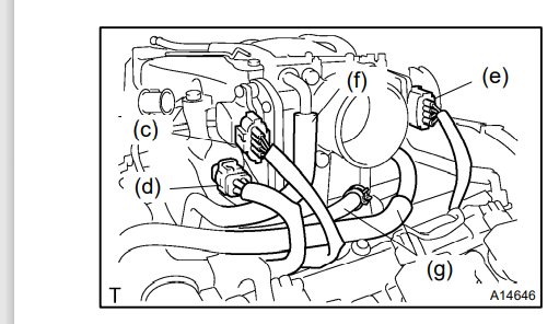

    While I'm triple checking the vacuum line routing I'm looking at the water bypass lines. Does anyone have a picture to where they go out of the throttle body? I don't think they're wrong or causing the issue but I just want to be certain. This was the best diagram I found that only shows the throttle body side.
  23. May 20, 2021 at 4:11 PM
    Ahdofu
    Ahdofu New Member
    Dec 14, 2020
    #18506
    312
    Matt
    1997 4Runner SR5, V6, Auto, 4WD
    Must be from the same file. I see this one as well.
